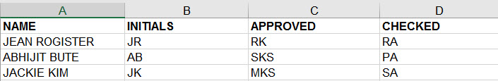

Create New (Database) Excel Sheet Add Data.
  1. Create new excel file (say User.xlsx) and entry as per below screen shot.
  2. Save file in appropriate location.

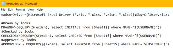

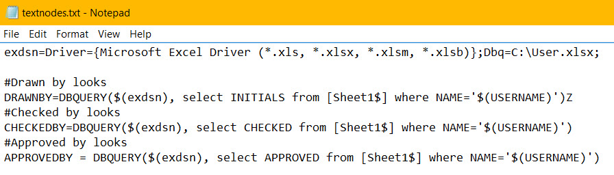

Edit Textnode.txt file
  1. Add new database entry in textnodes.txt file.
    exdsn=Driver={Microsoft Excel Driver (*.xls)};Dbq=C:\User.xlsx;
  2. Add following query to get DRAWNBY, CHEKEDBY,APPROVEDBY values from database.
    DRAWNBY=DBQUERY($(exdsn), select INITIALS from [Sheet1$] where NAME='$(USERNAME)')Z
    CHECKEDBY=DBQUERY($(exdsn), select CHECKED from [Sheet1$] where NAME='$(USERNAME)')
    APPROVEDBY = DBQUERY($(exdsn), select APPROVED from [Sheet1$] where NAME='$(USERNAME)')
    Refer below image
  3. Save textnodes.txt file.

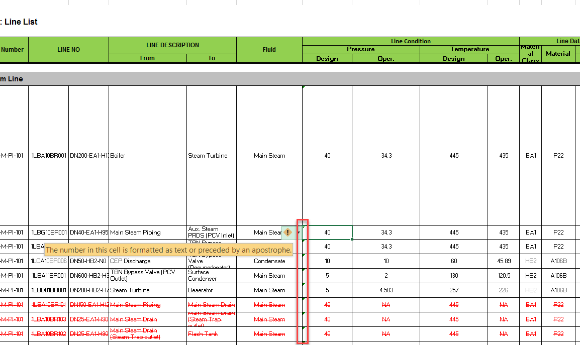

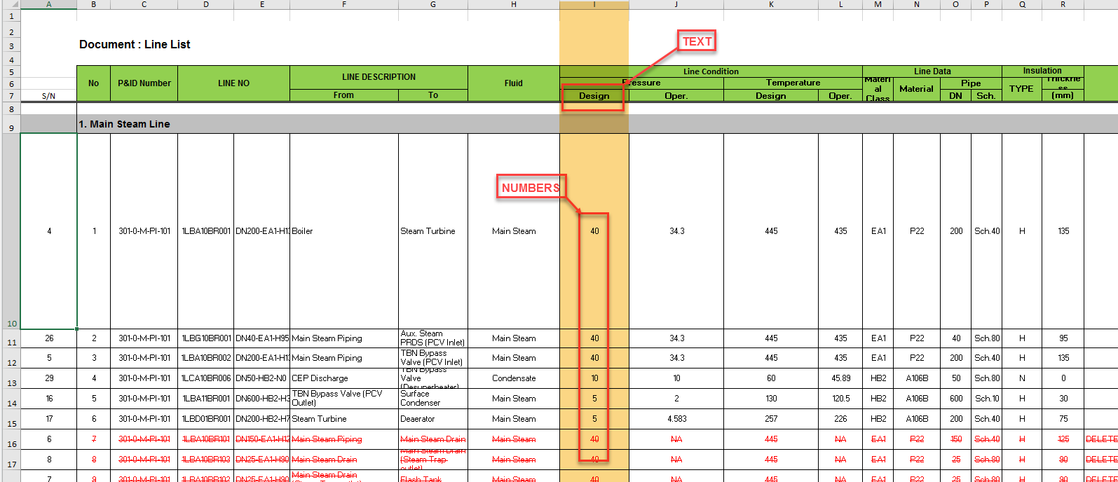

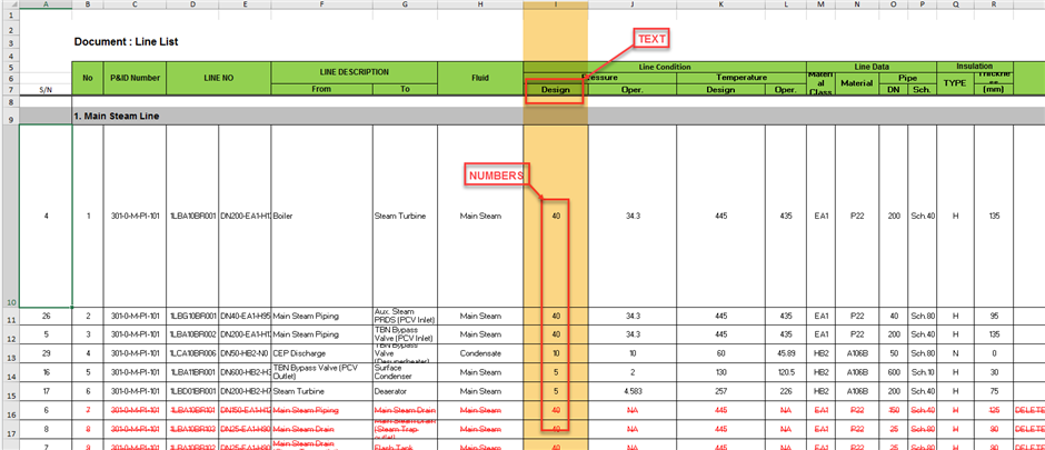

NOTE: In case the column queried from the Excel sheet contains different data types like texts as well as numbers
Convert all the numbers to text format.

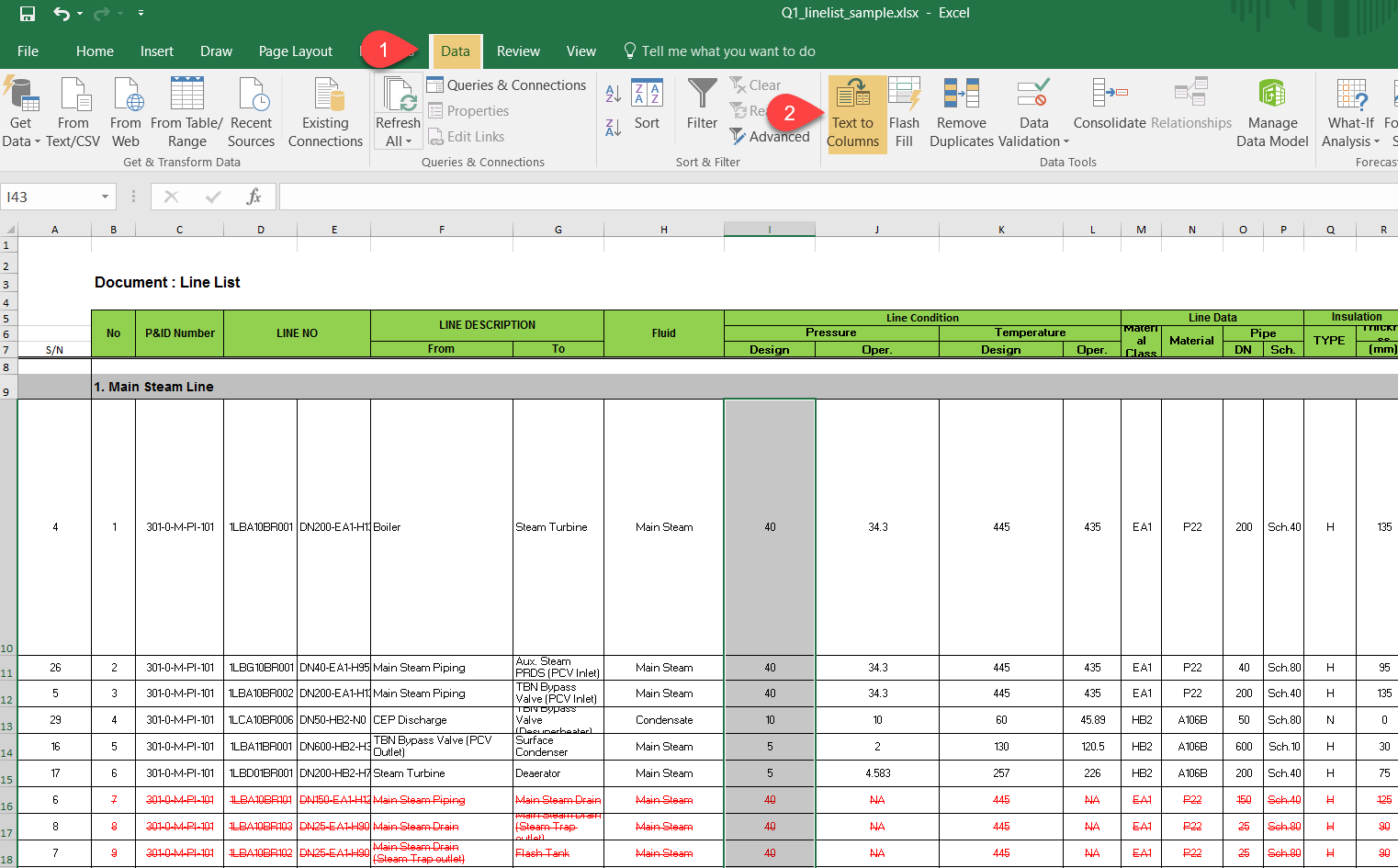

Steps To Accomplish:

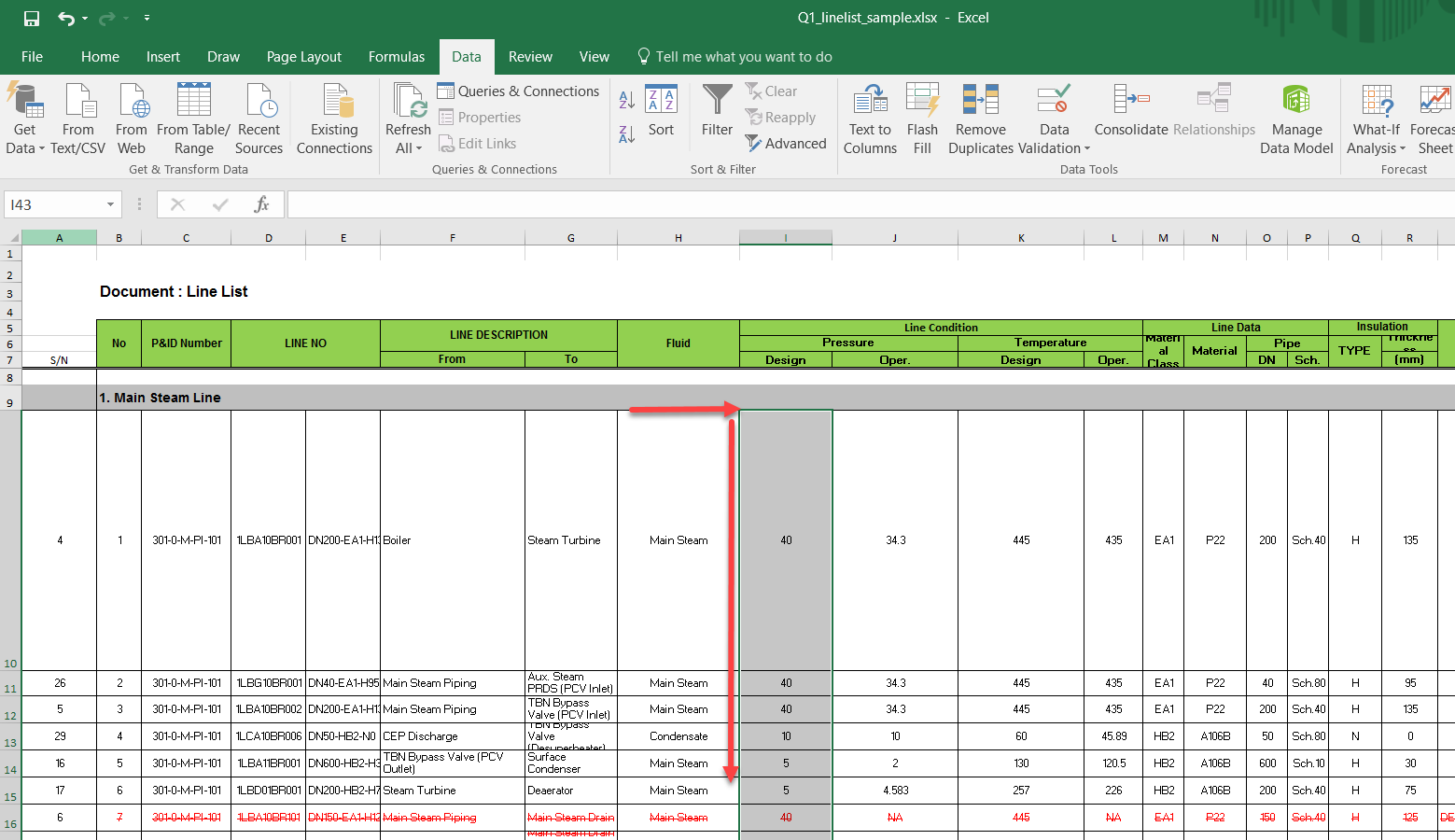

  1. Select the column as shown leaving the merged cells

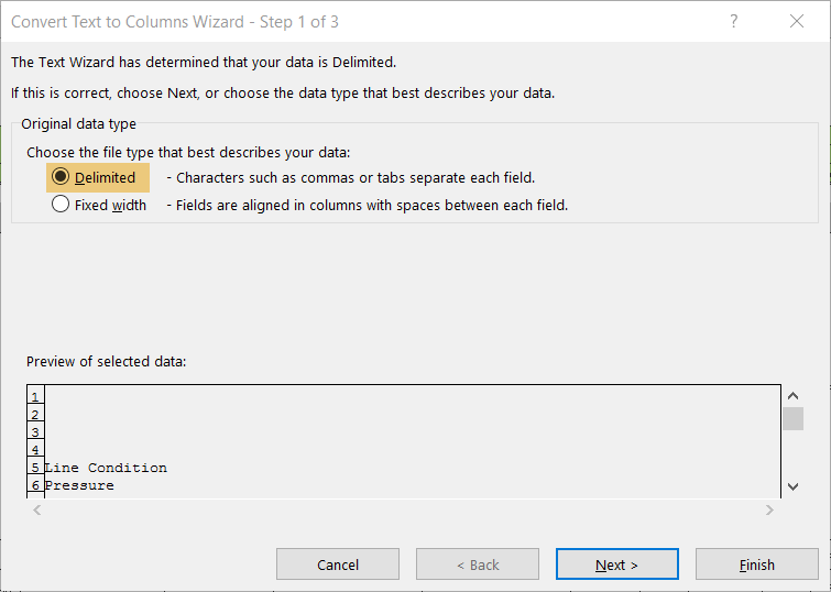

  2. Go to Data --> Text to Columns
  3. Select Delimited

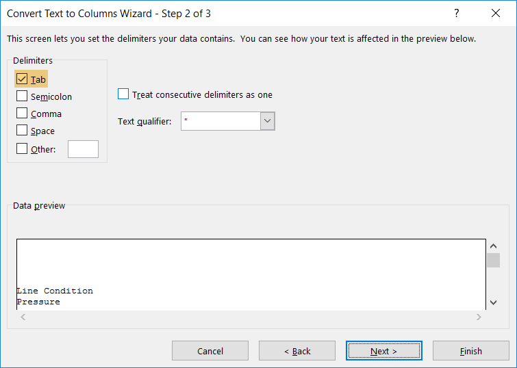

  4. Select Tab

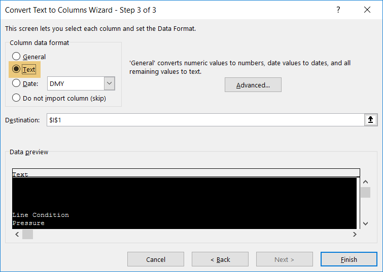

  5. Select Text
  6. Click Finish.
  7. Ensure all the fields with just numbers show up as text now.
