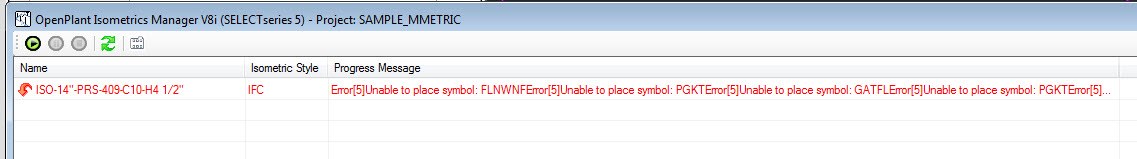

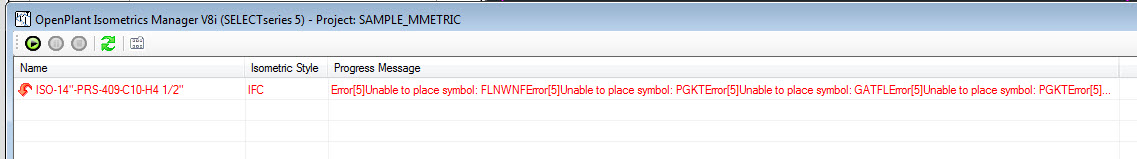

In OpenPlant Isometrics Manager, while use custom seed file (backing sheet) user may face below error.
Error[5] Unable to Place symbol: FLNWN Error[5] Unable to Place symbol: PGKT Error[5] Unable to Place symbol: GATFL... when use custom seed file (backing sheet).
Problem Description

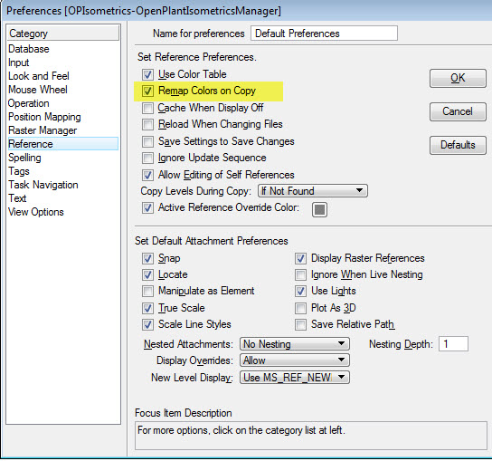

In OpenPlant Isometrics Manager, when use custom seed file. User get above error one of reason is attached color table with customized seed file. Below illustrative steps will help you to resolve this issue by changing colour table to OPIM default color table.
Steps to Resolve
  1. Open Isometric Configuration Manager dialog.
  2. Open seed file.
  3. Go to Workspace>Preferences>References>Remap Colors on Copy setting
  4. Uncheck above highlighted option.
  5. Go file> Save Settings (CTRL+F).
  6. Generate isometrics & verify result.
