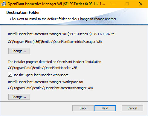

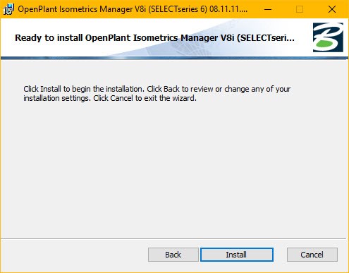

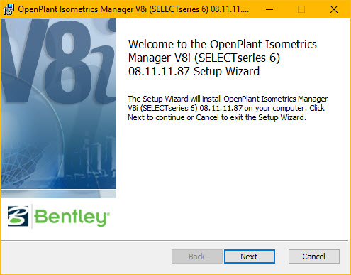

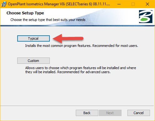

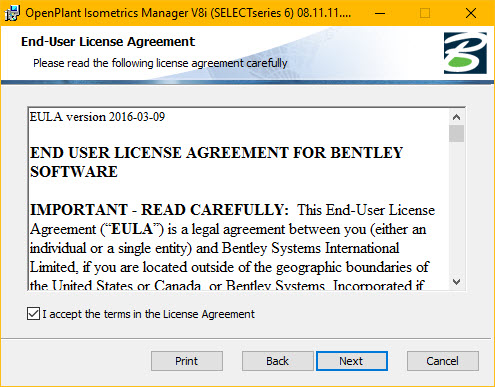

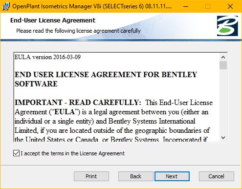

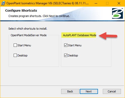

During OpenPlant Isometrics Manager installation procedure user need to select the correct options. Following are the steps of installation for AutoPLANT Modeler - OpenPlant Isometrics Manager.

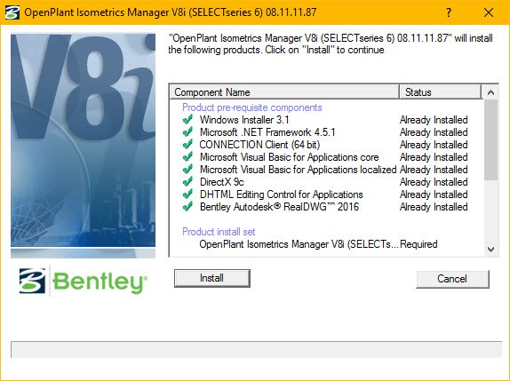

After installation of AutoPLANT Modeler, Run OpenPlant Isometrics Manager exe. See step by step procedure

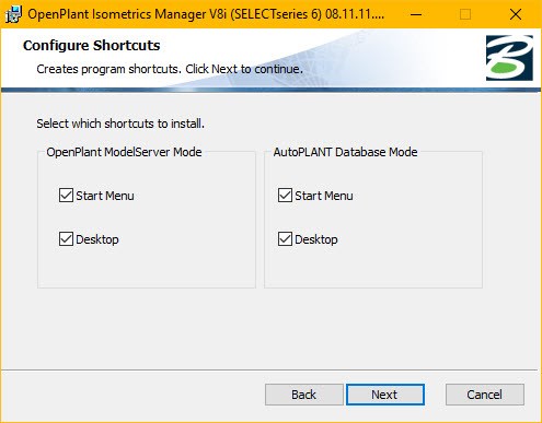

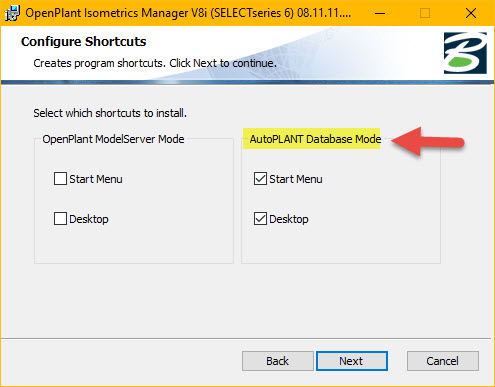

Note - Check OFF OpenPlant ModelServer Mode option when installing it for AutoPLANT Modeler side.

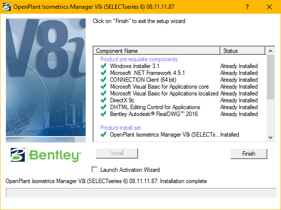

Click on Finish and OpenPlant Isometrics Manager is ready to use along with AutoPLANT Modeler.

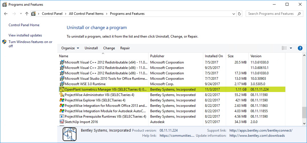

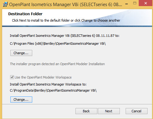

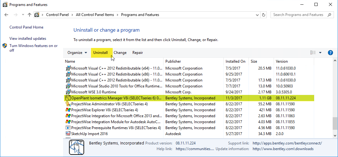

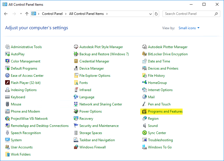

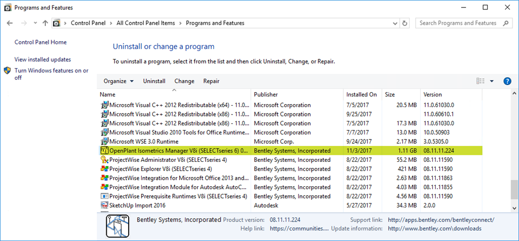

When a version of OpenPlant Isometrics Manager exists on the user machine and he wants to upgrade it to the latest version then he needs to follow the below mentioned steps.
