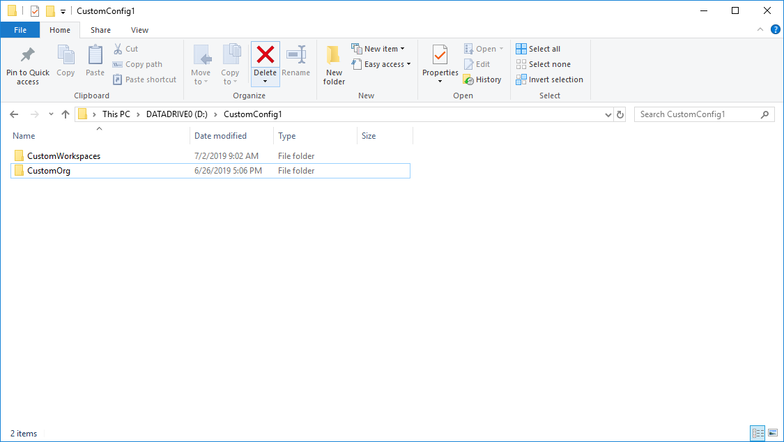

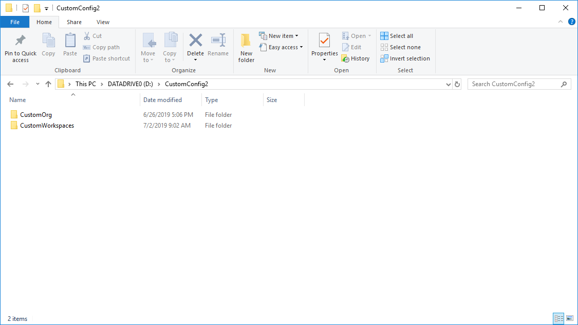

Let us consider that there are two configuration locations on the D: drive (the configurations can reside on different drives, the path, used later, would change based on that), D:\CustomConfig1\ and D:\CustomConfig2\. Under each of these folders, there must be a Workspaces folder and an Organization folder. For this example, let us consider that we have the following folders in each of the above mentioned locations:
  1. CustomWorkspaces
  2. CustomOrg
So, the folders would like these:
Under the CustomWorkspaces folder for each of the configuration locations, there should be the workspaces and their corresponding cfg files. In case otherwise, appropriate configuration variables should be modified correctly.

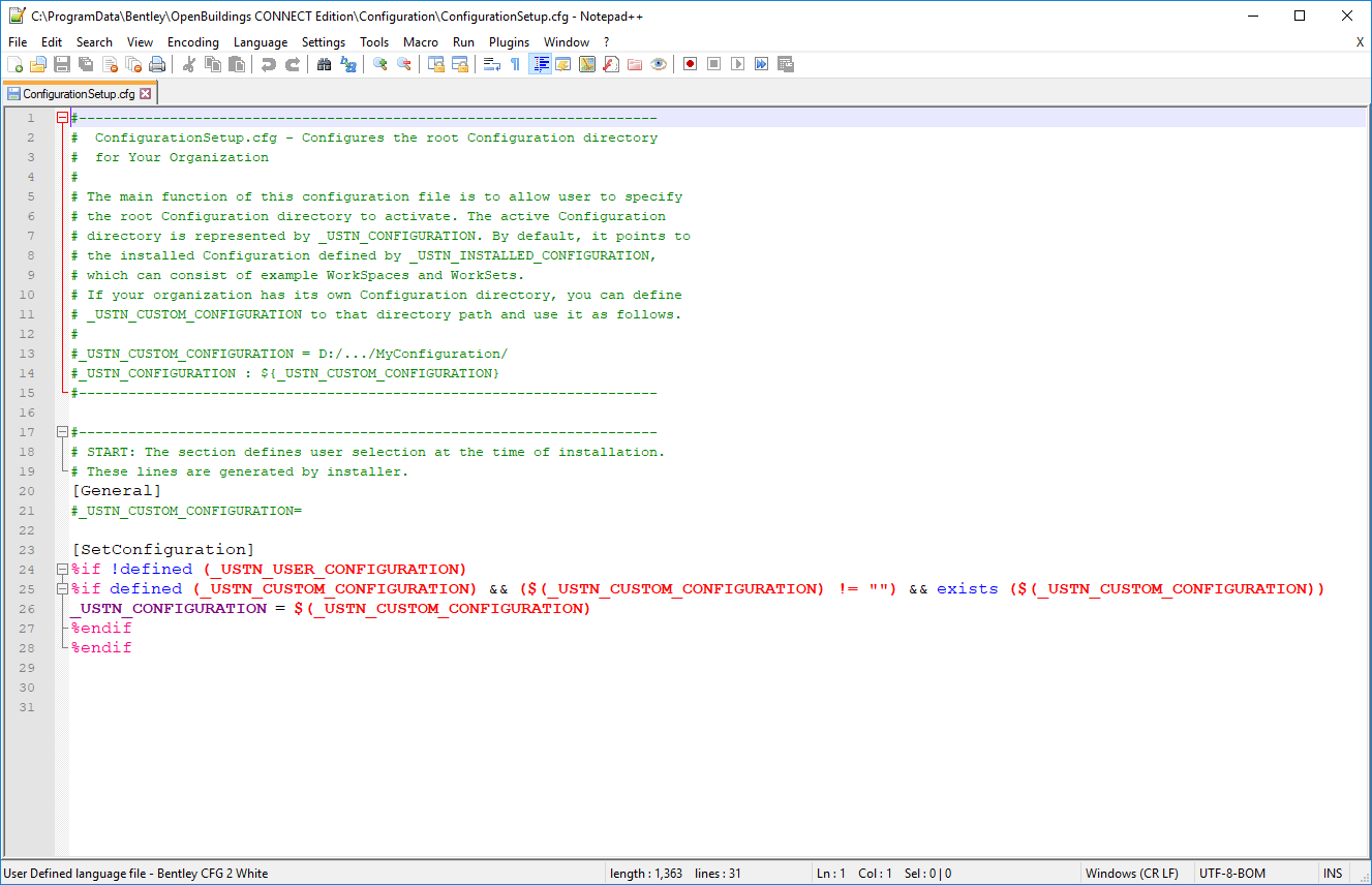

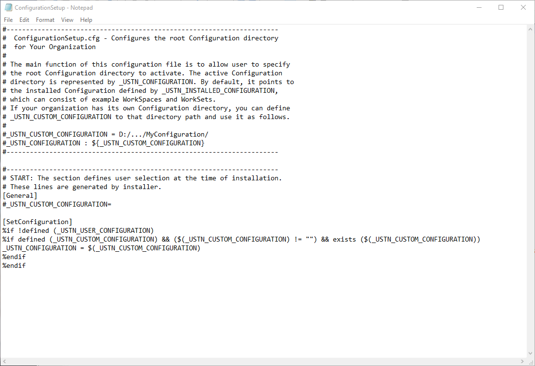

At this stage, we need to go to the installed configuration location, which is, typically, at C:\ProgramData\Bentley\OpenBuildings CONNECT Edition\Configuration\. We need to open the file called ConfigurationSetup.cfg and put a "#" before, typically, line number 21, which says "_USTN_CUSTOM_CONFIGURATION=". Then we would need to modify, typically, line number 26, so that the end result says, "_USTN_CONFIGURAITON = $(_USTN_CUSTOM_CONFIGURATION)"
The following image shows how it should look after the changes:
  1. In Notepad++ using the Bentley Configuration Language:
  2. In Notepad:

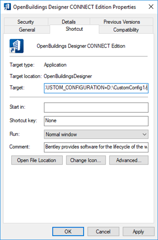

In the last part of this exercise, we need to create new shortcuts of OpenBuildings Designer on the Desktop for each of the configuration locations. For our example, we would need two. We need to go to the properties of each of the shortcuts and modify the Target field as follows:
  1. Put a space after the existing value in the field.
  2. Enter: -ws_USTN_CUSTOM_CONFIGURATION=<full path to your custom configuration location>
  3. In our example, the full paths are:
    1. D:\CustomConfig1/
    2. D:\CustomConfig2/
After the modification, it should look like the following:
If all went well, double clicking the shortcuts would directly show the list to the workspaces and worksets that are available in the corresponding configuration folder.
