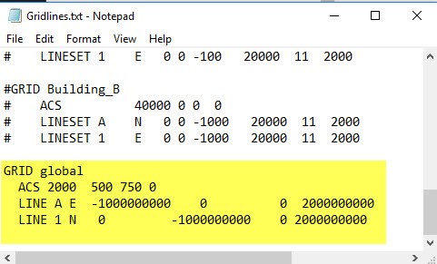

  2. Open Gridlines.txt file in Notepad.
  3. Define new grid.

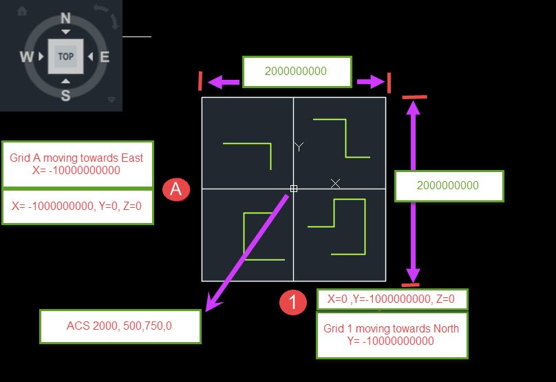

    GRID global
    ACS 2000  500 750 0
    LINE A E  -1000000000    0          0  2000000000
    LINE 1 N   0         -1000000000    0 2000000000

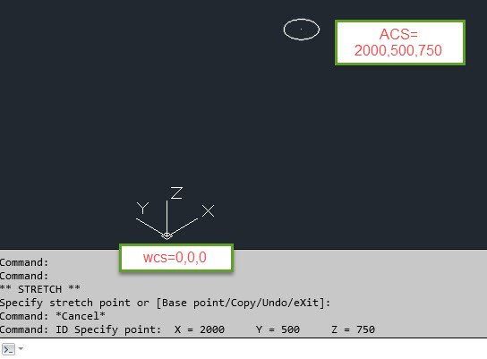

Refer below image for actual location of ACS.
Define grid so that all model should be covered in define grid.
Grid definition =
        Grid Name, Direction, X, Y, Z, Rotation, Length.

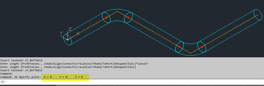

Refer below image in AutoPLANT model pipe coordinate showing 0,0,0

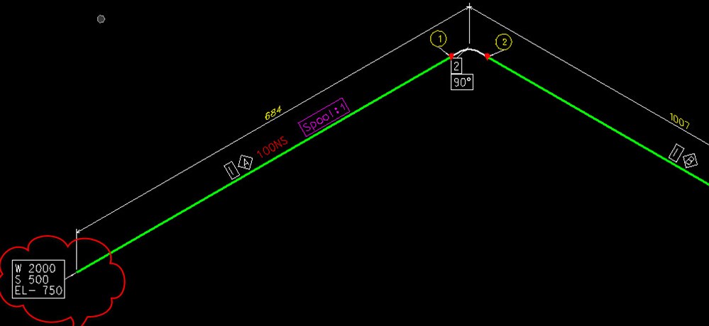

Refer below image in isometric showing coordinate 2000, 500, -750
