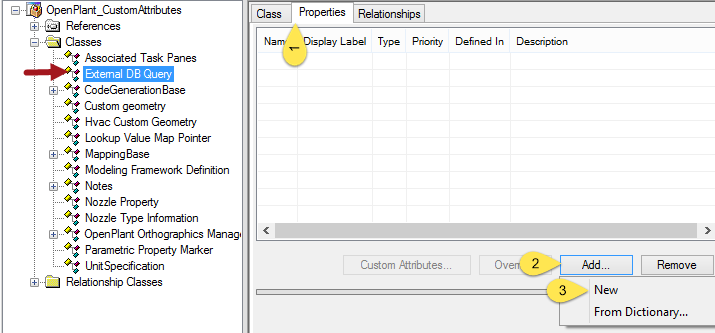

  1. Launch Class Editor and load OpenPlant_CustomAttributes.08.11 schema. This schema is located in C:\ProgramData\Bentley\OpenPlantModeler V8i\WorkSpace\OPModeler folder.
  2. Right click on the class node and click Add Class.
  3. Name the class as EXTERNAL_DATABASE_QUERY. Change “IsCustomAttributeClass” to True.
  4. Switch to properties tab and click ADD button to add new property.

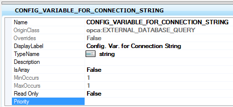

  5. Name the property as CONFIG_VARIABLE_FOR_CONNECTION_STRING.
  6. Similarly add three more properties as shown below.
    Note: Change the Type to Boolean as highlighted above.
  7. SAVE the changes in this schema.

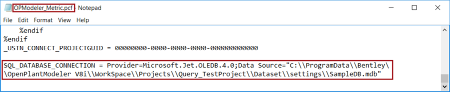

  1. Config. Var. for Connection String: This contains the configuration variable defined in the project pcf. File, which holds the database connection information. Below is the example of added variable in PCF file.
