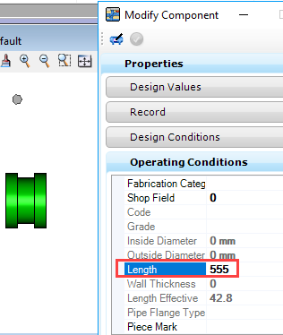

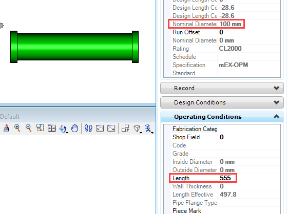

In OpenPlant Modeler we place Inline Piping Component and then changing its Length. When we will try to change components Size using Spec/Size change option, it will Automatically change component length to the value which is written in COMP_LEN field of specification. Such behavior is not useful for user who have modeled large Piping systems and after any size change they will be forced to go and try modify each Inline Component manually.

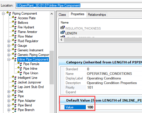

  2. Search for Inline Pipe Component class, select on Properties section, LENGTH property and scroll till OpenPlant_Physical_Catalogue_Property_Map custom attribute.
    Verify, that system is always checking COMP_LEN value on specification and this is the cause of such OpenPlant behavior.

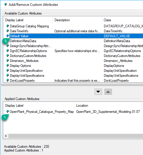

  3. Select to Add/Remove Custom Attributes. Then in opened dialog, remove existing OpenPlant_Physical_Catalogue_Property_Map  and add Default value
    Input some standard Default value which always will be used while placing new Inline Pipe Component, but wont be used anymore while using Change Spec / Size option.

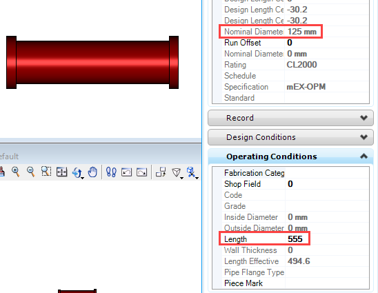

  5. Launch OpenPlant Modeler, place any Generic Pipe Component and modify its Length

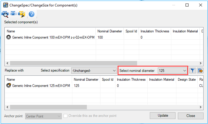

  6. Now use Spec / Size change option to modify its Size from 100 to 125

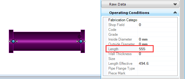

  7. Save the settings and verify the result as shown below.
