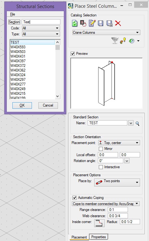

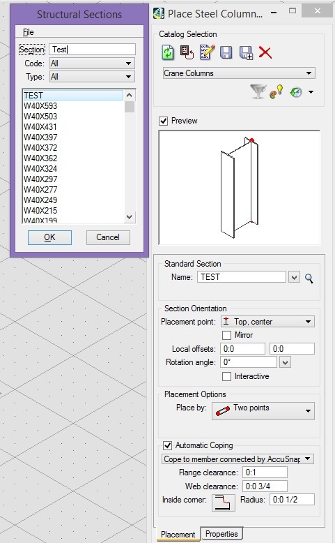

How to add customized structural sections available for placement in AECOsim?
The majority of our structural placement tools use sizes listed in the Standard Section panel of the placement dialog. The shapes listed in the drop-down menus are populated by XML files from the active dataset supplemented by the ProjectShapes.xml located in each project.

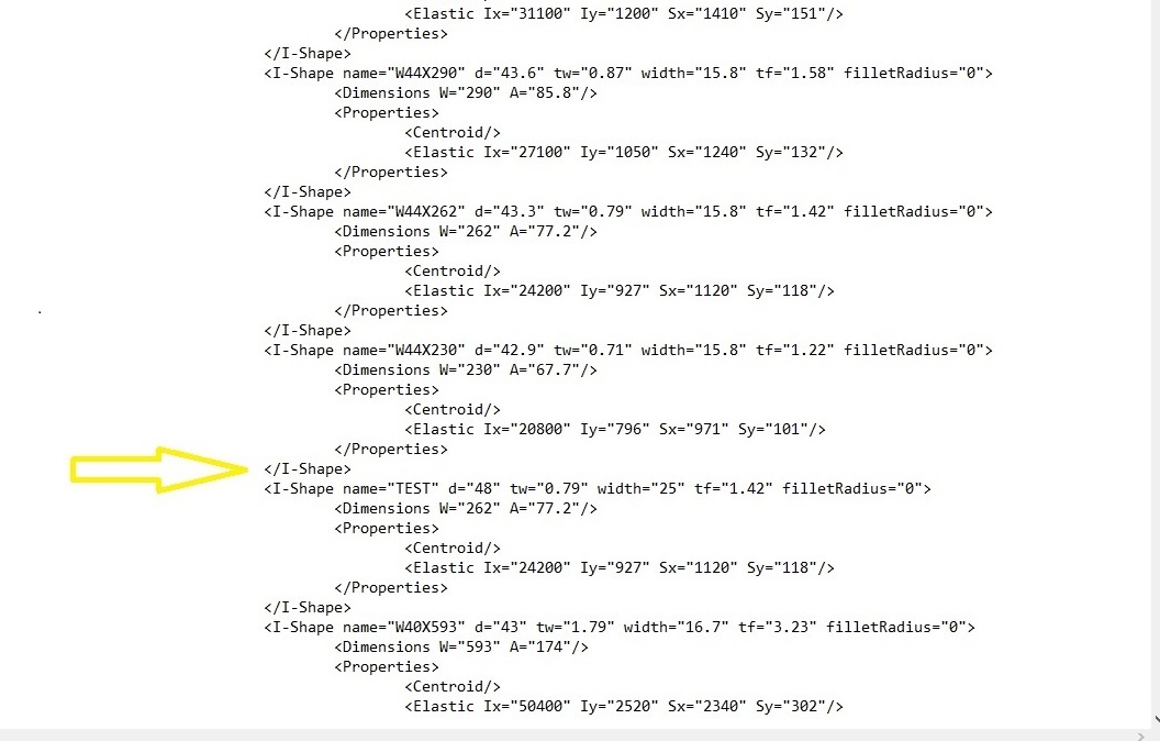

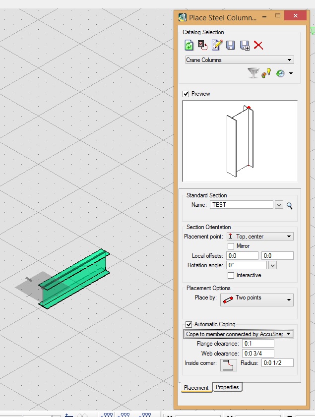

In order to add a custom structural section, the *.xml file needs to be configured so that includes the section size you will like to have available,for example; let’s say the section needs to be in the ProjectShapes.xml, open, for example, the us.xml in notepad (or use a xml editor of your choice), copy one of the sections that closely resembles the one you need and paste into ProjectShapes.xml, after that make the necessary changes to the added structural section. Make sure the format is the same between the new section and the delivered ones.
