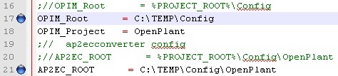

  4. Open config.ini file from (%PROJECT_ROOT%\Config) folder with any text editor and change OPIM_Root and AP2EC_ROOT variables. See image Below:

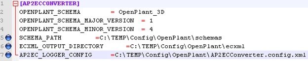

  5. If there is need, open AP2ECConverter.ini file from C:\TEMP\Config\OpenPlant folder and change SCHEMAS_PATH, AP2EC_LOGGER_CONFIG or ECXML_OUTPUT_DIRECTORY paths.

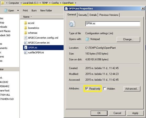

  6. Create new style; update custom OPIM.ini file and change file rights as Read-only. If not, after every OpenPlant Isometrics Manager configuration dialog opening and closing from Project Administrator, it will update your custom OPIM.ini file with project styles.
