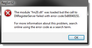

While trying to work in AECOsim Building Designer, the following error displays:
Cause of the Error:
The error is raised when a compilation error exists in the VBA code inside a protected (hidden) module. The specific compilation error is not exposed because the module is protected.
If you have access to the VBA code in the document or project, unprotect the module, and then run the code again to view the specific error.
If you do not have access to the VBA code in the document, then contact the document author to have the code in the hidden module updated.
