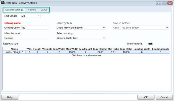

User may need custom fitting in design as per design requirement. In BRCM, custom fitting is created from the existing fitting and by Raceway Catalog Creation.
This document is how to create custom fitting in the existing catalog as per the design requirement.

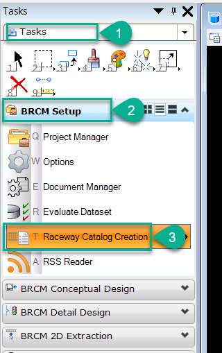

  1. Click the Tasks -> BRCM Setup -> Raceway Catalog Creation

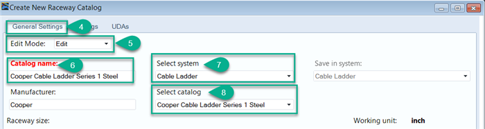

  2. Create New Raceway Catalog window pop-ups and there are tab General Setting, Fittings, UDAs.

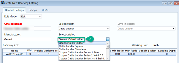

  3. In General Settings, change Edit Mode as Edit, select catalog name (Copper Cable Ladder Series 1 Steel) then Select system (Cable tray Solid Bottom, Cable Ladder, Cable Basket, Conduits)

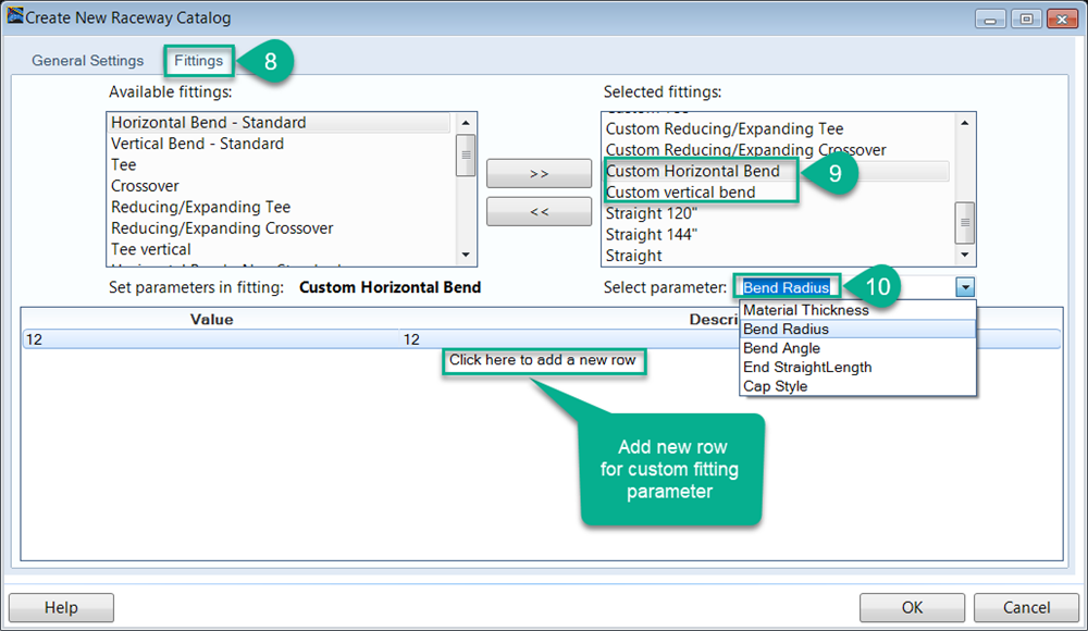

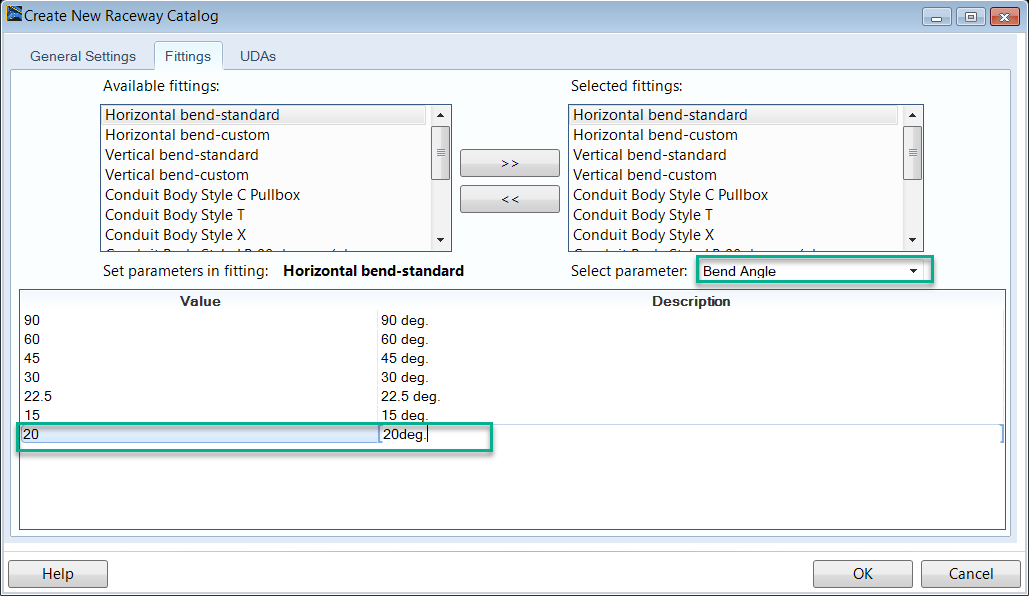

  4. In Fittings, there are Available fittings for selected raceway system in BRCM and Selected fitting are fitting customized according to the parameter that are mentioned
  5. Click to add new row for adding parameter for selected raceway catalog.
  6. Add value and description for same parameter.
  7. IN UDA tab, can add additional if you need for fitting.
  8. Click OK.
    NOTE: Before modifying this, make a backup copy of dataset.

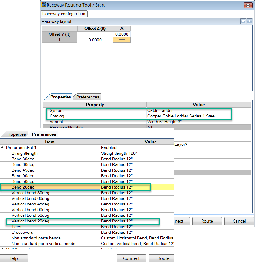

    Verify Results: For Cooper Cable Ladder series 1 steel catalog, Bend 20deg. And vertical Bend 20 deg. is categorized. We can place its fitting by selecting Preference and Place Part.
