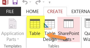

  1. Create a new mdb file, say Revision.mdb here & locate the same in working isometric style folder. See below path to store it.
    %\Project root\%WorkSpace\Projects\OPModeler_Metric\DataSet\Isometrics\ Styles\Check\Config

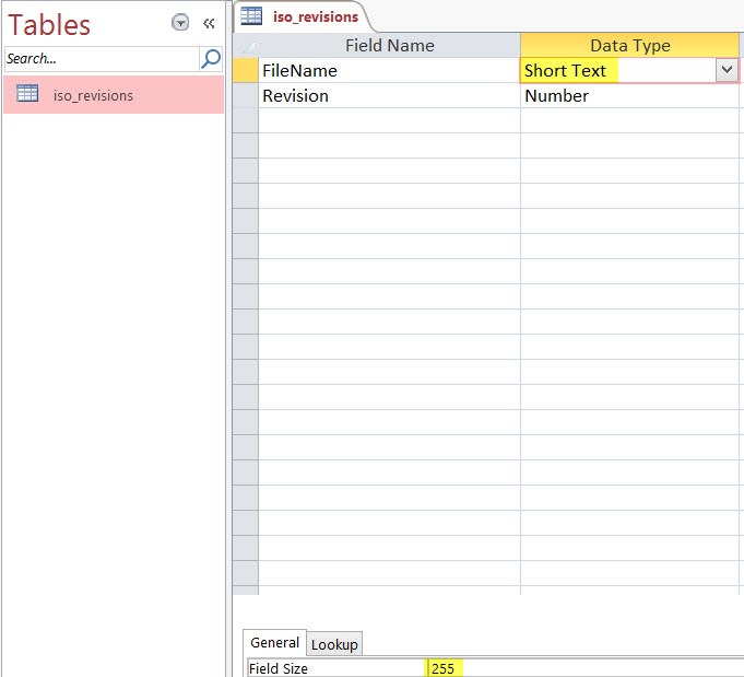

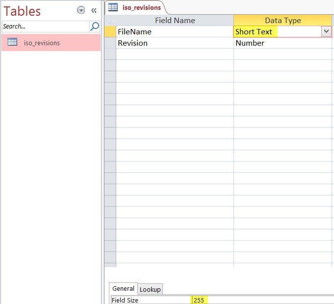

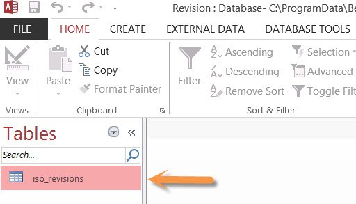

  2. Create a Table as Iso_Revisions.

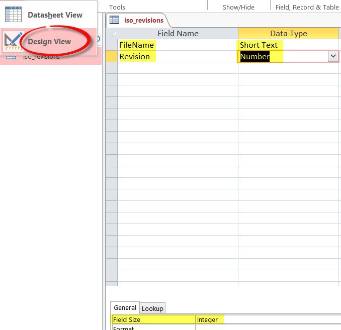

  3. Go to Design View and create Field Name “FileName” & “Revision” with suitable Datatype selection. See images below.

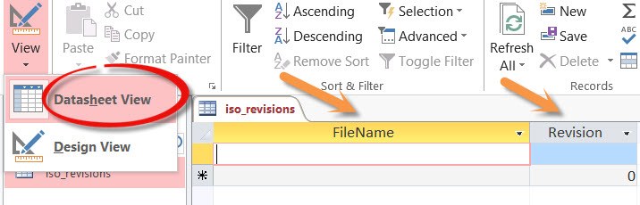

  4. In Datasheet view, see image below.
  5. Close the file.

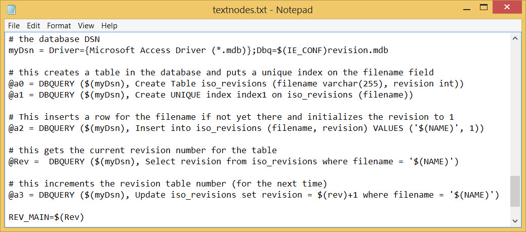

  6. To write db query, user need to write the statement inside “textnodes.txt” file which is present under styles folder.
  7. Write query in file as mentioned below:
    # The database DSN
    myDsn = Driver={Microsoft Access Driver (*.mdb)};Dbq=$(IE_CONF)revision.mdb
    # this creates a table in the database and puts a unique index on the filename field
    @a0 = DBQUERY ($(myDsn), Create Table iso_revisions (filename varchar(255), revision int))
    @a1 = DBQUERY ($(myDsn), Create UNIQUE index index1 on iso_revisions (filename))
    # This inserts a row for the filename if not yet there and initializes the revision to 1
    @a2 = DBQUERY ($(myDsn), Insert into iso_revisions (filename, revision) VALUES ('$(NAME)', 1))
    # this gets the current revision number for the table
    @Rev =  DBQUERY ($(myDsn), Select revision from iso_revisions where filename = '$(NAME)')
    # this increments the revision table number (for the next time)
    @a3 = DBQUERY ($(myDsn), Update iso_revisions set revision = $(rev)+1 where filename = '$(NAME)')
    REV_MAIN=$(Rev)
  8. This will look like below image.
  9. Save & Close the file.

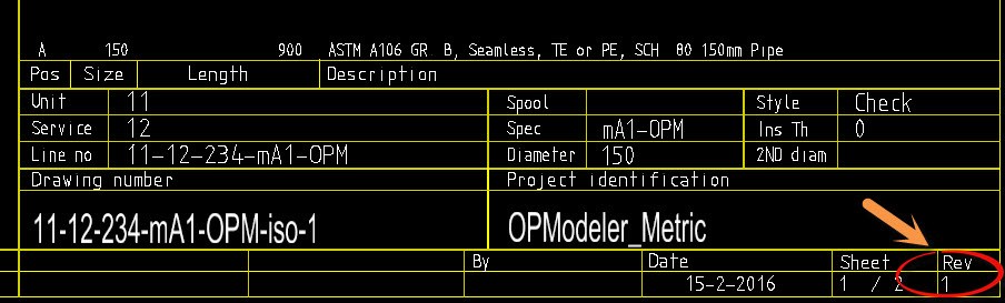

  12. Generate Isometrics and verify results.

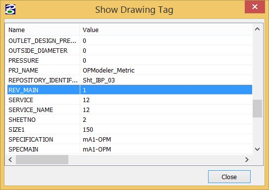

  13. Also check “Show Drawing Tag” dialog, where REV_MAIN listed.

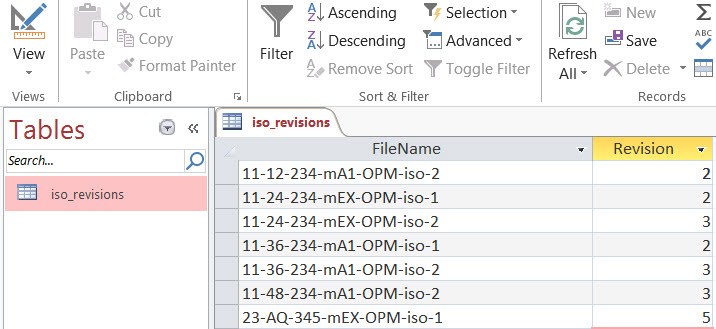

  14. In MDB file user can check all the list of iso drawing with incremented revisions going to populate in isometrics. See image below.
