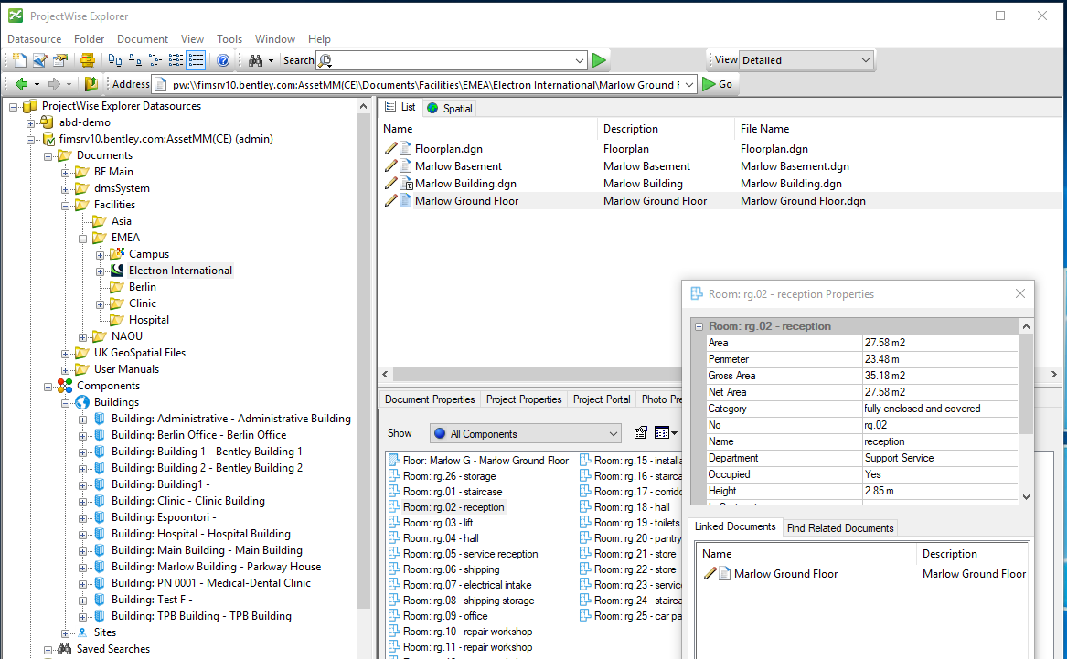

Bentley Facilities CONNECT Edition has improved integration with ProjectWise Explorer. This means that the areas and assets as well as document links are visible within ProjectWise. In addition, publishing i-models has been improved and can be integrated with i-model Composition Server. The results are visible within ProjectWise Explorer and its Navigator.
To configure ProjectWise integration for selected class, a dedicated qualifier AAQUAL_CREATE_COMPLINK=1 needs to be added for the class. Note that to function this requires Location information, so it can only be used for Area classes and Asset classes that have Location addon configured.
