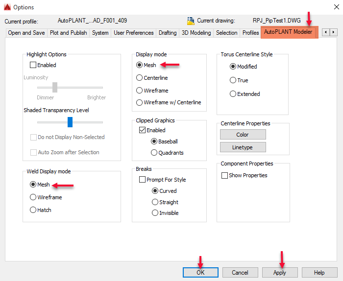

  2. Once AP file is opened type in command line OPTION for opening Options drop down window.
  3. In options drop down windows in AutoPLANT Modeler tab and check on the mesh as shown in below screenshot.

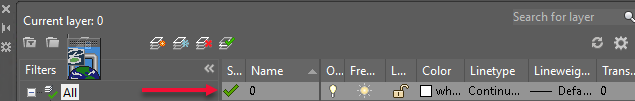

  4. Check for 0 layer to be set as default, as shown below.
