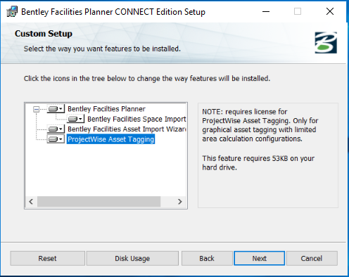

Bentley Facilities Planner CONNECT Edition
NOTE. The licensing is altered if the ProjectWise Asset Tagging module is selected in order to install the required Asset Tagging configurations.  This also means that most of the Area Calculation and Linking options do not work as with a full license.

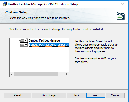

Bentley Facilities Manager CONNECT Edition

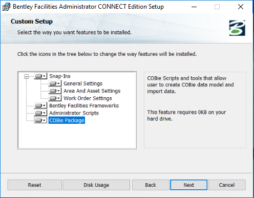

Bentley Facilities Administrator CONNECT Edition
