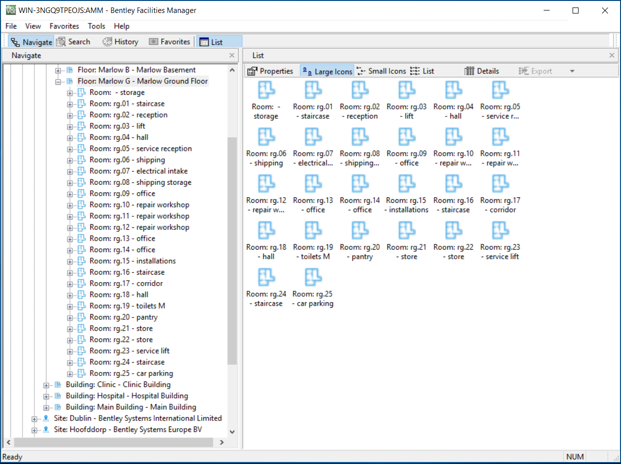

To display location and organization hierarchies
1. In Bentley Facilities Manager, right-click in the Navigate window and choose Navigate > Top.
2. Right-click again and choose Links > Location Link.
3. Right-click one more time and choose Links > Organization Link.
4. The top-level entry of the selected hierarchies appears in the list.
You can expand the hierarchies by double-clicking the entries or clicking on the + symbol to the left of each entry. Those that have entries below them expand.
