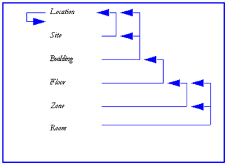

Locations can be added to other locations, but not to any other type of area. This allows you to define a hierarchy of locations,starting at an international level, down through the various countries in which an organization has offices, to the cities where these offices are located.
Sites can be added to locations, but not to any other type of area. Buildings can only be added to sites or locations. Floors can only be added to buildings. Zones can only be added to floors, not to other zones.Rooms can only be added to zones or floors, not to other rooms. Any of these areas can form the top level of the hierarchy, but placing anything other than a location at the top restricts the number levels available in the hierarchy.
