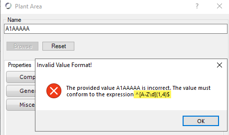

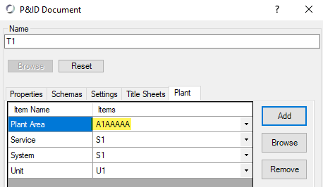

When in OpenPlant Power PID and adding a new PLANT AREA value to the drawing settings have you ever wondered why it is limited to 4 characters and only upper case letters?

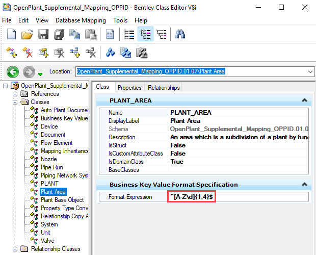

This is controlled in the OpenPlant_Supplemental_Mapping schema located in the WorkSpace\Projects\<project name>\Dataset\schemas directory. In this file under the classes node you will find the Plant Area class.

  1. Start Class Editor and open OpenPlant_Supplemental_Mapping schema
  2. Select on required Associated Item Class and check Business Key Values Format Specification.
  3. Value in Format Expression field is a Parser Regular Expression
    Specifically this Expression states:
    ^Required in order to start the expression
    A-Z\dUppercase Letters A through Z and any number 0-9
    {1,4}At least 1 character but no more than 4 characters
    $Match at the end of the input - terminates the expression
  4. Edit this {1,4} by extending allowable count of characters from1 to 8
  5. Save changes and verify that you can create longer name Plant Area
