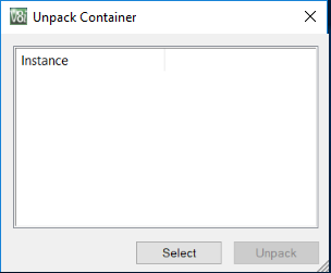

  3. From the Planner menu, choose Asset > Unpack Container.
    The Unpack Container window opens.
  4. In the view window, select the container to unpack, then confirm the selection with a data point.
    The objects in the container display in the Unpack Container window
  5. In the Unpack Container window, select the asset to unpack and place in the DGN, then click Unpack.
    The selected asset attaches to the cursor.
  6. Place the asset in the DGN with a data point and set its rotation with a second data point.
    The asset is placed in the DGN. Repeat steps 5 and 6to unpack the rest of the container. When the container is empty, it is automatically deleted.
