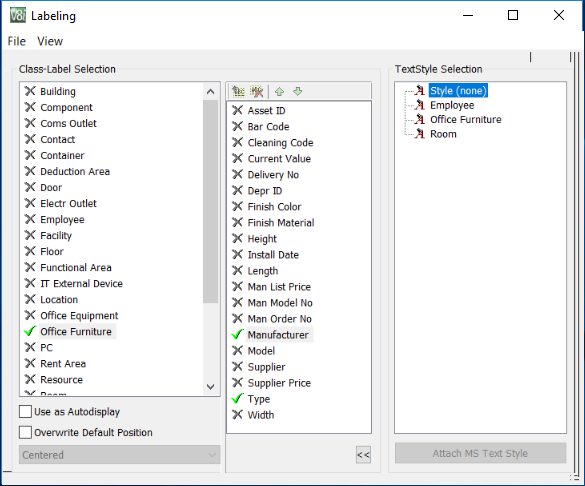

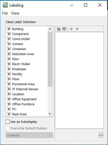

  2. From the Planner menu, choose Display > Label Display. The Labeling dialog box opens.

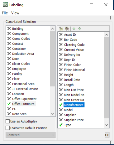

  3. In the left pane, turn on the classes of areas and/or assets for which you want labels to display.
  4. In the right pane, turn on the attributes you want to display as the selected areas' and/or assets' labels.
  5. (Optional) Click the >> button at the bottom right corner of the dialog box to display a third pane. If you have a MicroStation text style saved to a folder in your Bentley Facilities datasource, you can select it here. The labels will display using this text style.

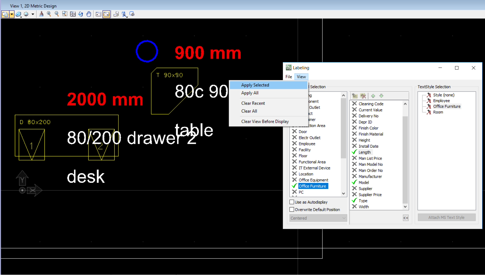

  7. From the dialog boxes' View menu, choose Apply All or Apply Selected. In the view window, labels display next to the areas and or assets you selected in the dialog box. If a fence or selection set is active, only the areas/assets within the contents of the fence or selection set will have labels displayed for them.
