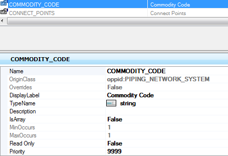

  5. Expand the tree in the left hand pane and pick the PIPING_NETWORK_SYSTEM class.
  6. In the right hand pain select the Properties tab.
  7. From the Class editor right hand pane select the Add… button and then select New from the context menu.
  8. Add the new property COMMODITY_CODE as shown below.

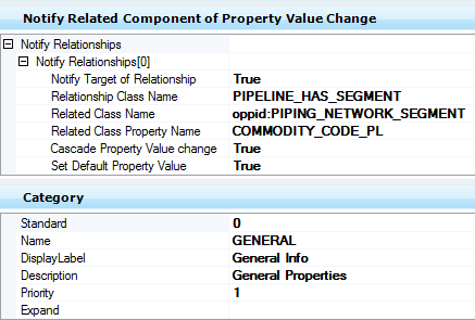

  9. After adding the new property, pick it and then select the Custom Attributes… button and from the context menu select Add/Remove…
  10. Add a Notify Related Component of Property Value Change and a Category Custom Attribute. Fill these in as shown below.
  11. Details on the Notify Related Component of Property Value Change custom attribute are as defined below.
    FIELDVALUEDESCRIPTION
    Notify Target of RelationshipTrueSets the notify to “on”
    Relationship Class NamePIPELINE_HAS_SEGMENTThis defines the relationship used to transfer the property value from this class to the other class.
    Related Class Nameoppid:PIPING_NETWORK_SEGMENTDefines the target class for this property value. It is prefixed with the schema namespace of the schema where the property is defined.
    Related Class Property NameCOMMODITY_CODE_PLName of the property on the target class.
    Cascade Property Value ChangeTrueChanges made to the property on source will be cascaded to the property on the target.
    Set Default Property ValueTrueWhen a value is entered in the property on the source class it will also set the property as the value on the property on the target class. If set to False, after placement the COMMODITY_CODE_PL property would not have a value until a change was made to the property on the source.
  12. Save the Schema.

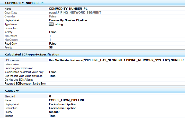

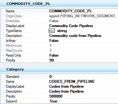

Editing the OpenPlant_PID schema for Pipe Run – Adding New Properties
Now you will modify the PIPING_NETWORK_SEGMENT class and add the new properties to hold the Commodity Code and Number values passed to Pipe Run from Pipeline.
  1. Continuing in the Bentley Class Editor and the supplemented OpenPlant_PID schema, locate the PIPING_NETWORK_SEGMENT class.
  2. Switch to the Properties tab.
  3. Add the new COMMODITY_CODE_PL property. For this example we are adding this property to its own Category for simplicity sake and to verify our changes when we progress through testing. See below for details.
  4. Repeat step 3 above and add the COMMODITY_NUMBER_PL property. For this property add the Category custom attribute and a Calculated ECProperty Specification custom attribute. See below for details.
    The ECExpression is used so that the run will read the number property from the pipeline without requiring the Pipeline Number to be edited first. If you use a Notify Component of Property Value Change custom attribute on the NUMBER on PIPELINE and the number value is not changed when initial placed the number will not pass to run. This is the case only when the default number on line (0001) is not changed.
  5. Save the schema.

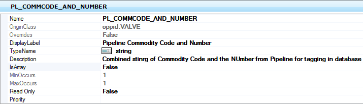

Editing the OpenPlant_PID schema for Valve – Adding New Properties
Now you will modify the VALVE class and add a new property to hold the Commodity Code and Number values passed to Pipe Run from Pipeline. You will need this value later when defining the Valve Tag Type in the database. This property does not need to be displayed as it only used for writing a calculated value to the valve database table.
  1. Continuing in the Bentley Class Editor and the supplemented OpenPlant_PID schema, locate the VALVE class.
  3. Pick the Add… button and from the menu select New.

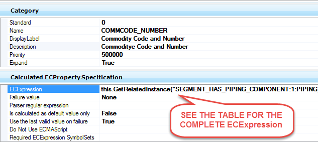

  4. Add a new property for the Pipeline Commodity Code and Number combined string. Name your property PL_COMMCODE_AND_NUMBER as shown below.
  5. Add Category and Calculated ECProperty Specification custom attributes. See below. NOTE – The Category custom attribute is for reference only and so we can verify our schema changes during the testing stage. It can be removed once this is complete. The ECExpression for the Calculated ECProperty Specification custom attribute is as follows:
    ECExpression
    this.GetRelatedInstance("SEGMENT_HAS_PIPING_COMPONENT:1:PIPING_NETWORK_SEGMENT").COMMODITY_CODE_PL & this.GetRelatedInstance("SEGMENT_HAS_PIPING_COMPONENT:1:PIPING_NETWORK_SEGMENT").COMMODITY_NUMBER_PL
    This sets the value for the property to be the Commodity Code and sequential Number from the Pipeline. The Pipeline Commodity Code and Pipeline Number are called from Pipe Run using the SEGMENT_HAS_PIPING_COMPONENT relationship. This is possible because you previously passed these properties from Pipeline to Pipe Run.
  6. Save the schema.

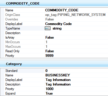

  4. In order to get the COMMODITY_CODE property to show up in the Tag Information category, use the Add… button in the top panel and add the COMMODITY_CODE property.
  5. Once this is added add a Category custom attribute and fill it in as shown below.
  6. Save the Schema.

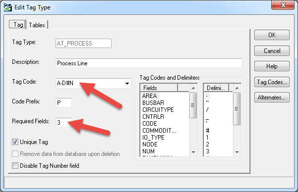

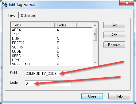

  3. Locate the Tag Type AT_PROCESS and pick the Edit… button.
  4. The default tag format is “Number” you need to change this to be Area-<Commodity Code><Number>. To do this you must first create a new Tag Code for the Commodity Code field.
  5. In the Edit Tag Type dialog pick the Tag Codes… button.
  6. In the Edit Tag Format dialog in the “Field” section enter COMMODITY_CODE. In the “Code” section enter the first available letter – by default this is “D”. See below for details.
  7. Pick Add. Pick Close to return to the Edit Tag Type dialog.
  8. Now you need to adjust the Tag Code to match the new Tag Format. Using the Tag Codes and Delimiters enter the letters and proper delimiters to make up your Tag Code. Backspace over the current N. Select A, followed by the dash. Then pick the new D followed by the # sign delimiter and then pick an N.
  9. Select in the Required Fields section and change this to 3. See below for the finished Tag Type.
  10. Pick OK. When prompted with a Tag Number Fields dialog informing you that the PCOMMODITY_CODE field was not found in the database pick the Yes button – you will remedy this warning by adding the fields to the database tables later.
    NOTE: The # sign is a special delimiter. This is used when two fields are required in a tag and there is not a delimiter between them. Specifically in this case the Commodity Code is an Alpha character and the Number is a Numeric character. The # symbol is used and informs the system that the first part of the tag after the preceding dash is ALPHA characters and that this field continues to be populated with characters until it reaches a NUMERIC character. At that point it assigns the NUMERIC characters after the # to the next field. In this case it is to the end of tag but it could continue until another delimiter is found.

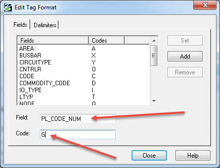

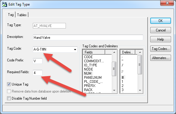

  11. Continuing in the Project Administrator and the Tag Types page – locate the AT_HVALVE Tag Type and then pick the Edit… button.
  12. The default tag format is “Code-Number” you need to change this to be Area-<Commodity Code & Number from pipeline>-<Device Type Code><Number>. To do this you must first create a new Tag Code for the Commodity Code/Pipeline number combined field.
  13. In the Edit Tag Type dialog pick the Tag Codes… button.
  14. In the Edit Tag Format dialog in the “Field” section enter PL_CODE_NUM. In the “Code” section enter the first available letter – by default this is “G”. See below for details.
  15. Pick Add. Pick Close to return to the Edit Tag Type dialog.
  16. Now you need to adjust the Tag Code to match the new Tag Format. Using the Tag Codes and Delimiters enter the letters and proper delimiters to make up your Tag Code. Backspace over the current C-N. Select A, followed by the dash. Then pick the new G followed by the dash delimiter and then pick a T followed by the # sign and then pick N.
  17. Select in the Required Fields section and change this to 4. See below for the finished Tag Type.
  18. Pick OK. When prompted with a Tag Number Fields dialog informing you that the VPL_CODE_NUM field was not found in the database pick the Yes button – you will remedy this warning by adding the fields to the database tables later.

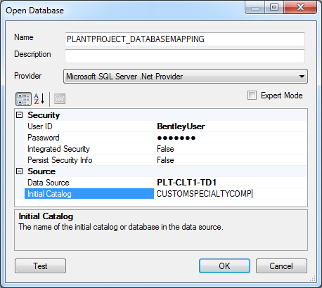

Schema Changes – Part 2
Editing the OpenPlant_PID schema and Mappings to Database
Now that the schemas and database have related properties and fields and tag types are set in the database you will map the schemas changes to the database tables.
  1. Load the Bentley Class Editor.
  2. From within the class editor load the OpenPlant_PID schema located in workspace\project\OPPowerPID_Metric\dataset\schemas directory.
  3. From the menu select Database Mapping > Open…
  4. In the Open Mapping dialog pick the Browse button.
  5. In the Custom Schema and Mapping Locations dialog select the current path and then pick the Remove button. Pick the Add button.
  6. In the Browse For Folder dialog browse to your project workspace schema directory. This is located in the “…workspace\Projects\<YOUR PROJECT NAME>\Dataset\schemas” directory. Pick the directory and not a file.
  7. Pick OK and OK again in the Custom Schema and Mapping Locations dialog. Lastly pick the OK button in the Open Mapping dialog. If prompted for the OpenPlant_ProjectProperties schema browse to your projects …dataset\schemas directory and select the file. Pick Open.
  8. Now that the mapping schema is loaded you must disconnect the database and the reconnect it again so it includes the new properties that you added to the PROCESS and VALVE tables.
  9. In the Summary tab pick the Edit Database Structure... button.
  10. In the Database Structure Editor dialog pick the Remove button.
  11. Pick the Load button. Fill in the Open Database dialog as shown below. NOTE this will need to be filled in with your database type, user, server name and database instance.
  12. Hit the Kill button in the upper right hand corner to return to the Summary tab.

  14. Switch to the Properties tab.
  15. Locate the COMMODITY_CODE property.
  16. In the lower right hand panel of Class Mapping tab, select Edit… button.
  17. In the Edit Property Mapping dialog select the PROCESS table and the PCOMMODITY_CODE field in the Columns section.
  18. Pick OK.
  19. Browse to and select the VALVE class.
  20. In the Properties tab, select the PL_COMCODE_AND_NUMBER property.
  21. In the lower right hand panel of the Class Mapping tab select the Edit… button.
  22. In the Edit Property Mapping dialog select the VALVE table and the VPL_CODE_NUM field in the Columns section.
  23. Pick OK.
