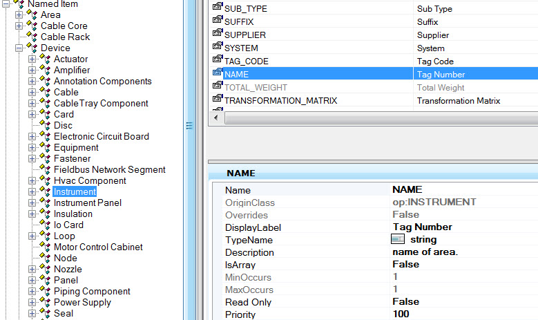

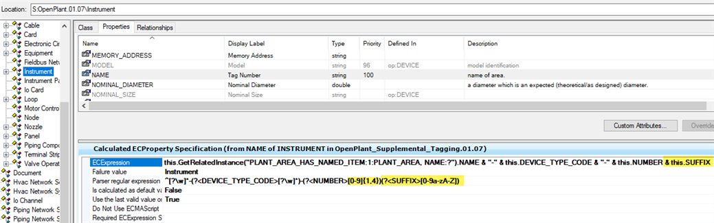

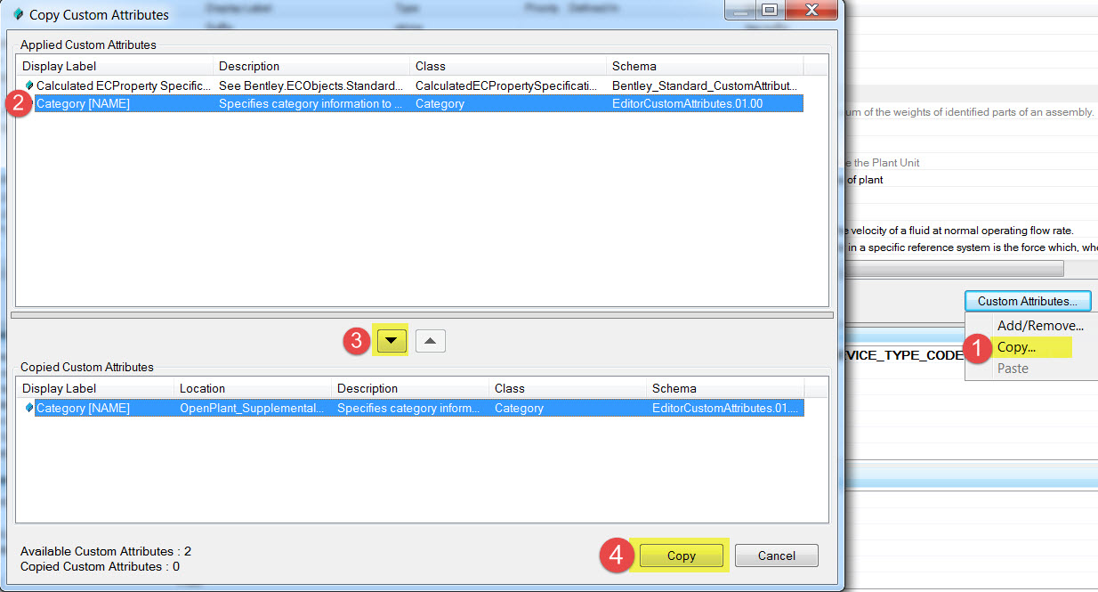

  1. Open class editor and load OpenPlant schema from \\Workspace\OPPID\schemas folder.
  2. Supplement it with OpenPlant_Supplemental_Tagging schema from \\Workspace\Project\%PROJECT_NAME%\Dataset\Schemas folder.
  3. Go to INSTRUMENT class and locate NAME property.
  4. Modify the EC Expression to add SUFFIX property and Parser regular expression as well to accommodate SUFFIX property as highlighted below.
    this.GetRelatedInstance("PLANT_AREA_HAS_NAMED_ITEM:1:PLANT_AREA, NAME:?").NAME & "-" & this.DEVICE_TYPE_CODE & "-" & this.NUMBER & this.SUFFIX
    ^[?\w]*-(?<DEVICE_TYPE_CODE>[?\w]*)-(?<NUMBER>[0-9]{1,4})(?<SUFFIX>[0-9a-zA-Z])
    Note: In the above expression, character limit has been set to 4 for NUMBER property which user can change as per their requirement.

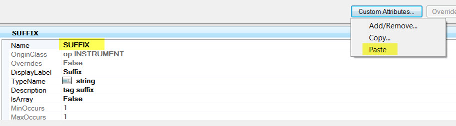

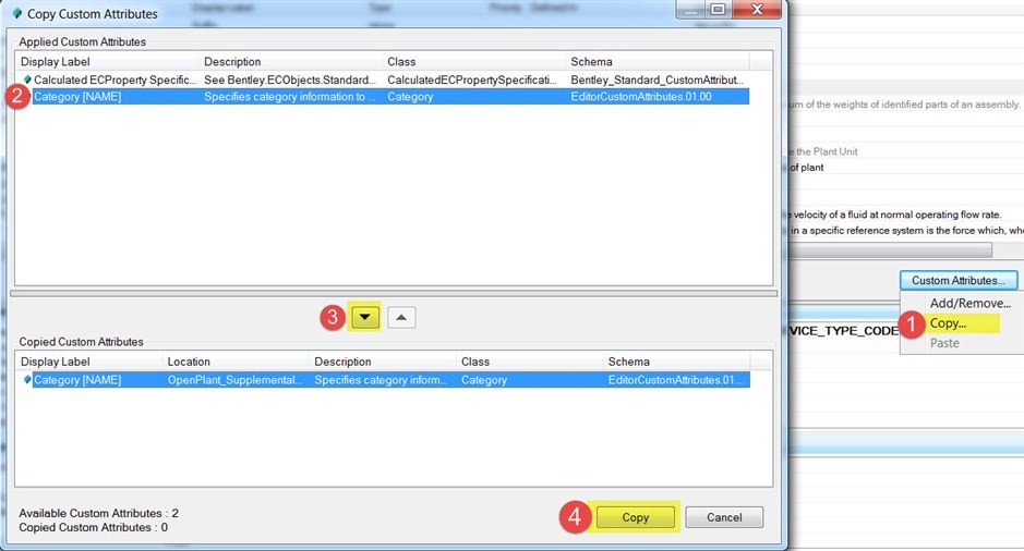

  5. Copy the Category custom attribute from NAME property.
  6. Paste the custom attribute.
  7. Save the changes in schema.

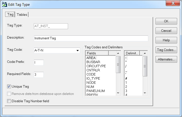

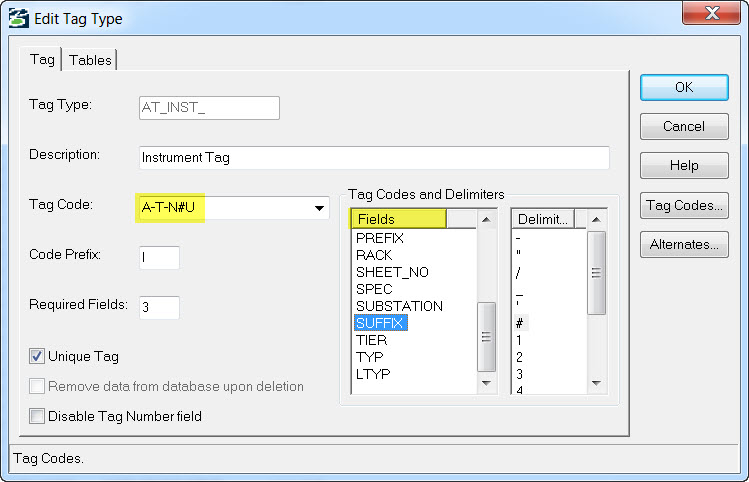

Modify Database Tag Format

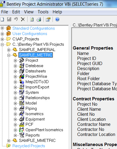

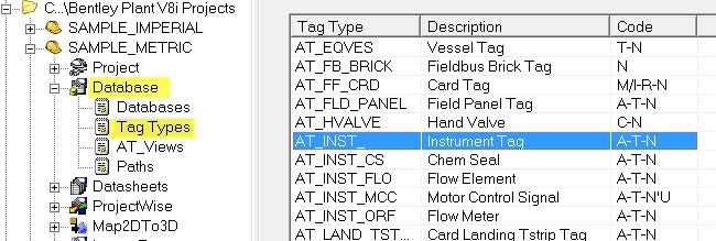

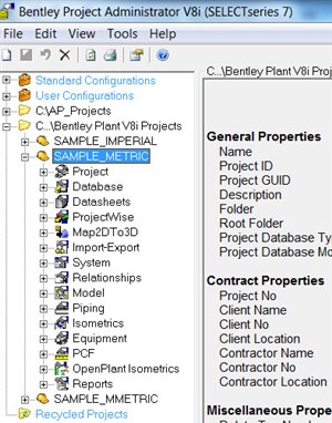

  1. Launch Project Administrator and login to your project.
  2. Go to Tag_Type node under Database and select AT_INST_ tag type.

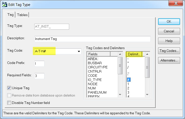

  3. Double click on the tag type to open the ‘Edit Tag Type’ dialog.
  4. Add delimiter from Delimiter list as shown below.

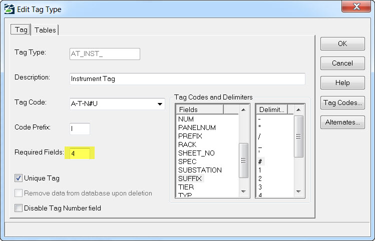

  5. Now select SUFFIX from the available fields list.
  6. Change the ‘Required Fields’ to 4 as highlighted below.
  7. Click OK to save the changes and close Project Administrator.

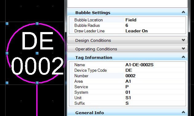

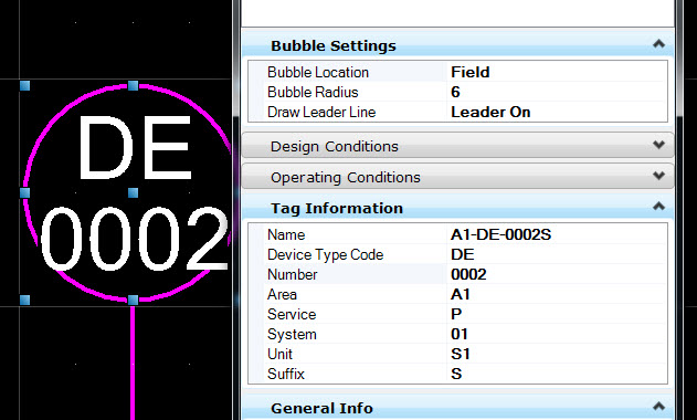

  8. Launch OpenPlant PID and verify the result.
