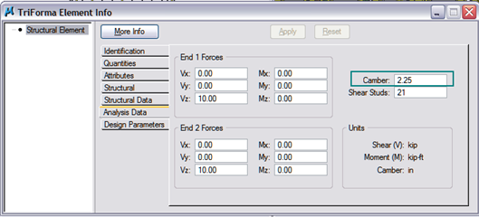

Camber
The CIS/2 export translator includes camber information for structural members when it is defined for a member. Camber values are included for both the Design and Manufacturing export options.
CIS/2 Export File
The camber is assumed to be measured at the midpoint of the linear member. The camber is expressed as an “absolute” (not relative) value in the CIS/2 export file. The camber is also assumed to have only a component in the Z axis (not the Y axis). RAM does not assign a Y component of camber.
The units of the camber are given in master units.

Shear stud values are typically imported from analysis applications such as RAM.
The Shear Studs field contains the number of shear studs associated with a member. There is no other information (currently) imported from RAM about the shear stud configuration. Only the shear stud counts are imported.
In the case of multiple groups of studs the stud counts are represented by a series of integer values: For example, “3, 2, 3” denotes three groups of studs having counts of 3, 2 and 3 respectively. Multiple stud counts may be present when a member has other members connected to it and the stud counts are divided along the member. Each group represents the number of studs that appear in a particular segment.

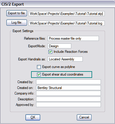

Detailing applications such as Tekla or SDS will calculate the actual positions of the shear studs for manufacturing. Consequently, by default, no coordinates of the individual shear studs are calculated and all the shear studs for a particular joint are placed at the origin of the joint.
There is a setting in the export dialog box to generate approximate coordinates of the shear studs in the joint. The coordinates are calculated based on the assumption that there is a single row of studs evenly spaced along the member. The coordinates are approximated so that the shear stud joints may be visualized in tools such as the NIST CIS/2 -> VRML translator. Please note that turning on the generation of the shear stud coordinates can have significant performance impacts for models with a large number of shear studs.

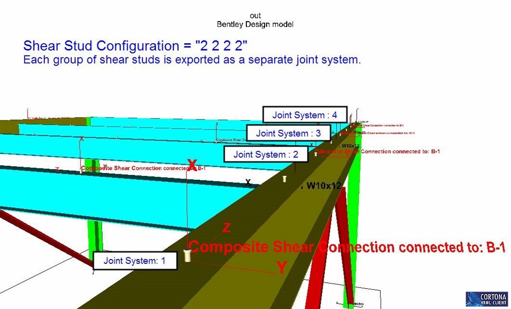

In the meantime, the NIST CIS/2->VRML translator can be used to view the export file and visualize the shear stud connections for each member.
http://cic.nist.gov/vrml/cis2.html
Version CTV 7.50 and later is necessary to view Design model shear stud connections.
http://www.parallelgraphics.com/products/cortona/
This is a good VRML plug-in for a web browser. It is necessary for the NIST translator.
This is an example of a Design model with a member that has a “2, 2, 2, 2” stud configuration.

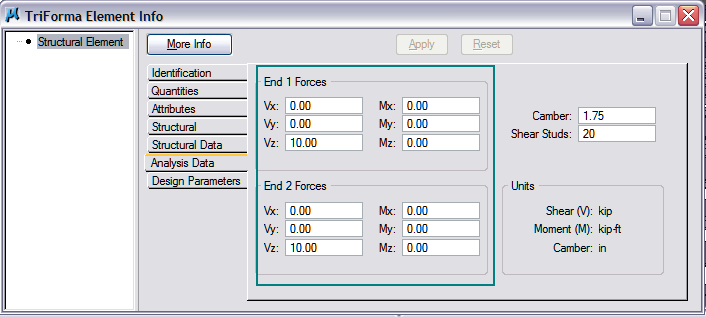

Reaction Forces
Reaction forces are associated with members in the Structural Data of an element. The End1 Forces and End2 Forces fields are used to hold the reaction forces for the respective ends.
The units of a reaction force are kips for imperial models and kN (kiloNewtons) for metric models.
The units of a reaction moment are kip-ft for imperial models and kN-m (kiloNewtons-meters) for metric models.

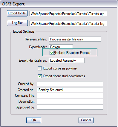

The CIS/2 Export dialog box has a new checkbox “Include Reaction Forces”. When checked, this will add the Analysis model (with the reaction forces) to the Design model in the CIS/2 export file. The Manufacturing model does not support the export of reaction forces so when the primary export model is set to Manufacturing the “Include Reaction Forces” checkbox is disabled.
The Analysis model is not automatically included because it does increase the export time. Typically, adding the Analysis model will approximately double the export time and the size of the resulting CIS/2 file.

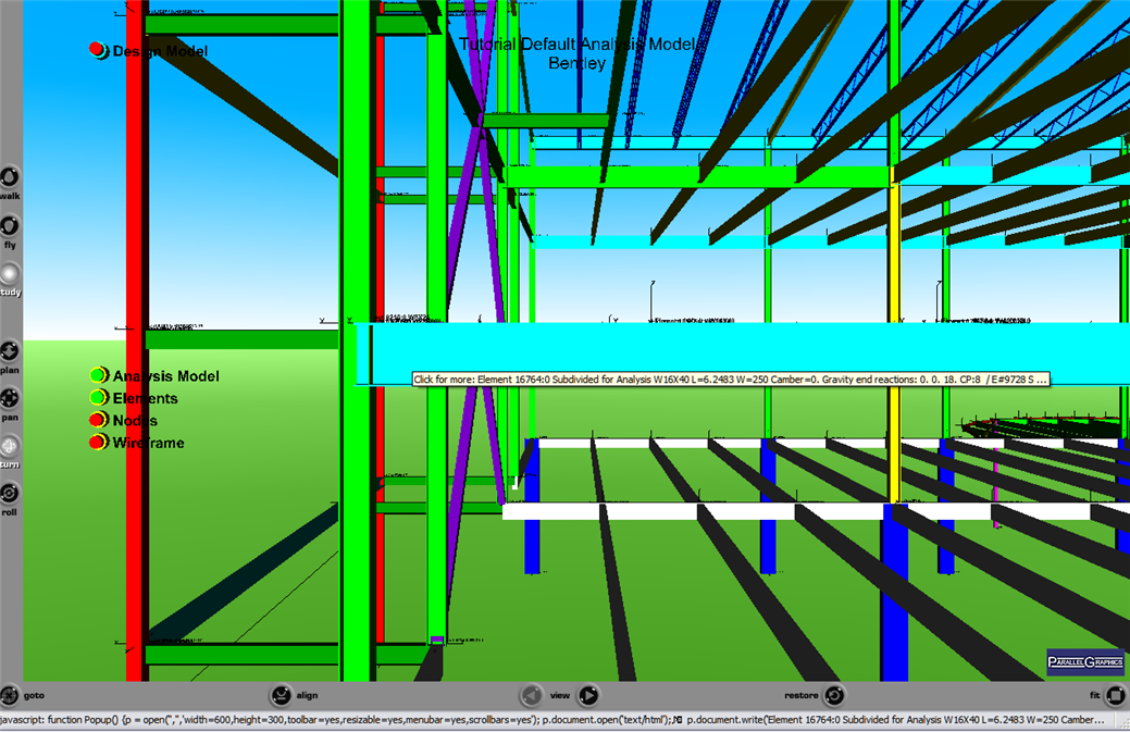

The NIST CIS/2->VRML translator can be used to view the export file. For the Analysis model it will display the reaction forces in flyover text in the browser. When the cursor hovers over an element the flyover text will be displayed. Any reaction force that is present will be at the end of the flyover text such as “..Gravity end reactions: 0. 0. 18.”.
This capability is enabled only when the output browser is set to Firefox in the NIST translator. This is due to a limitation in Internet Explorer with respect to the size of flyover messages.

You may view either the Design model or the Analysis model (or both) by using the on-screen display buttons “Design Model” and “Analysis Model”. If the button is green the corresponding model is shown; if it is red the model is hidden.
The Analysis Model display mode has options to show any combination of the structural elements, nodes or wireframes that represent the analysis model.
