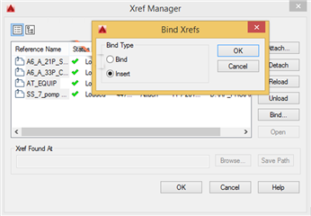

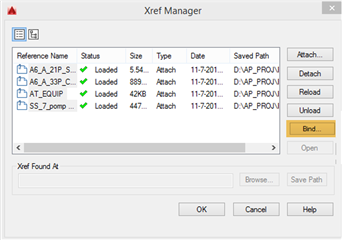

  1. Start your Xref Manager, select the files and click on “Bind” .
5. In the next dialog, check on Insert and click on OK.
 Your Xref Manager should not be showing you any files, so click OK to close.

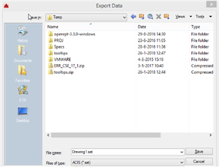

  1. Type in a command “EXPORT” and press enter.Select a location where the file must go, choose a filename and Select the file type ACIS (*sat). Click on Save.
