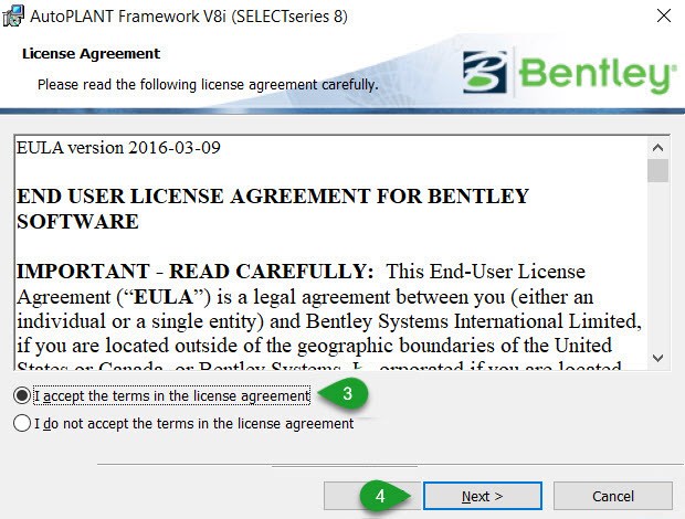

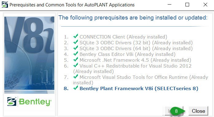

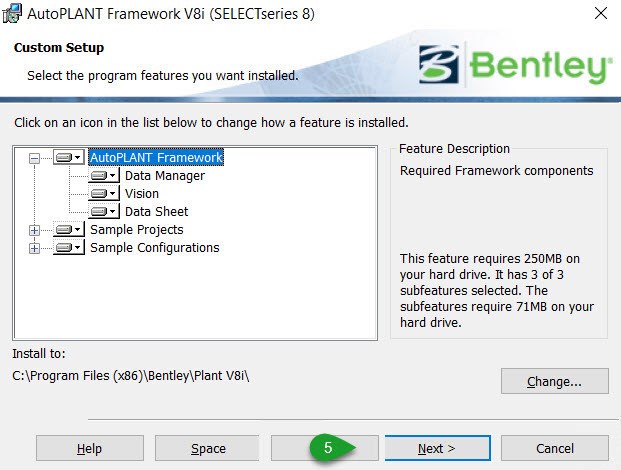

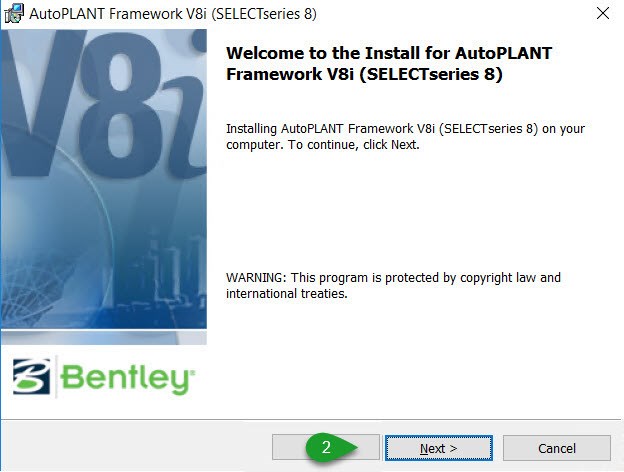

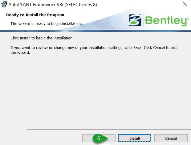

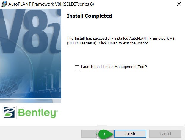

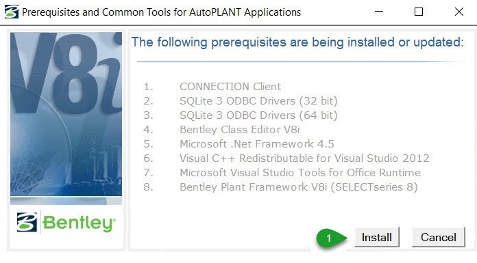

  3. Install AutoPLANT Prerequisites (apr64081113211.exe). We will go through the following Dialog boxes one after another.
    • Prerequisites and Common Tools for AutoPLANT Applications are required to be installed prior to any of the AutoPLANT product.
    • The prerequisites pack comprises of SQLite 3 ODBC Drivers, Bentley Class Editor, Microsoft .Net Framework 4.5, Microsoft Visual Studio Tools for Office Runtime, CONNECTION Client and Bentley Plant Framework V8i.
  4. Reboot the Machine (It is mandatory to restart the machine after installation of Prerequisites and Common Tools for Bentley AutoPLANT Applications)
    • It is mandatory to restart the machine after installation of Prerequisites and Common Tools for Bentley AutoPLANT Applications
    • User may delay the restart till any/all AutoPLANT V8i product installations.
    • AutoPLANT applications will not work properly if the machine is not restarted after the installations

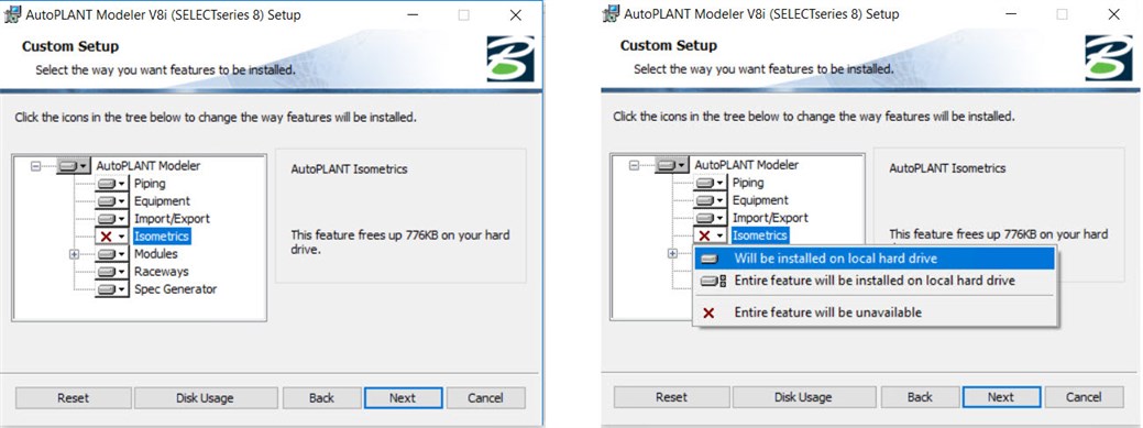

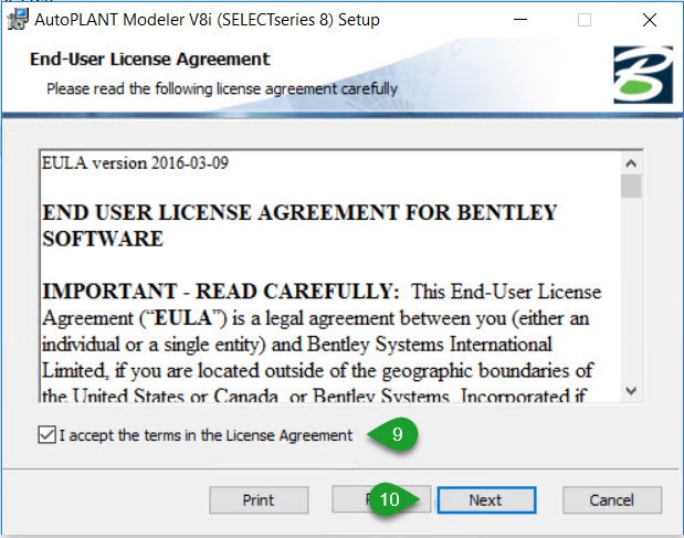

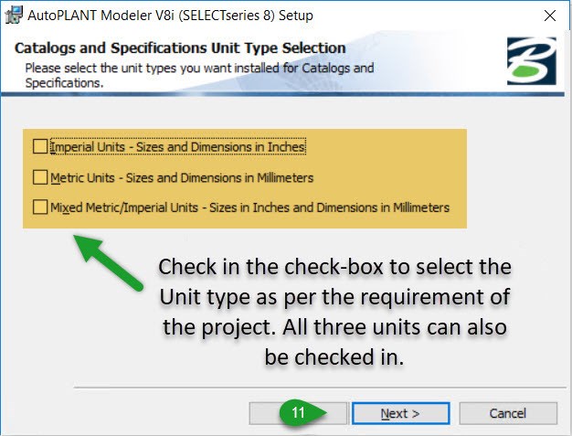

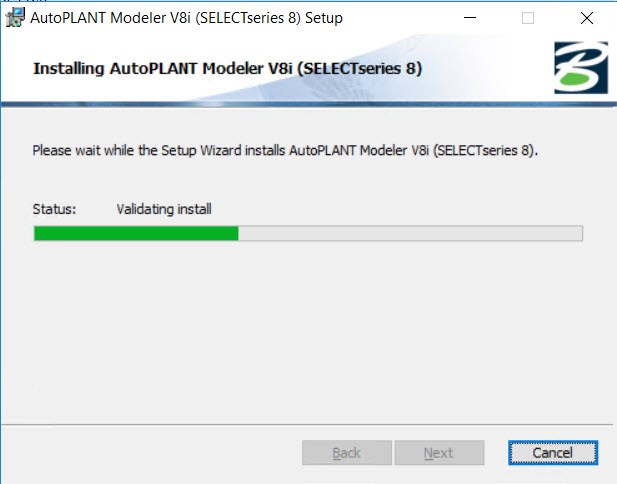

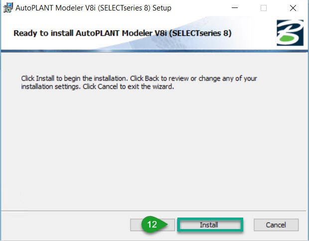

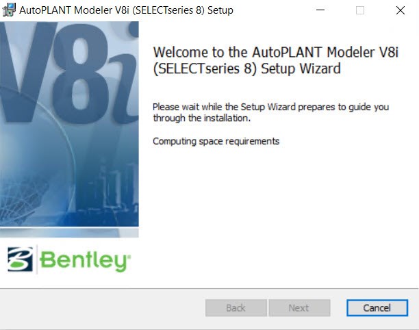

  5. Install AutoPLANT Modeler (apm64081113211.exe). We will go through the following Dialog boxes one after another.
    The Dialog Box that appears in the left image is the one that appears as Default. But if the Users wants to install AutoPLANT Isometrics then select Isometrics as shown in the Image shown on the right side.

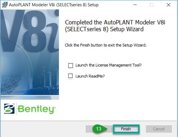

  6. AutoPLANT Modeler will be installed successfully.
