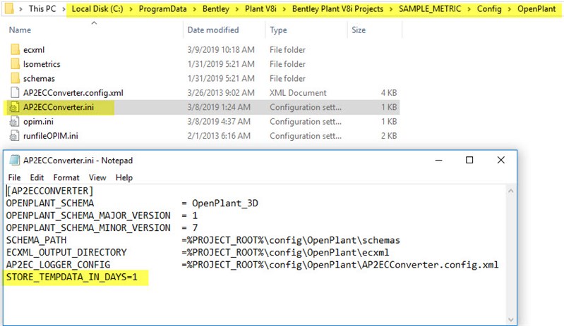

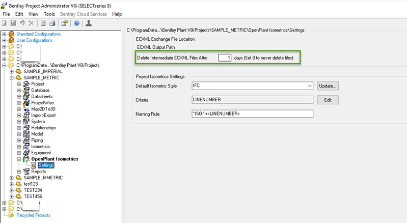

How to delete Ecxml files after certain periods
When processing isometric, Isometric generation process creates Ecxml files.
Ecxml for generally use to analyze the cause of error arise while, processing isometric.Saturated such Ecxml files increase project size, which further effect on Isometric Generation process as we well Project Packaging process.
Following setting helps to delete Ecxml files after specific period.
Below variable can be added in ‘AP2ECConverter.ini’ file located on project location,
Ex: C:\ProgramData\Bentley\Plant V8i\Bentley Plant V8i Projects\SAMPLE_METRIC\Config\OpenPlant
STORE_TEMPDATA_IN_DAYS=1
