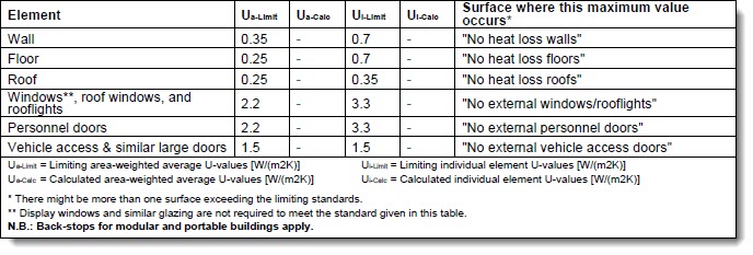

If you are considering a zone with no heating or cooling, the SBEM calculation engine will not check U values.

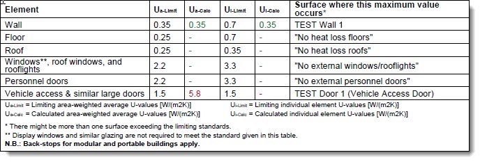

With HVAC defined:
U value checks are carried out
Without HVAC defined:
U value checks are not considered
