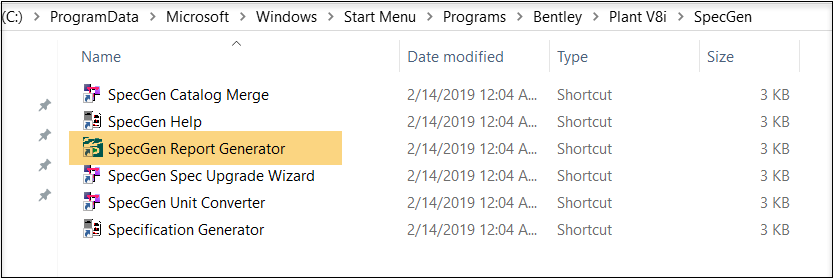

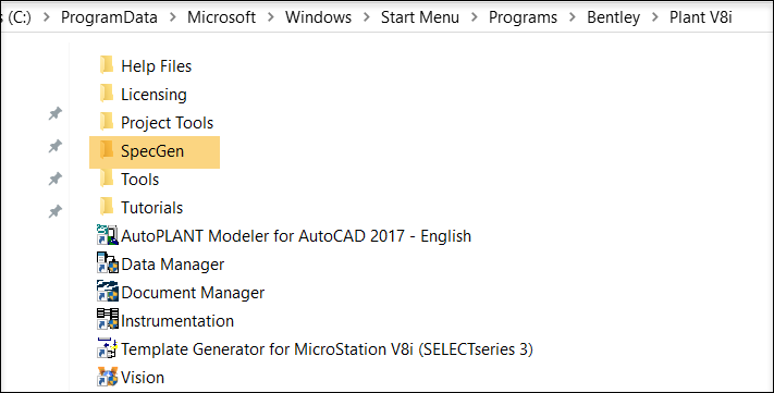

1.  Select SpecGen.
2. Click on SpecGen Report Generator

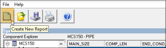

4. Create a new report
5. Go to File and select New Report option

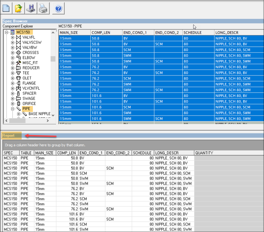

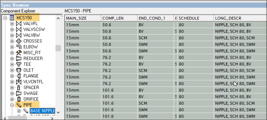

6. Select Spec as per your requirement and select the component for which you want to generate report.
7. Select the component sizes as per your requirement to Generate Report
8. Select Create New Report option and save the report

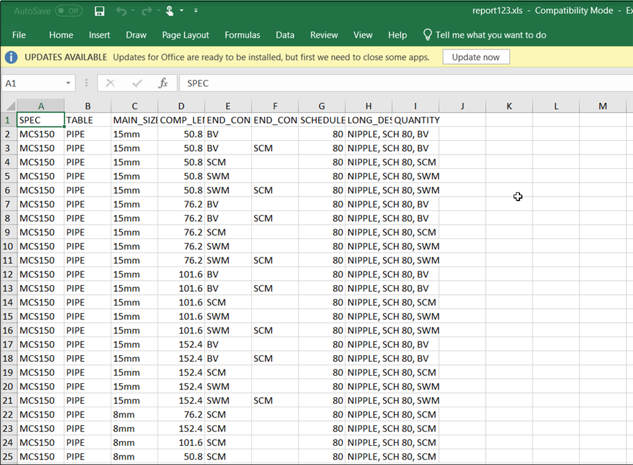

9. We can see the Generated report in Excel File
