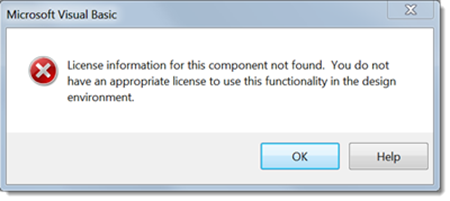

"License information for this component not found"
 Version(s):V8i
 Area:General
 Subarea:Errors
After installing AECOsim Building Designer, the following error message is displayed when trying to open a file:
Please note that resolving VBA problems may require the intervention of your IT support teams or services as these are primarily Windows system matters. Some level of administrative permission is needed for most of the potential solutions.
The following are potential solutions to this issue:

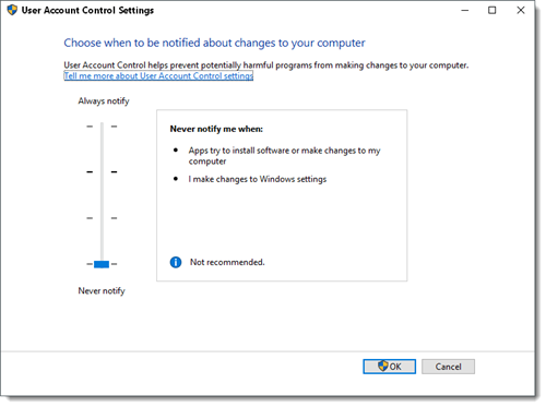

  1. Re-Install AECOsim Building Designer using recommended methods i.e. User Account Control must be set to "Never" and you also must have administrator rights to install the program.
