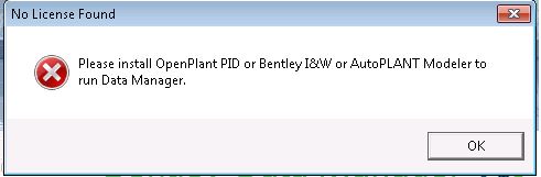

Message Please install OpenPLANT PID or Bentley I&W or AutoPLANT Modeler to run DataManager
 Product(s):Bentley DataManager
 Version(s):V8i
 Environment: N\A
 Area: N\A
 Subarea: N\A
 Original Author:Brandon Moberg, Bentley Product Advantage Group
Error - No License found - when opening Data Manager. Even though OPPID and I&W are installed.  The application is licensed and working the user will receive the following message when opening DataManager:

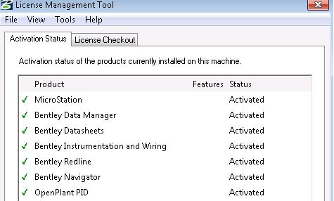

This happens even when the licenses in the License Mangement Tool appear to be activated and working properly as shown below:
Cause: The framework installation and the Bentley application are mismatched.  Meaning that one doesn't support the other.
Solution:  Verify that the version of I&W or DataManager or OpenPLANT PID supports the version of Framework installed on the workstation.  If it doesn't uninstall and reinstall with the correct versions.
