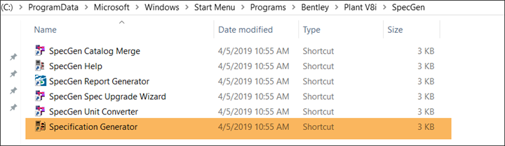

2. To launch Specification Generator, Go to SpecGen and select Specification Generator.

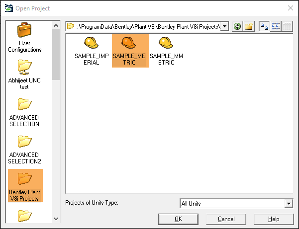

3. Select desired Project as per your requirement.

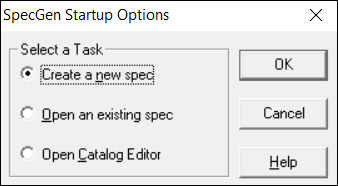

4. To Create a new spec, enable this radio button as shown in the dialog below, then press OK

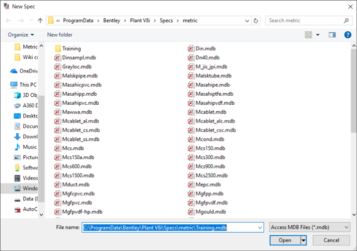

5. The New Spec dialog displays as shown below. Navigate to the directory for your spec to store and type file name as shown below and Press Open to create the spec database file.

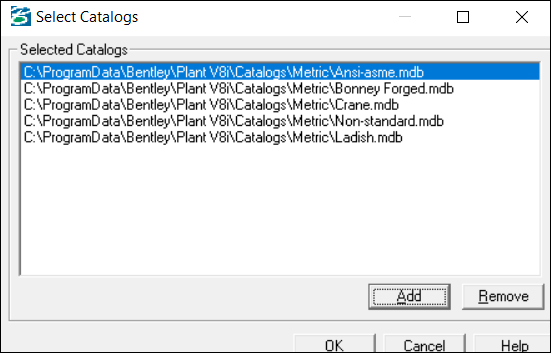

6. This dialog enables you to select the catalog database from which to build your specification and press add a catalog to the Selected Catalogs list. Once you have the desired catalogs selected.

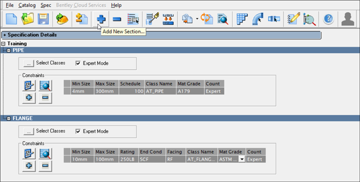

7. A specification is created by adding a series of spec section definitions and defining the constraint for each. SpecGen will create your spec by extracting records from the selected catalogs based on the constraints defined for these sections.

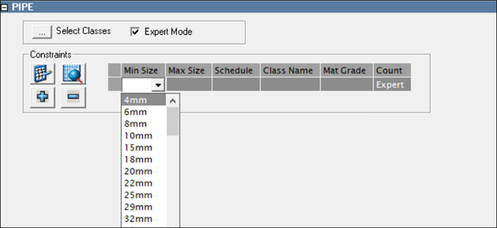

8. You can define the constraints that will be used to extract records from the catalog and add them to your spec database when you build the spec.

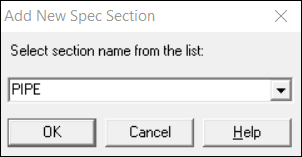

9. Continue to add sections to your spec by executing the Add New Section command and selecting the desired section from the list.

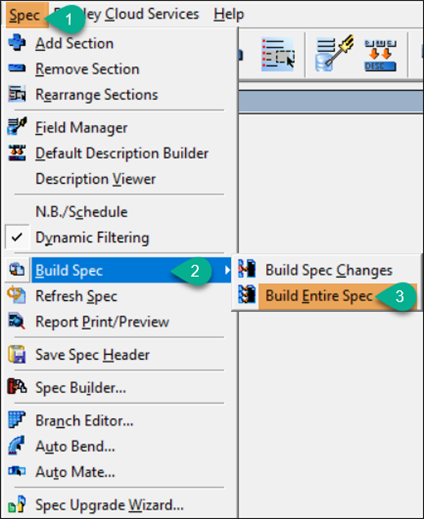

10.  When finished adding sections and defining the constraint for each, select Specs > Build Spec > Build Entire Spec to build your specification.
11.  The following dialog is displayed to indicate that the spec was built successfully.
