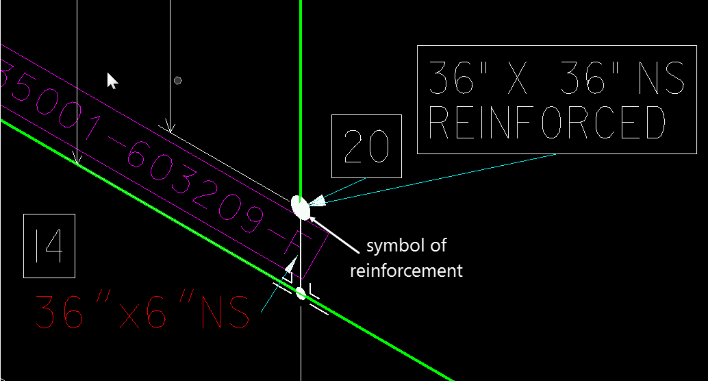

By default, OpenPlant Isometrics Manager does not report the reinforcing pad in the generated output of the OpenPlant Isometrics Manager and is not included in the Bill of Materials. We need to make some schema changes to achieve that. The changes mentioned in the schema allow us to achieve both the requirements.

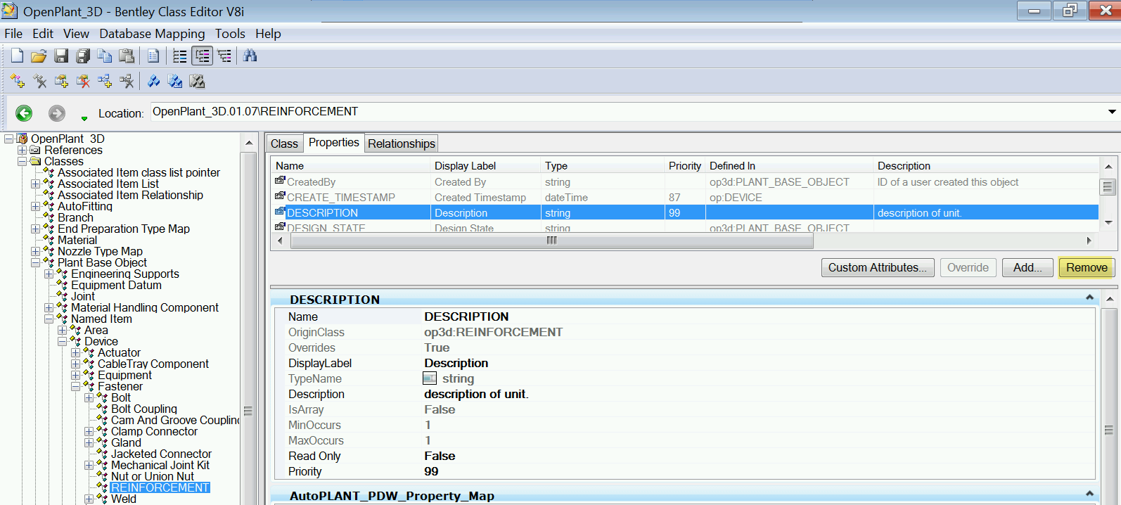

  1. Open Bentley Class Editor Utility.
  2. Open the 'OpenPlant_3D.01.07.ecschema.xml' file.

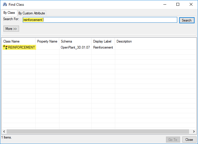

  3. Search for 'REINFORCEMENT' class.
  4. Go to properties tab select 'DESCRIPTION' click on Remove button.

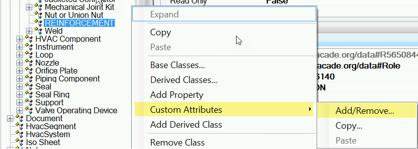

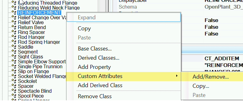

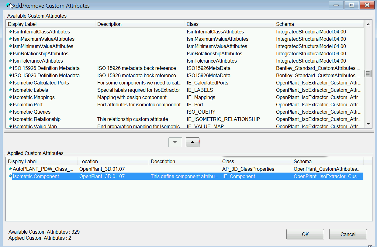

  5. Highlight the REINFORCEMENT class, right click and select the Add/Remove from Custom Attributes. Remove the Isometric Component Custom Attribute.

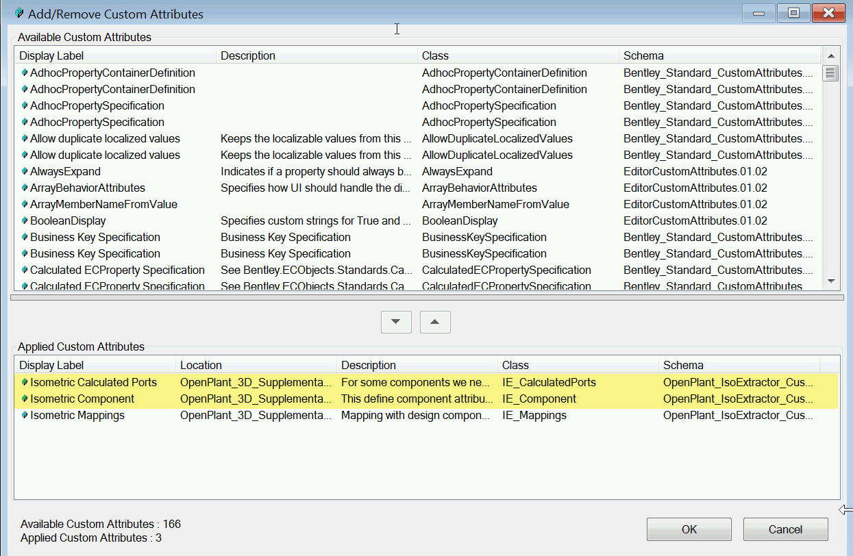

  9. Add Custom Attributes Isometric Calculated ports, Isometric Mappings.
  10. Add the following information in the Isometric Component.

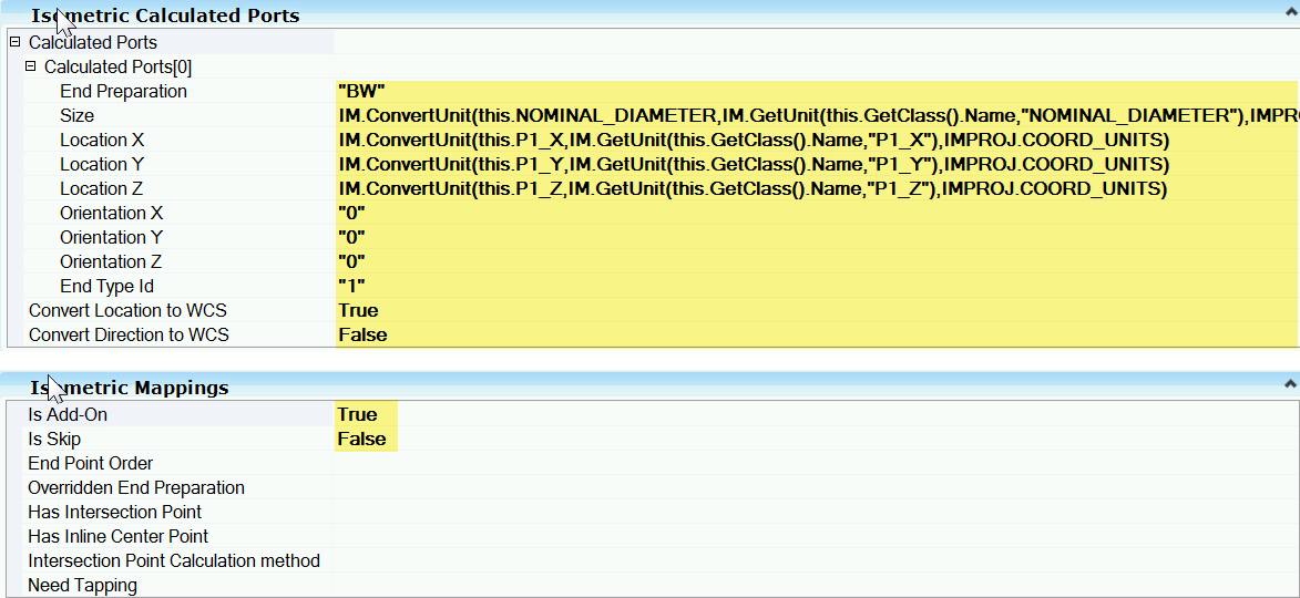

  11. Add the following information in Isometric Calculated Ports.
    End Preparation              “BW”
    Size                           IM.ConvertUnit(this.NOMINAL_DIAMETER,IM.GetUnit(this.GetClass().Name,"NOMINAL_DIAMETER"),IMPROJ.BORE_UNIT)
    Location X                                  IM.ConvertUnit(this.P1_X,IM.GetUnit(this.GetClass().Name,"P1_X"),IMPROJ.COORD_UNITS)
    Location y                                   IM.ConvertUnit(this.P1_Y,IM.GetUnit(this.GetClass().Name,"P1_Y"),IMPROJ.COORD_UNITS)
    Location Z                                   IM.ConvertUnit(this.P1_Z,IM.GetUnit(this.GetClass().Name,"P1_Z"),IMPROJ.COORD_UNITS)
    Orientation x                    “0”
    Orientation y                    “0”
    Orientation z                    “0”
    End Type Id                      “1”
    Convert location to wcs                True
    Convert direction to wcs              False

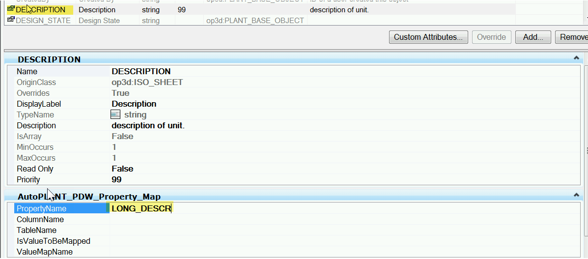

  13. Open the reinforcement class, select the description property and click on override.

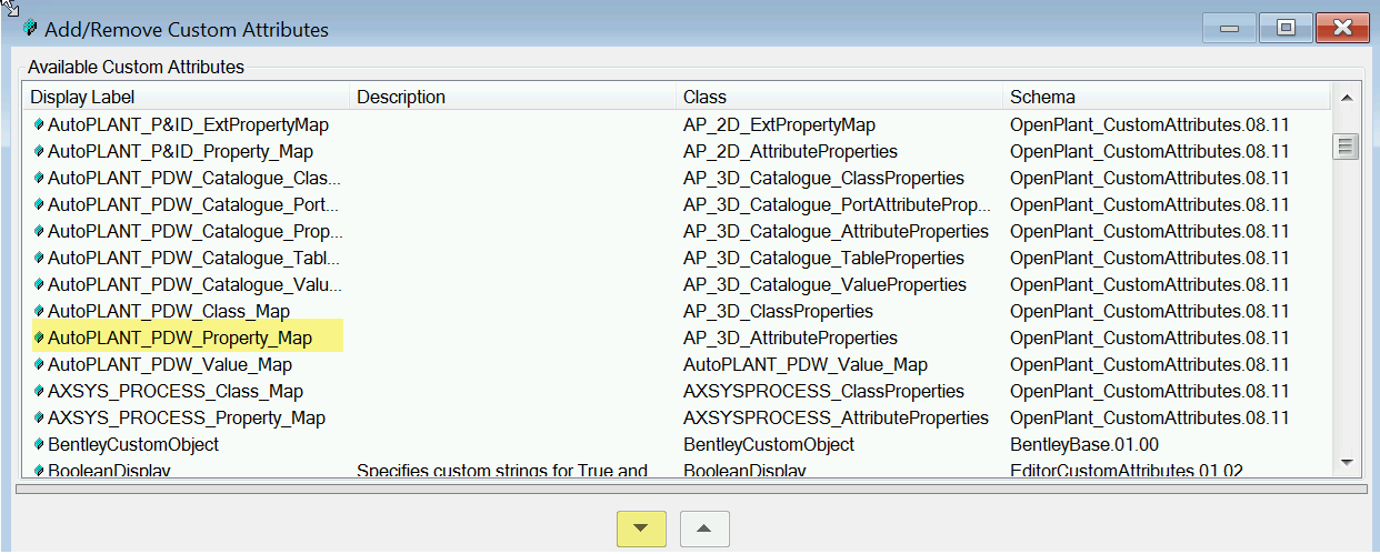

  14. Add a custom attribute AutoPLANT_PDW_Property_Map.
  15. Give the property name LONG_DESCR.
  16. Save the schema and generate the isometric to review the result.

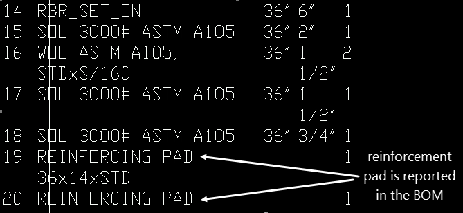

    As seen in the image above the reinforcement pad is reported in the isometric and listed in the Bill of Materials.
