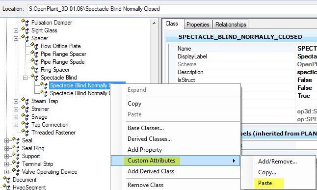

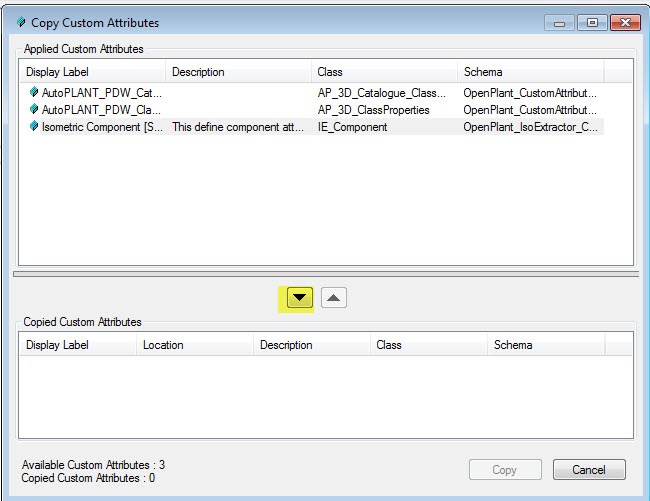

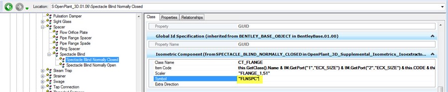

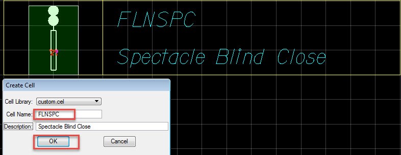

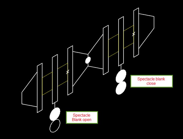

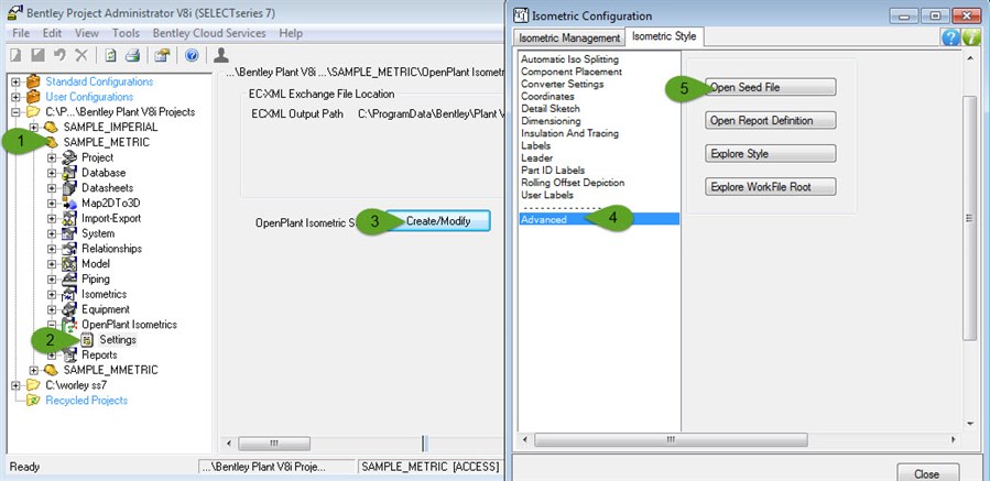

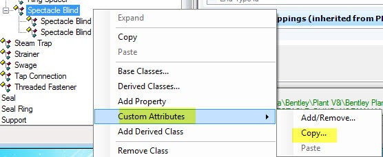

By default, Output of Spectacle Blank Open and Spectacle Blank Close symbols are denotes with same symbol in isometric. If user want to show Different symbols following illustrative steps will help to achieve desired result.
Problem Description

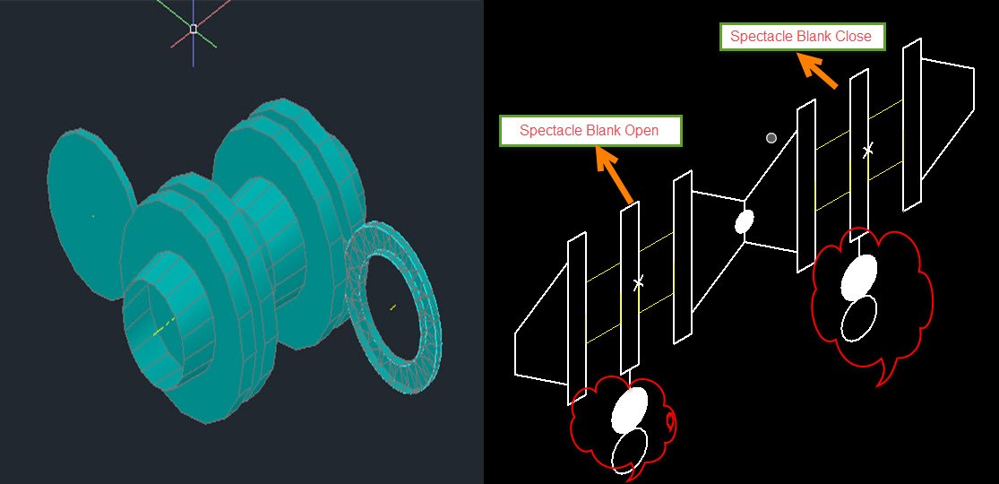

When generate isometric for Spectacle Blank Open and Spectacle Blank Open symbol show following symbol.
Current Result:
Expected Result:
