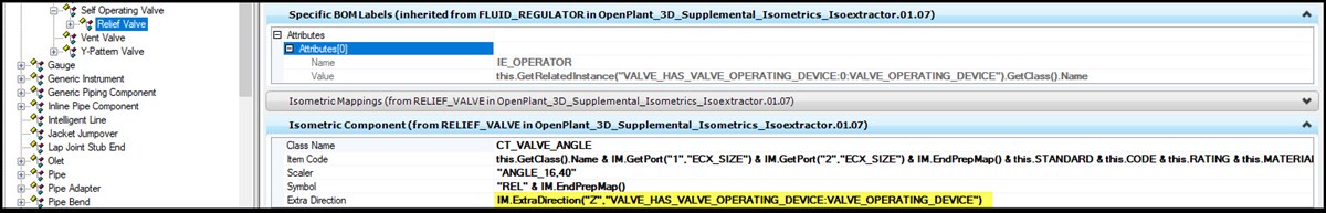

Relief Valves have inlet and outlet with Relief Operator following the direction of the inlet, mostly pointed to the Z-direction. OpenPlant Isometrics Manager has a Relief Valve following the direction of the inlet, mostly pointed to the z-direction.

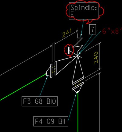

OpenPlant Isometrics Manager has Relief valve symbol including the Relief Operator and is always correctly oriented based upon inlet and outlet port information. Representation of additional operator symbol and operator directional label Is not required in generated isometric.
Following illustrative steps helps to remove extra operator and directional user labels.
Current Result:

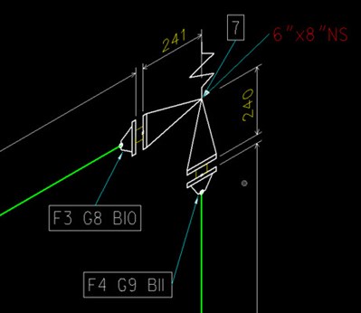

Expected Result

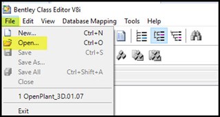

  1. Open Bentley Class Editor from Desktop.
  2. Go to File> Open

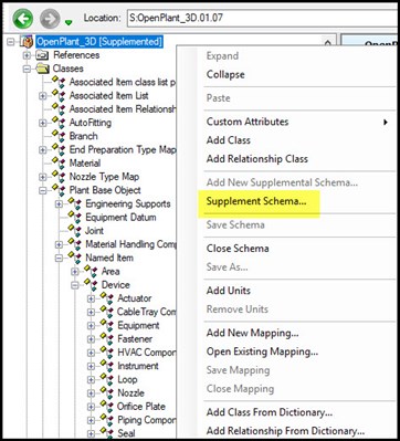

  3. Navigate to project path and open OpenPlant_3D.01.07.ecschema.xml.

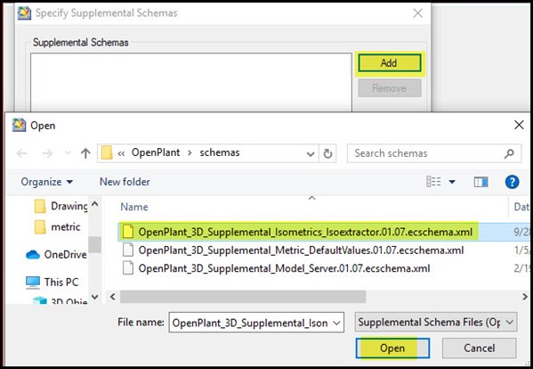

  4. Supplement with OpenPlant_3D_Supplemental_Isometrics_Isoextractor.01.07.ecschema.xml.

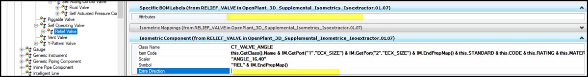

  5. Search for Relief Valve class.
  6. Remove Extra direction expression from Isometric Component.

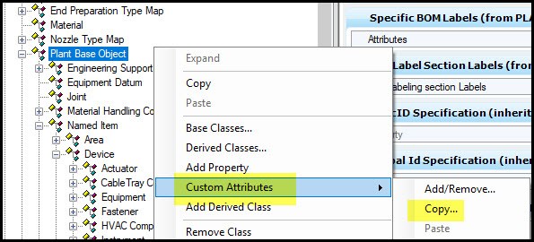

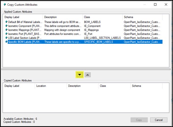

  7. Go to Plant Base Object class. Right click Custom Attributes > Copy
  8. Select Specific BOM Labels. Click on down arrow and click Copy tab.

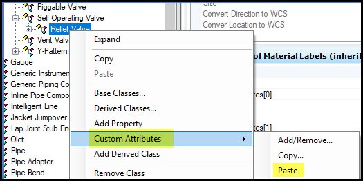

  9. Right click on Relief Valve class. Custom Attributes> Paste.
  10. After modification schema will look like as per below image.
  11. Save the schema and generate isometric to review the result.
