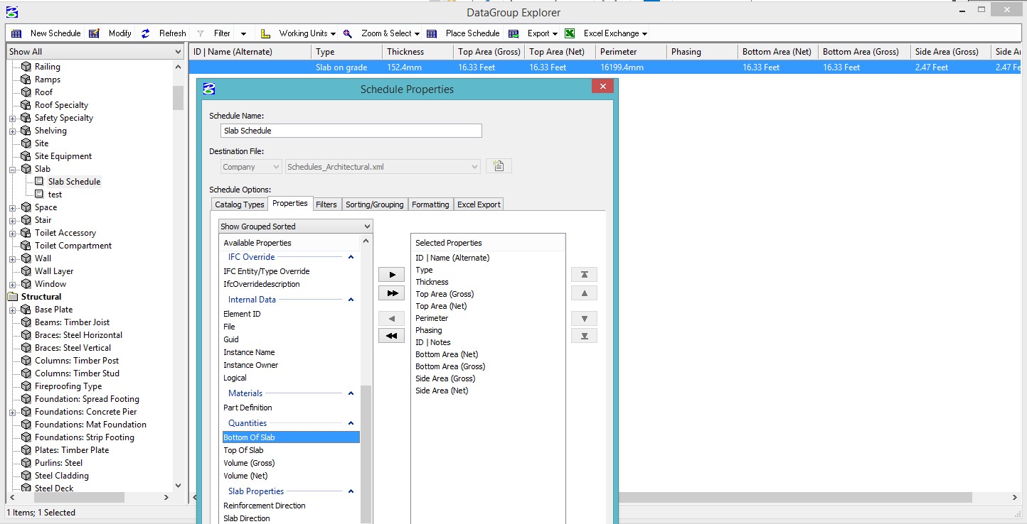

You can determine the total area of united slabs in a 3D model
Steps to Resolve
From the "Quantities" tab in the Building Element info box, select the "Feature Booleans" to see the total area of the united slabs.
It is also possible to see the total from the Datagroup Explorer, from Schedule properties select these options to be added to the Schedule then the total will display in the report.
