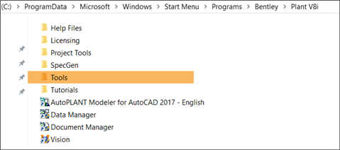

1. Click on Bentley Plant V8i icon available on desktop.

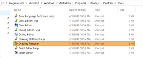

2. To launch Drawing Flattener, Go to Tools
3. Select Drawing Flattener

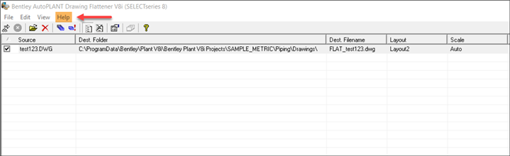

4. To get more information on drawing flattener check Help file.

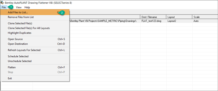

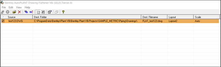

5. Select DWG file for which we want to create flattening from the Source. Go to File > Add Files to List
6. Drawing file is attached.

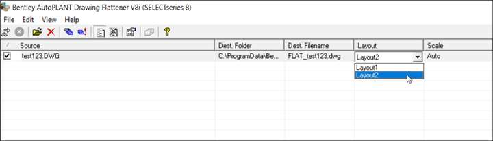

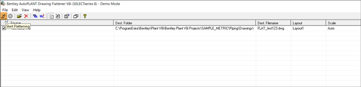

7. Select the layout that you want to use to create your flattened drawing.

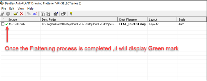

8. Click on Start Flattening option to start flattening process.
9. Once the Flattening process is completed, it will display a Green mark in front of the file name. See below image.

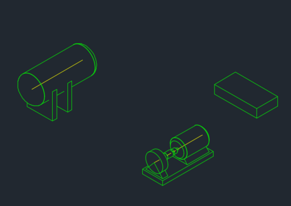

10. Check the final output at the destination folder.
