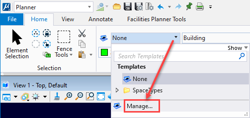

In order to use required settings for shapes, we should create Element templates for each Space type.
  1. Select on Element Templates Drop-down and select to manage all
  2. In opened Element Templates Dialog create new group and then new templates required for new Space types

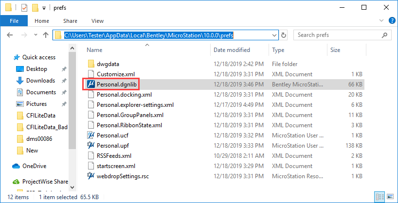

  1. Go to users perfs directory and open Personal.dgnlib file
    C:\Users\Tester\AppData\Local\Bentley\MicroStation\10.0.0\prefs

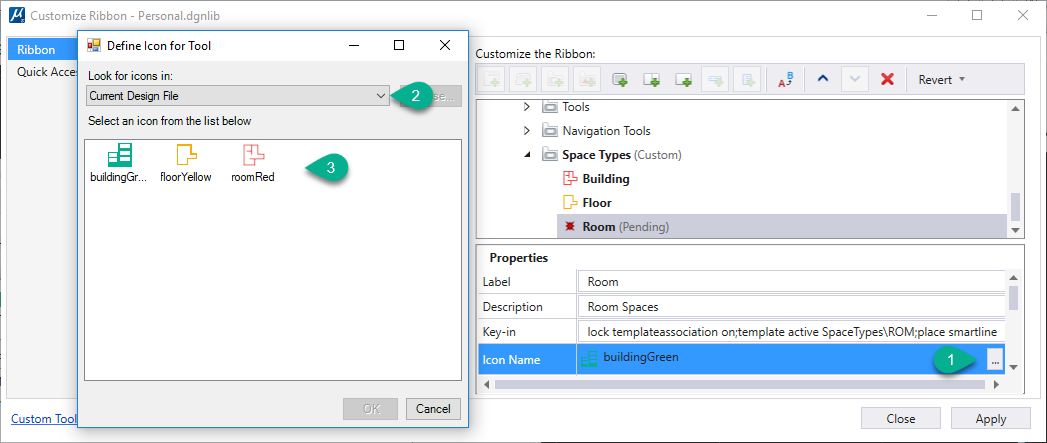

  2. When File is opened type in Customize in search and select it to open Customization dialog
  3. In Opened dialog select on icons section and Import your icons
  4. I have tested with *.ico and *.bmp files bth types were imported fine.

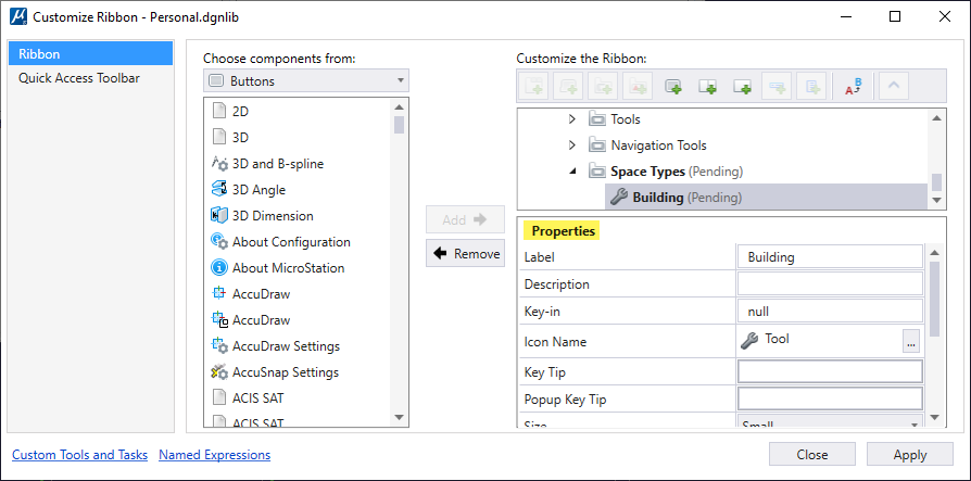

  1. In same Customize dialog select Utilities > Customize Ribbon option
    The Customize Ribbon dialog opens.
  2. In the list below "Customize the Ribbon", navigate to the desired workflow, tab, and add new group Space Types in which new buttons for different Space types will be added.
  3. In newly added group Space Types, add new buttons.
  4. In the Properties section, set Label, Description and the Key-in field

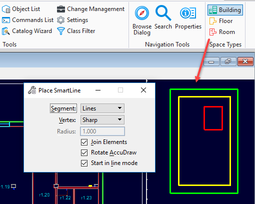

    In Key-in field enter value that will set required Element Template and will select to use Smartline tool to draw new Shapes. Below are Key-ins which will be required for such combined Key-in operation.
    lock templateassociation onKey-In to set the Active Element template
    template active SpaceTypes\BLDKey-In to set the Element template Association with BLD template on SpaceTypes group
    place smartlineKey-In to set Smartline tool
    Key-Ins can be combined using semicolon separator and used for required custom button

  5. Now to change the icon, in the Icon field, click the Browse button on the right-side, select to look for icons in Current Design File and choose required one.

Now test new Buttons and verify
