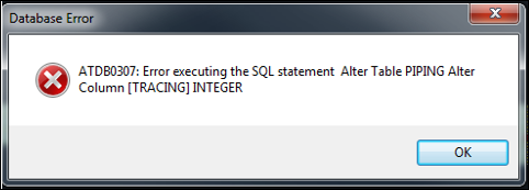

ADTB307: Error executing the SQL statement Alter Table PIPING Alter Column INTEGER

In AutoPLANT Modeler while placing pipe user may following error
Problem Description
When using SQL/Oracle data base with AutoPLANT Project and select distributed Project mode instead of Central Mode user may face this issue.
For ORACLE & SQL Databases Project Mode should be Central Mode and for Access Database you can select Distributed Mode.

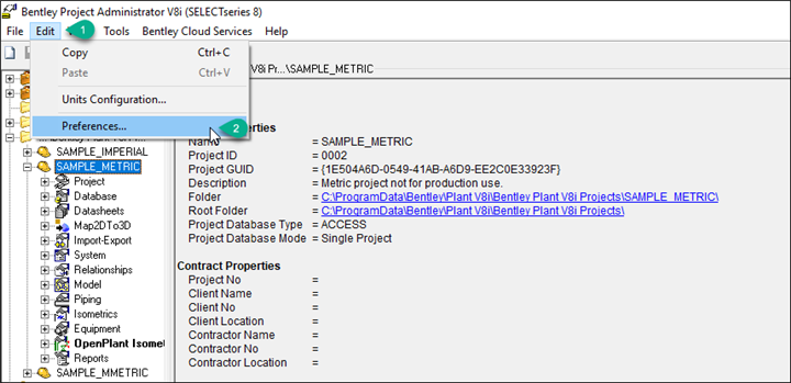

1. Open the Project Administrator and select the Project
2.Go to Edit and select Preferences

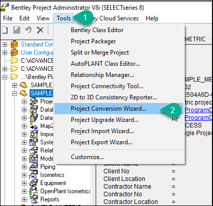

3.Go to Tools and select  Project Conversion Wizard

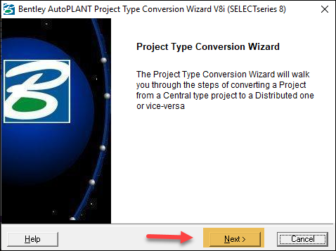

4.Convert the Distributed Mode to Central Mode

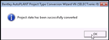

5.Project State will convert
