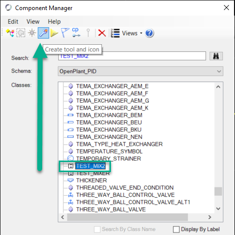

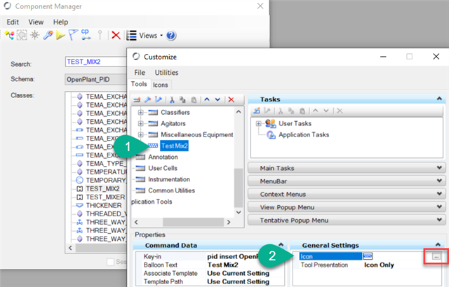

3. After conversion, Open OpenPlant PID and go to Component Manager. Select the desired Custom Equip Class to edit & hit “Create tool & icon” option.

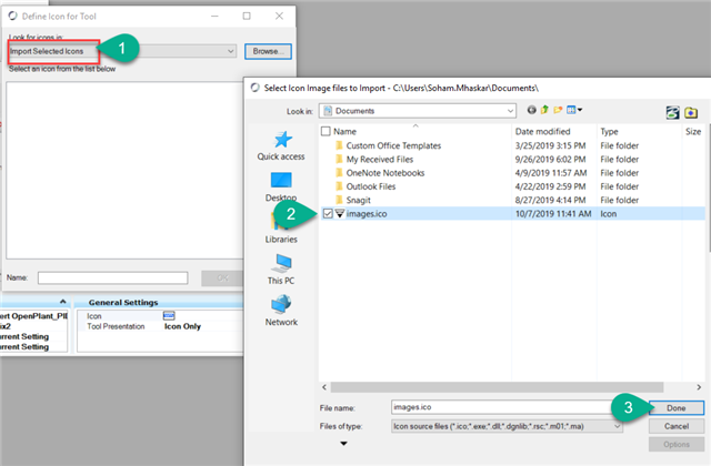

4. Select Custom Equip and browse for Icons in General Settings.

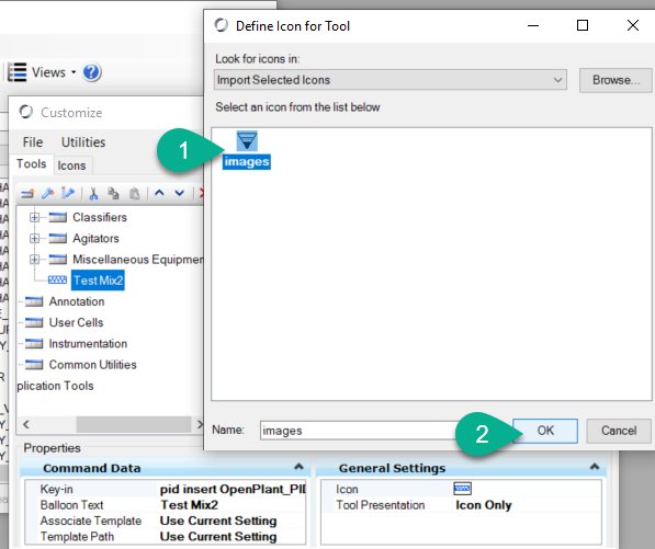

5. Select “Import Selected Icons” option, browse and select .ico file.

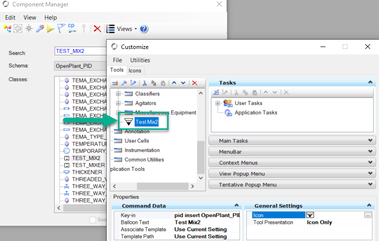

6. Once Selected, Icon appears. Select Icon and hit OK to get it reflected in OPPID.
7. Once done, desired result as shown below is obtained.
Hence using this, different Icons (choice based) irrespective of the custom Equipment Shape can be obtained.
