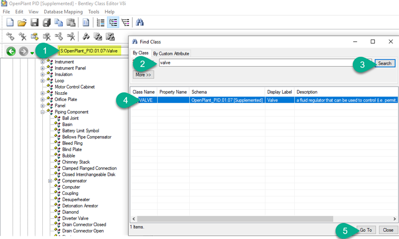

1. Open OpenPlant PID 01.07 schema (of corresponding Project) & supplement it with Supplemental_Imperial schema and search for “Valve” class.

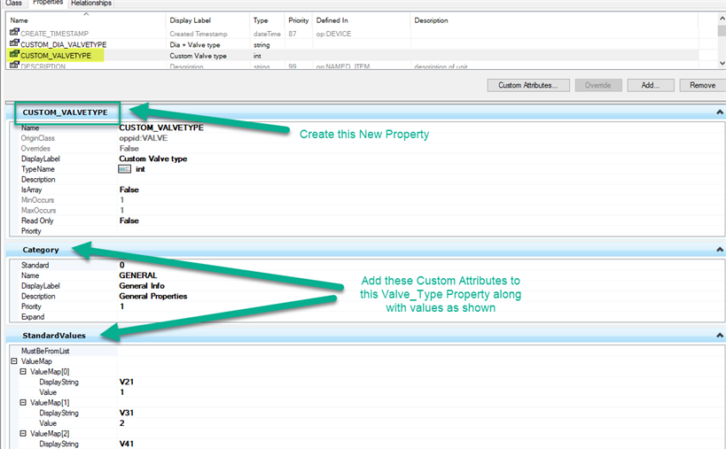

2. Create a new property “Valve Type” and add below shown Custom Attributes.

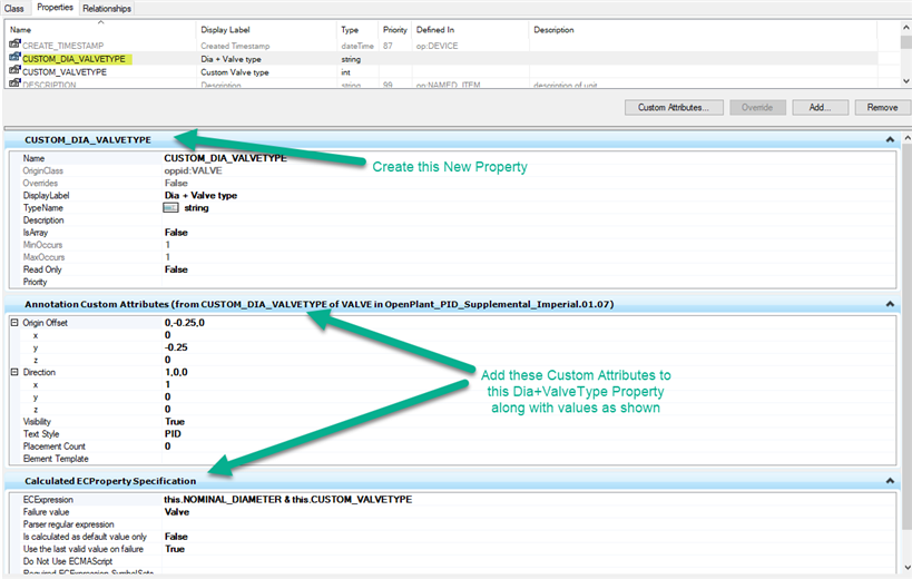

3. Create a new Property “Custom Dia+Valve type” and add Custom Attributes as shown below.

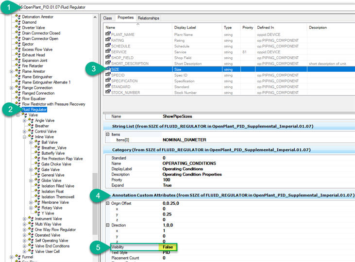

4. Follow the below Steps to get rid of the Size annotation on top of valve.

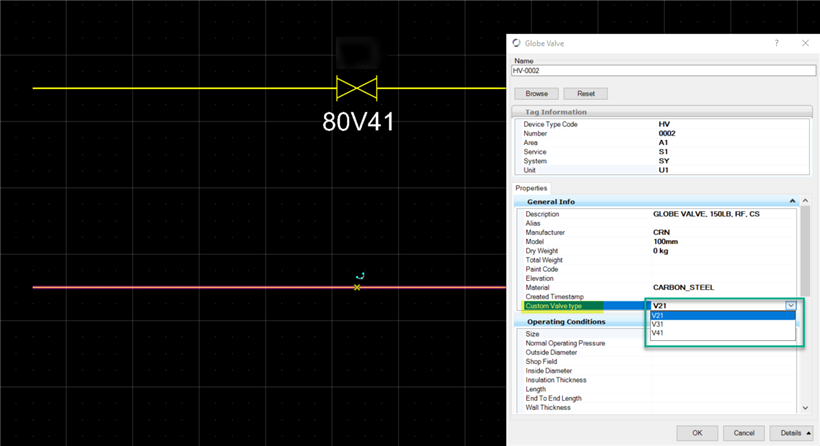

5. Open OpenPlant PID & Try to Place any valve as shown below by editing New Property which is “Valve Type”.

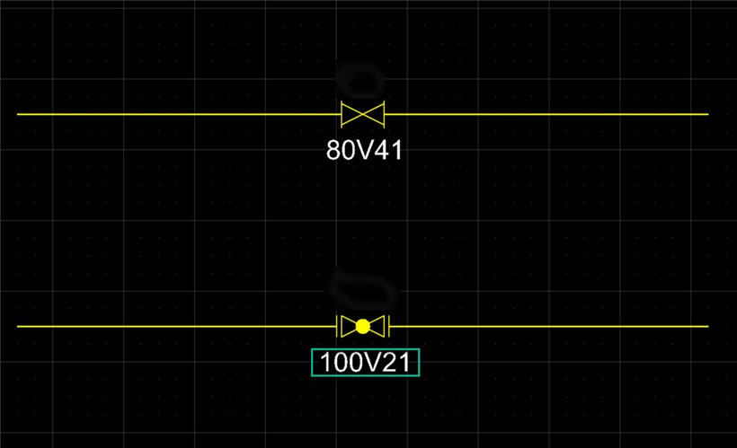

6. Below You can see, we placed a Gate valve & a Globe Valve with the Annotation Tag of your requirement.
