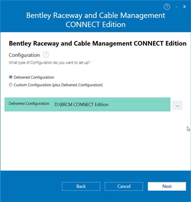

In case of Bentley Raceway and Cable Management (BRCM) CONNECT Edition, there are two important installation paths.
1. Application Path
2. Delivered Configuration
With the default installation of BRCM CONNECT, the above paths are set into the C:/ drive
Application Path – “C:\Program Files\Bentley\Bentley Raceway and Cable Management CONNECT Edition”
Delivered Configuration – “C:\ProgramData\Bentley\BRCM CONNECT Edition”
But sometimes it may be necessary to change the directories in which BRCM gets installed. The below procedure will elaborate on how BRCM CONNECT can be installed on the D:/ drive. Same procedure can be adopted to install BRCM CONNECT at any desired location.
Note:
Before following the below steps navigate to the desired location where user wish to install BRCM CONNECT (In this case the D:/drive) and create two new folders with the names “Bentley Raceway and Cable Management CONNECT Edition” and “BRCM CONNECT Edition”
1. Run the setup of BRCM CONNECT
2. Select Configure
3. For the Application Path select the D:/ Bentley Raceway and Cable Management CONNECT Edition
4. For the Delivered Configuration select D:/ BRCM CONNECT Edition
5. Click Next till it comes back to the Main Installation page, where accept the License Agreement and continue with the Installation.
Verify the result by opening the software.
