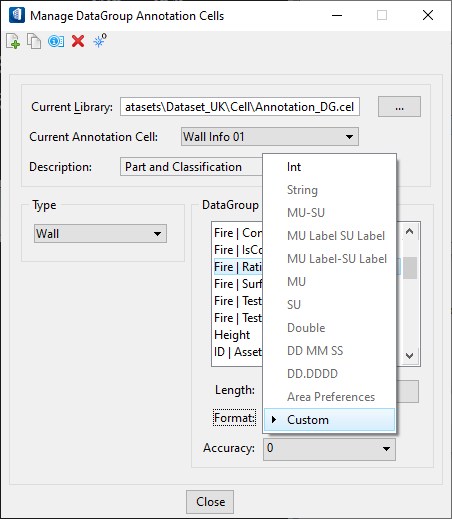

In the Manage DataGroup Annotation Cells dialog > DataGroup Information section you select and format the DataGroup Information that you would like to see in your DataGroup Annotation Cells.
So what if the format you want is not available or, if using an available format with values of variable length with following dumb text, results in uneven spacing or overlapping between the variable DataGroup Information and the dumb text?
Take a look at the Custom option:

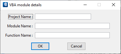

What goes in these blank fields is fairly obvious once you get to grips with the basics of the VBA Editor:

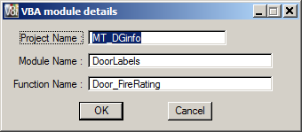

In this example, and it makes more sense backwards:
Click OK and use the Place Text button to add the text to your DataGroup Annotation Cell. Ensure that the Length is sufficient to contain the DataGroup value and any surrounding text.
So what is in the Function?

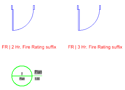

In this example I want to place a Label that has a prefix, 'FR |', the Fire rating of a door from the DataGroup, followed by a suffix.
The VBA code is:
Public Sub Door_FireRating()
    Dim DoorFR As String
    Dim DoorFRLabel As String
    DoorFR = KeyinArguments
    DoorFRLabel = "FR | " + DoorFR + " suffix"
    KeyinArguments = DoorFRLabel
End Sub

The Result:
'2 Hr. Fire rating' and '3 Hr. Fire rating' are values gathered from the NM Dataset. These values will vary between datasets.
