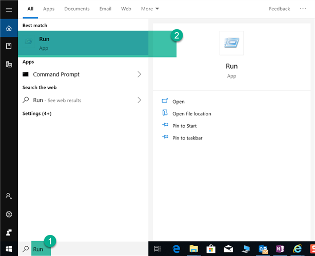

1.In the command line type in Run so that Run command dialog box opens.

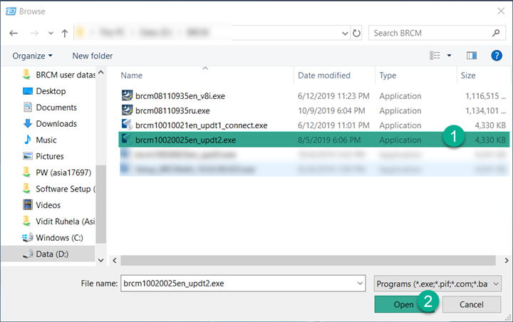

2.Click on browse to go to the location of the setup file of BRCM CONNECT.
3.Browse to the path of the setup file of BRCM CONNECT and click on Open.

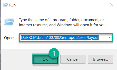

4.After the path of the setup file is added in the Run dialog box , add /layout after .exe in the open dialog box and click Ok.

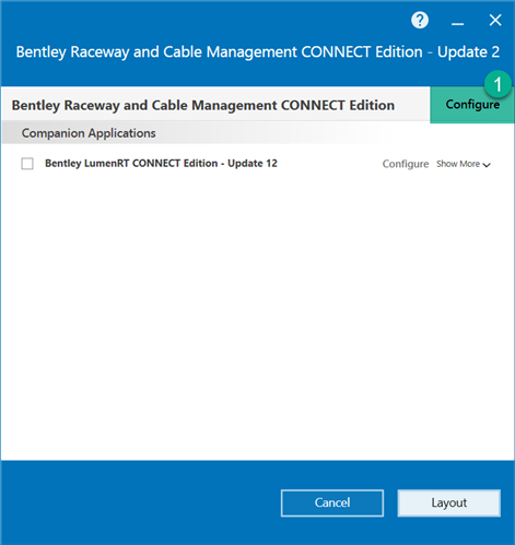

5. The BRCM CONNECT dialog opens. Go to ‘Configure’ tab. Its optional to install the companion features and applications.

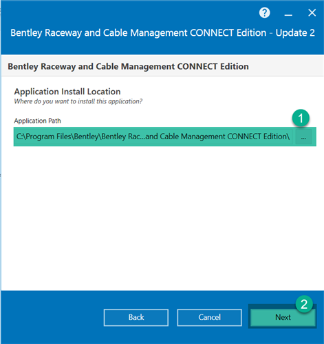

6.Select the installation location where the deployment image will get installed. Click on Next.

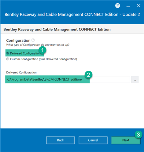

7.Select ‘Delivered Configuration’ option and then select the location of delivered configuration to be installed. Click Next.

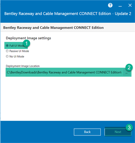

8.Select ‘Full UI Mode’, and then Select the deployment image location according to requirement and select Next.

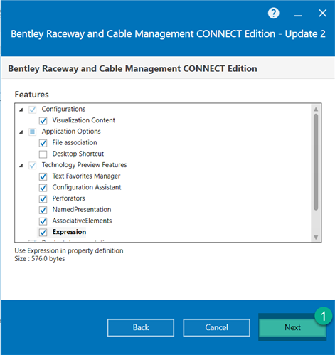

9.Select the Features and Click on Next.

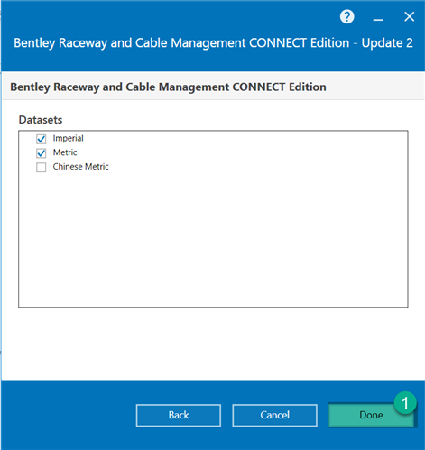

10.Select the Datasets for BRCM and Click on Done.

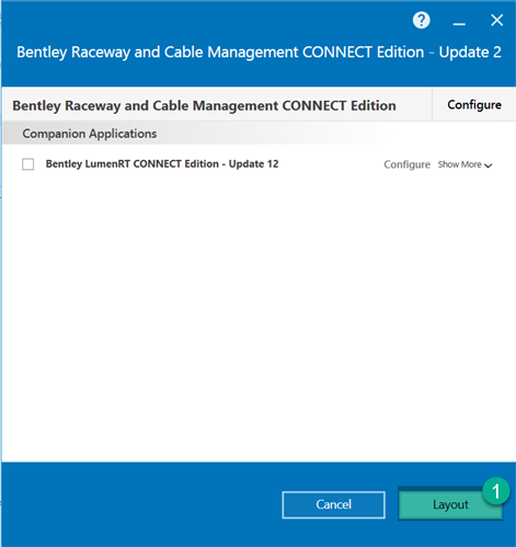

11.Click on Layout which will start creating the layout of the deployment image and download all the required files.

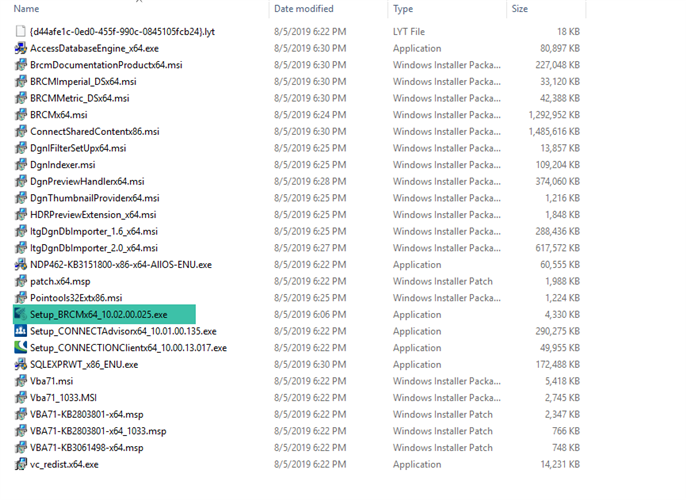

12. After completion of the download the deployment image will be created at the selected location.
      The resulting files will be similar to the following image displayed.
       Run the setup file to install the BRCM CONNECT software.
