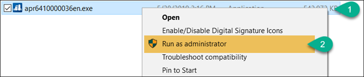

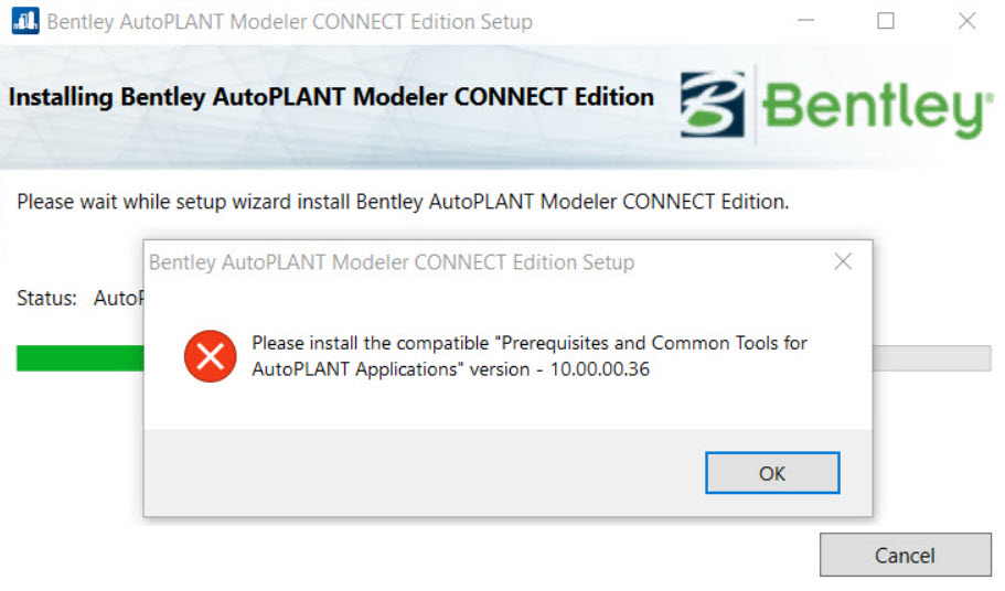

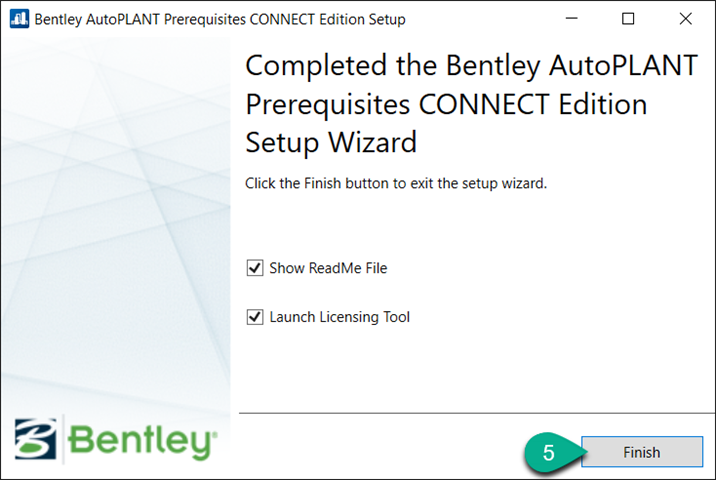

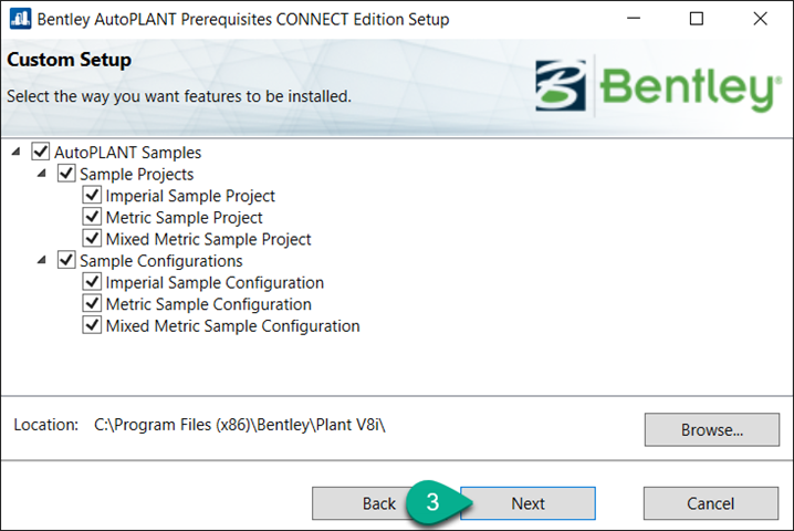

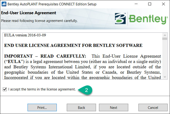

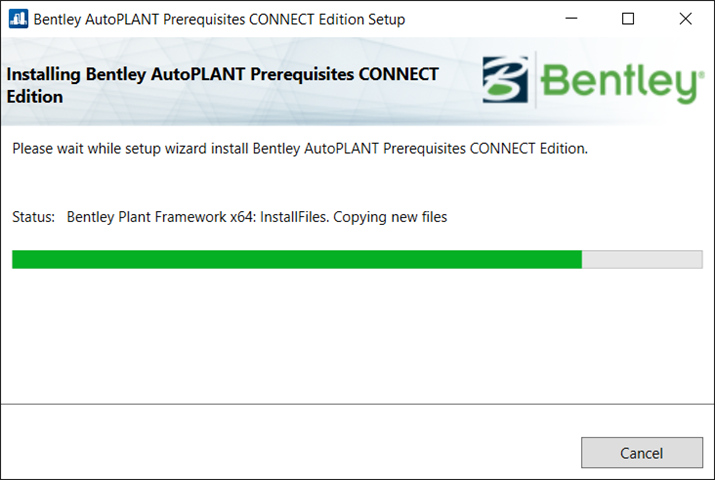

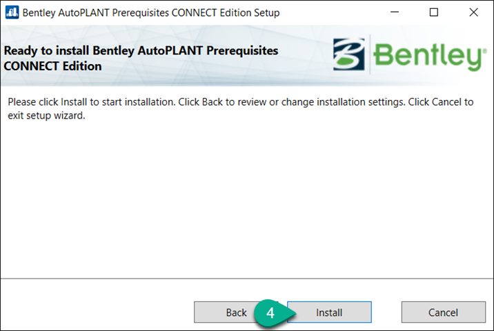

3. Install AutoPLANT Prerequisites CONNECT Edition (10.0.0.36). Please make sure that we run setup (install AutoPLANT Prerequisites CONNECT Edition.exe) "Run as Administrator" otherwise you will get error message while installing AutoPLANT Modeler CONNECT version.
Note: We do not need to run AutoPLANT Modeler CONNECT version as "Run as Administrator".

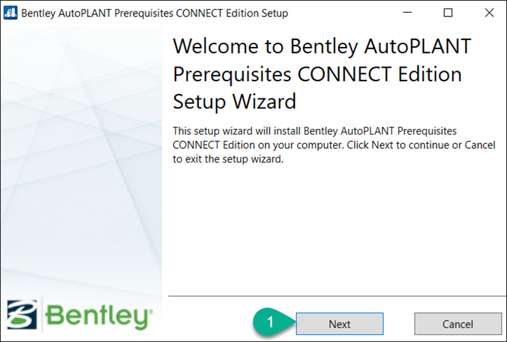

Below are steps needs to perform for installation:
Note: If we do not install AutoPLANT Prerequisites CONNECT Edition as "Run as Administrator" then we will get below error message.
The Prerequisites are required to be installed prior to the any AutoPLANT product and are not required prior to any subsequent AutoPLANT product installation.
The perquisites pack comprises of SQLite 3 ODBC drivers, Bentley Class Editor, Microsoft.Net Framework 4.5, Microsoft Visual Studio Tools for Office Runtime, CONNECTION Client and Bentley Plant Framework.

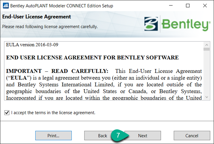

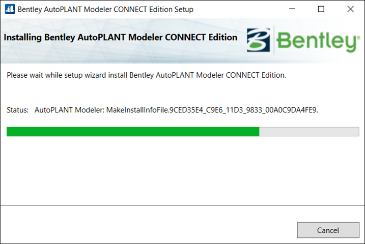

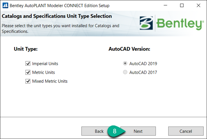

4. Install AutoPLANT Modeler CONNECT Edition (10.0.0.36). We will go through the following dialog boxes.
5. Check in the check box to select the Unit type as per requirement of project. Select the require AutoCAD version as per your requirement.
6. If user wishes to use AutoPLANT Isometrics then check on the indicated option as shown in below screenshot.

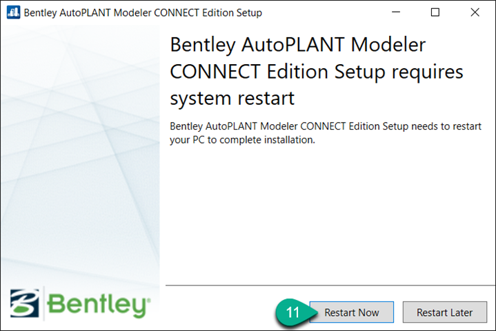

7. Once installation for AutoPLANT Modeler CONNECT is done, please restart machine.
Note: It is mandatory to restart the machine after installation & AutoPLANT Modeler will not work properly if the machine does not restart after the installation.
