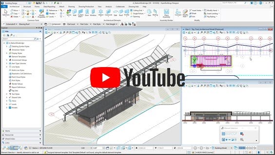

The Situation
How can I create my own Grid Template DgnLib so that I can maintain our company drawing standards?
Create a new GridTemplate.dgnlib and save it to the WorkSpace or WorkSet, then reassign the BB_GRID_TEMPLATE_DGNLIB configuration variable.
Grid Templates control the symbology of grids created using the Grid System Manager.  They are Element Templates that are stored in a delivered DgnLib.  This DgnLib can be copied to a WorkSpace or WorkSet, and then the Grid Template can be modified to match company or project standards. Once this is done, the configuration variable  BB_GRID_TEMPLATE_DGNLIB must be reassigned to point to the new location.
Links
    •  YouTube         •  OpenBuildings Wiki     •  OpenBuildings Help
Steps:
  1. Open the GridTemplate.dgnlib in the delivered Dataset_XX.
  2. Use Save As to save a duplicate copy to either the Workspace or WorkSet Standards/Dgnlib folder.
  3. Open the new DgnLib and modify the Element Template.
  4. Open the WorkSpace or WorkSet configuration file and add the variable and appropriate path as shown below:
BB_GRID_TEMPLATE_DGNLIB = $(_USTN_WORKSETSTANDARDS)dgnlib/GridTemplate.dgnlib
BB_GRID_TEMPLATE_DGNLIB = $(_USTN_WORKSPACESTANDARDS)dgnlib/GridTemplate.dgnlib
The new Grid Template will now be available in both the Floor Manager and the Grid Systems Manager under Settings.
