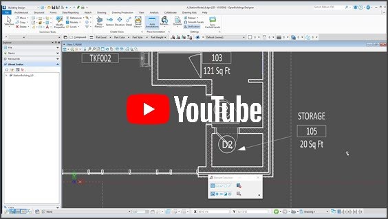

The Situation
Are you manually adding leaders to DataGroup annotations?
Save time annotating drawings by automatically generating leader lines on your DataGroup annotations.
Use the Create Leader Line option on the DataGroup Annotation rule to automatically generate leaders when the annotation is first generated or when it is moved away from the annotated object.
