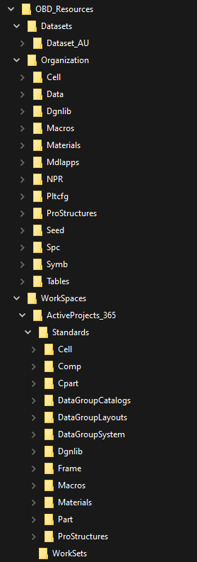

Shown below is a typical example where the Datasets are located in the Custom Configuration under ...\OBD_Resources\Datasets\; one WorkSpace named ActiveProjects_365 is contained in the WorkSpaces folder.
Datasets: Unless configured otherwise the Catalog User Interface will treat the active Dataset as the Organization level Organization level custom content may be stored here depending on the decision discussed above about use of delivered datasets. | |
Organization: Unless configured otherwise the Organization subfolders contain shared platform or ProStructures content directed to by Standards.cfg and some ProStructures CFG files. Any content here will be available to all users unless configured otherwise. There are no other OpenBuildings specific folders. | |
WorkSpaces: The Catalog Editor will recognize the WorkSpaces folder as the WorkSpaces level. Any content here will be available only to users of the active WorkSpace. |

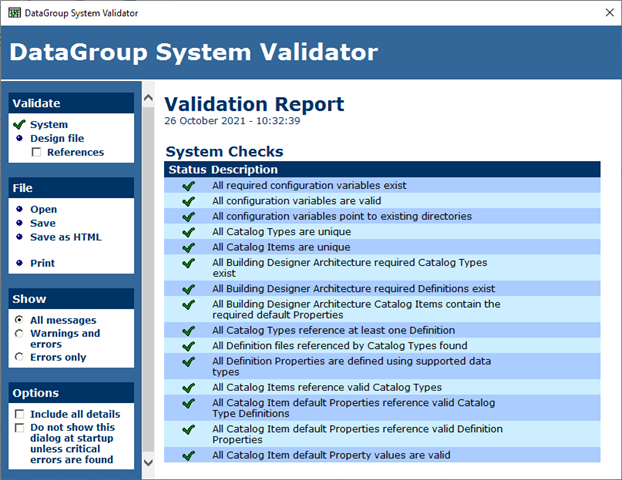

At this stage also run the Dataset Validator to ascertain the current state of the dataset. It will be easier to fix any errors before custom content is added. (File > Dataset Tools > Validate. Help: DataGroup System Validator)
An error free report at this point will confirm that the DataGroup Catalog is valid prior to the addition of custom content.

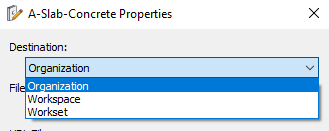

Add V8i files in the appropriate locations at Organization, WorkSpace or WorkSet levels.
Run the Dataset Validator again and fix any errors.

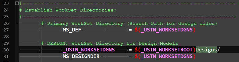

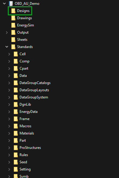

For example, in the example WorkSet CFG the default folder for design files is called 'Designs':
This is defined by the lines:
If the folder location is correct, but the name 'Designs' does not comply with project standards it can be renamed. The name 'Designs' in the _USTN_WORKSETDGNS statement must then be changed to match the new folder name. (This has to be done by text editing since we do not have a UI for such changes.)

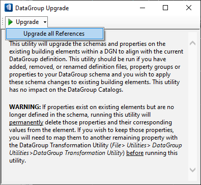

Any model files that contain building elements (these are typically all of the 3D model files in a project) must be synchronised with the new dataset using the Schema Upgrade Utility. This can be done to all files in one go as explained in Schema Upgrade Utility:
The utility should also be run on any existing BB_Floormaster.dgnlib. This may be successful, however as there have been significant changes to the internal structure of BB_Floormaster.dgnlib since V8i we cannot guarantee that BB_Floormaster.dgnlib content will be entirely valid. It may be necessary to recreate the floor and Grid Systems content.
2D files, generally drawing and sheets, do not contain building elements so do not need to be upgraded.

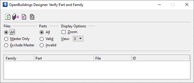

To use the Verify Parts utility the WorkSet will need to contain some DGN files (File > Utilities > Part Utilities > Verify Parts. Help: Verify Part and Family)

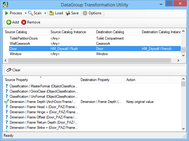

If models contain Catalog Items or Parts that are not present in the new dataset, the DataGroup Transformation Utility can be used to missing custom properties to delivered properties, and the Part utilities can be used to verify and where necessary remap parts to elements (help: DataGroup Transformation Utility):
If significant differences between V8i and CONNECT are apparent a mapping file can be built to apply to subsequent project to WorkSet migrations. This is a time saver when it comes to migrating multiple projects.
