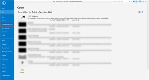

How to update the Server Copy Dgn on ProjectWise Explorer ?
Area:ProjectWise with OpenBuildings Designer
Problem Description:
How to sync ProjectWise Explorer or Check-in option in the file menu to update the server copy Dgn on ProjectWise Explorer to reflect the changes on ProjectWise Explorer and the user does not have to exit the Dgn or OpenBuildings Designer session ?
To get "Update Server Copy" option in OpenBuildings Designer, first would need to log into ProjectWise Explorer, once you open Dgn file from ProjectWise Explorer in OpenBuildings Designer, can able to see update server copy option. Once you click on the "Update Server Copy" all the prior changes will be updated in PW Explorer Datasource.
