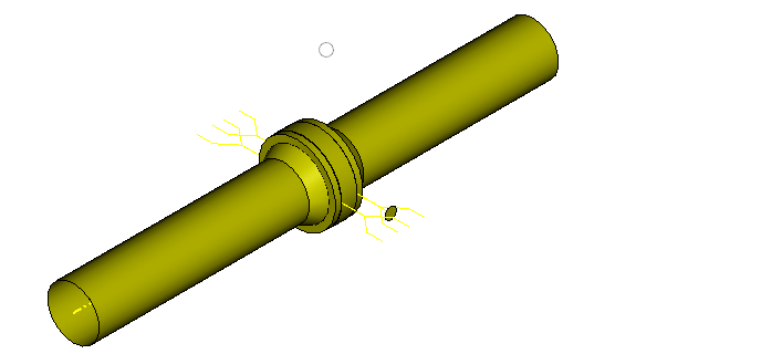

  1. Launch OpenPlant Modeler, Create a Pipeline and place a Butterfly valve as shown below.

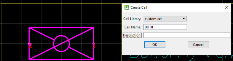

  9. Change the workflow to isometric now and click on Fence and select the new created symbol using Fence by Block.

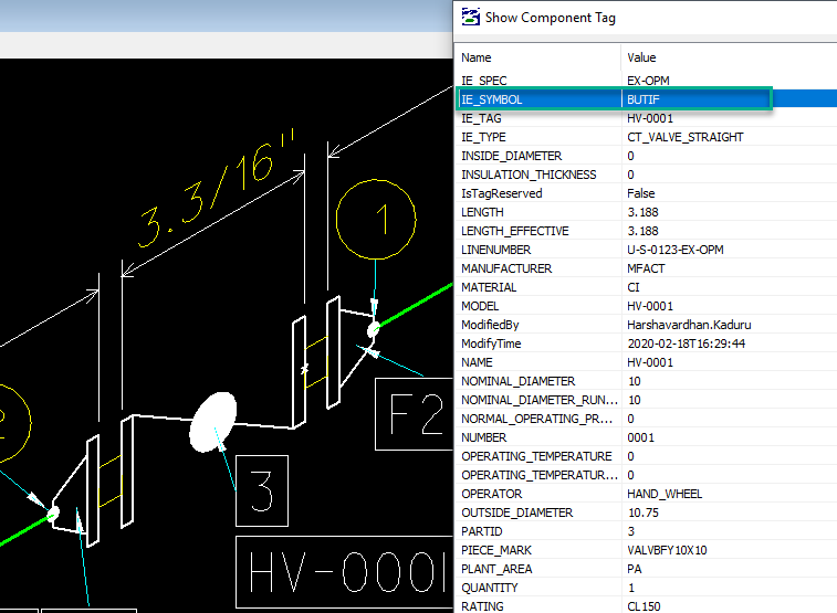

  10. Once the Symbol is fenced, click on Create Cell option and provide the Cell Name as “BUTIF” and Hit OK.
    NOTE: The reason for giving Cell name as BUTIF because of IE_SYMBOL in isometric drawing is "BUTIF" (check step 1 image). We can also see the IE_SYMBOL by hovering over the valve generated in isometric drawing.
