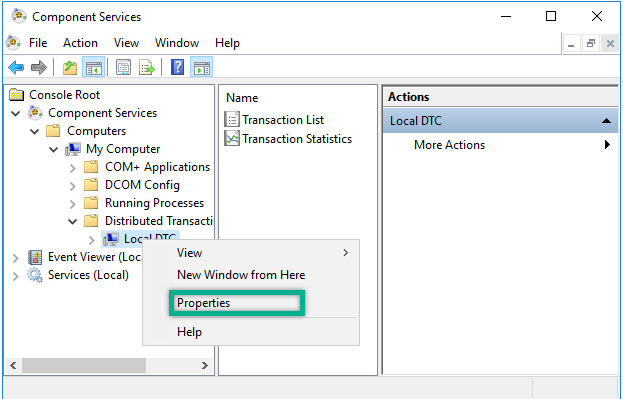

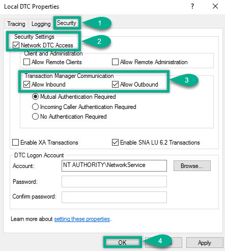

Microsoft Distributed Transaction Coordinator (MS DTC)
The following steps must be done at both the Master server and Remote server.

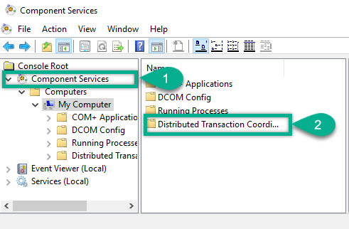

  1. Launch Control Panel > Administrative Tools > Component Services.
  2. From the Component Services dialog:
    a. Expand Component Services > Computers > My Computer > Distributed Transaction Coordinator.
    b. Right-Click on Local DTC.
    c. Select Properties.
  3. From the Local DTC Properties dialog:
    a. Select the Security tab.
    b. Enable Network DTC Access.
    c.
    Enable Allow Inbound.
    d. Enable Allow Outbound.
    e. Click Ok.

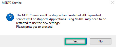

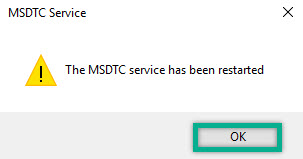

  4. From the MSDTC Service dialog:
    a. Click Yes.
  5. From the MSDTC Service dialog:
    a. Click

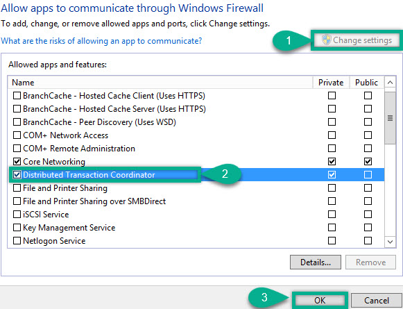

Microsoft Distributed Transaction coordinator Firewall Settings:
  1.   Launch Control Panel > Windows Firewall.
  2. From the Windows Firewall dialog:
    a. Click Allow an app or feature through Windows Firewall.
  3. From the Allowed Programs dialog:
    a. Enable Distributed Transaction Coordinator.
    b. Click Ok.
  4. Close the Windows Firewall dialog.

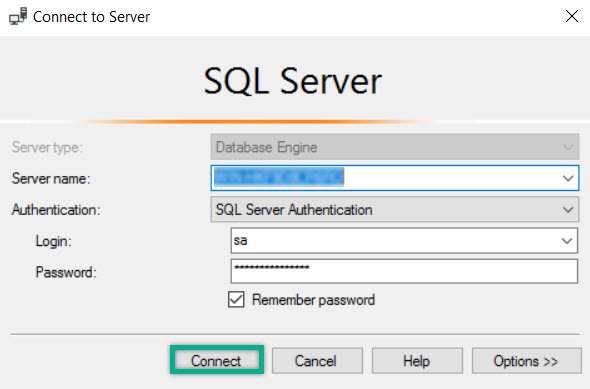

  2. From the Connect to Server dialog:
    a.  Server name - Select the Master server.
    b. Login - Use an account with SYSADMIN privileges.
    c. Click Connect.

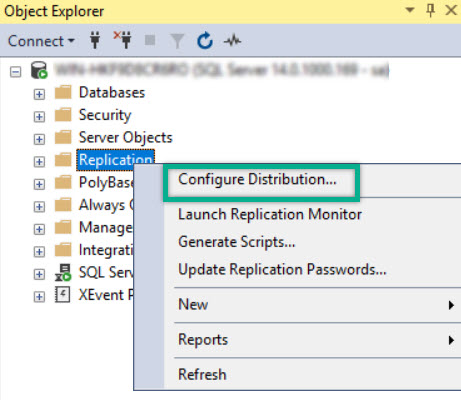

  3. From the Object Explorer pane:
    a. Right - click on Replication.
    b. Select Configure Distribution.

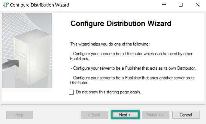

  4. From the Configure Distribution Wizard dialog:
    a. Click Next.

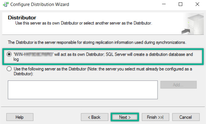

  5. From the Distributor dialog:
    a. Click Next.

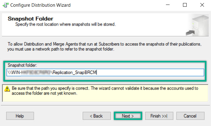

  7. From the Snapshot Folder dialog:
    a. Snapshot folder - Enter the path to a shared folder that can be accessed by the subscribers.
    b. Click Next.

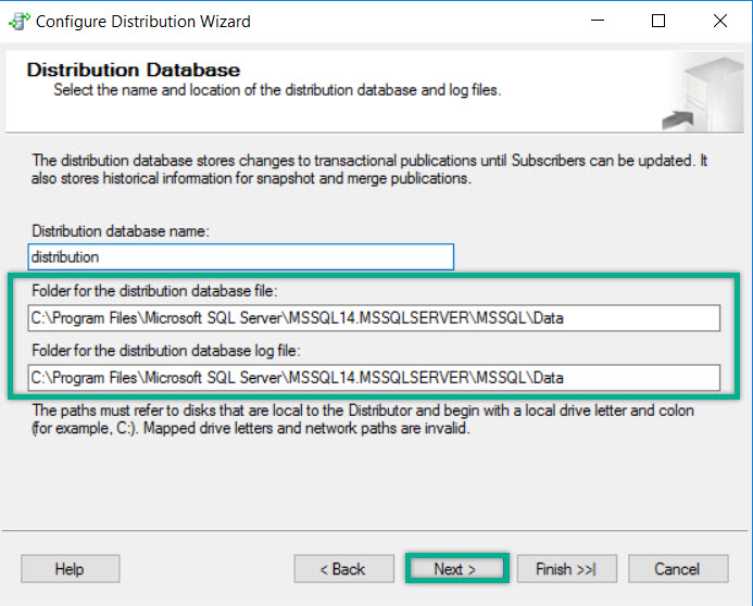

  8. From the Distribution Database dialog:
    a. Enter the name and location of the Distribution database.
    b. Click Next.

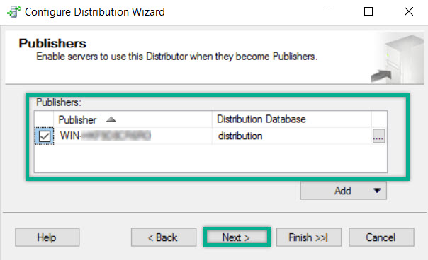

  9. From the Publishers dialog:
    a. Click Next.

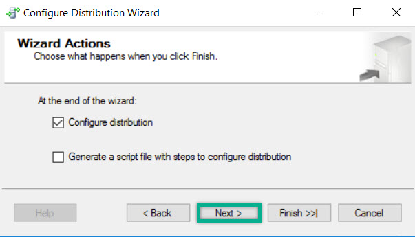

  10. From the Wizard Actions dialog:
    a. Click Next.

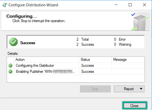

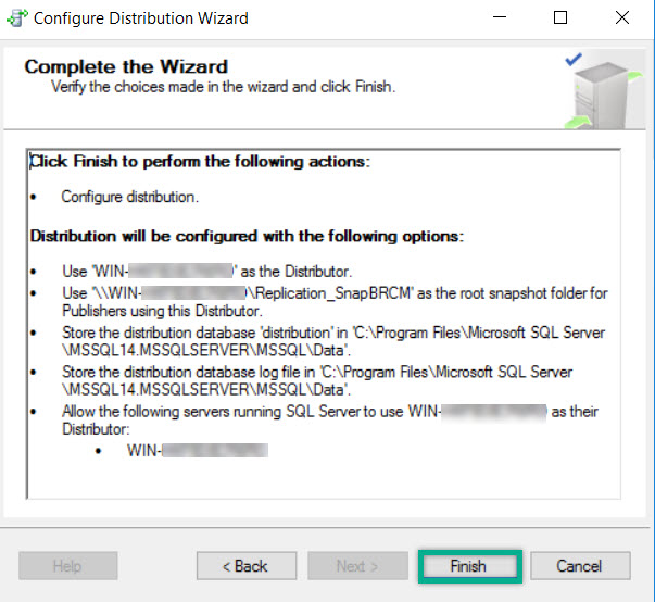

  11. From the Complete the Wizard dialog:
    a. Click Finish.
  12. From the Configuring dialog:
    a. Click Close.

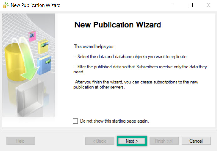

Configure the Publication on Master Server:

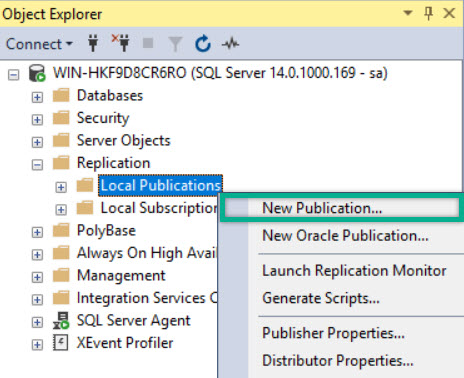

  1. From the Object Explorer pane:
    a. Expand Replication.
    b. Right-click on Local Publications.
    c. Select New Publication.
  2.  From the New Publication Wizard dialog:
    a. Click Next.

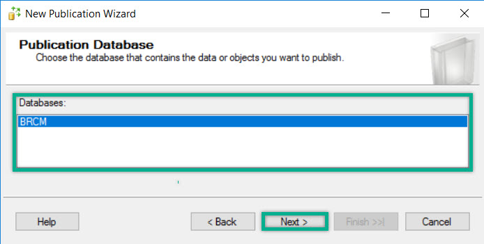

  3. From the Publication Database dialog:
    a. Select the database to publish.
    b. Click Next.

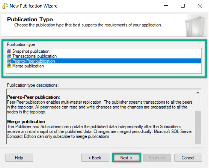

  4. From the Publication Type dialog:
    a. Select Peer-to-Peer publication.
    b. Click Next.

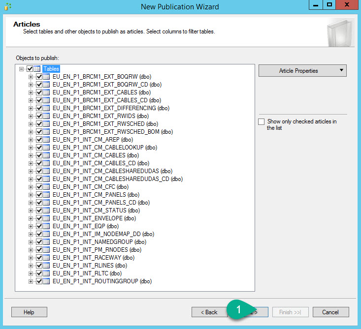

  5. From the Articles dialog:
    a. Enable Tables.
    b. Expand Tables.
    c. Select all tables.
    d. Click Next.

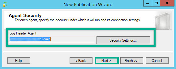

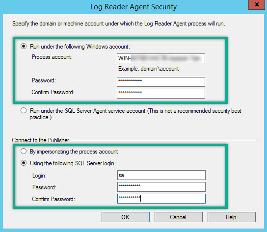

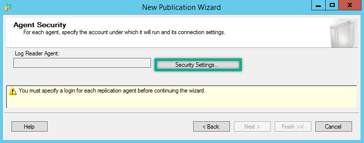

  6. From the Agent Security dialog:
    a. Log Reader Agent – Click Security Setting.
  7. From the Log Reader Agent Security dialog:
    a. Specify the accounts to run the Log Reader Agent.
    b. Click OK.
  8. From the Agent Security dialog:
    a. Click Next.

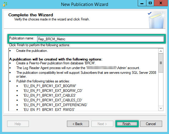

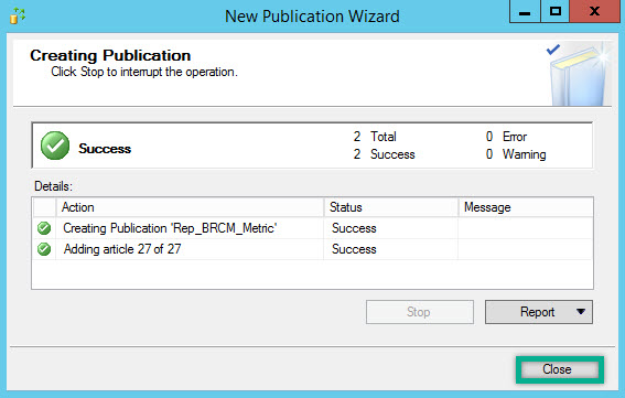

  10. From the Complete the Wizard dialog:
    a. Publication name – Enter a name for the publication.
    b. Click Finish.
  11. From the Creating Publication dialog:
    a. Click Close.

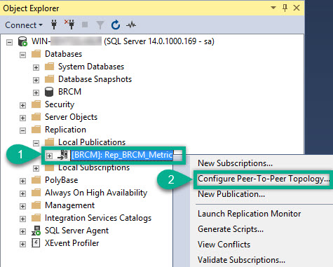

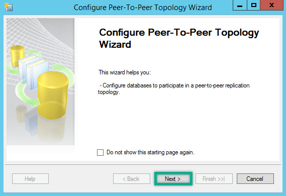

Configure Peer-To-Peer Topology:
    a. Expand Replication > Local Publications.
    b. Right-click on the Publication created in the previous section.
    c. Select Configure Peer-To-Peer Topology.

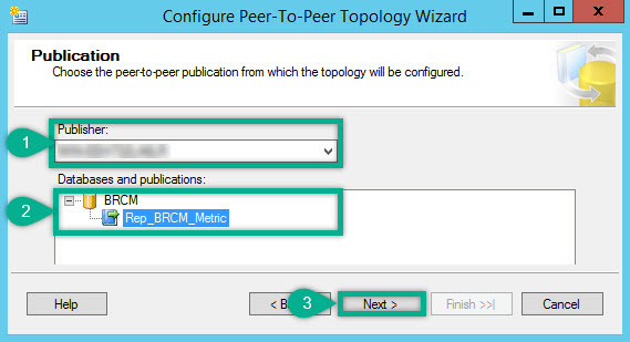

  2. From the Configure Peer-To-Peer Topology Wizard dialog:
    a. Click Next.
  3. From the Publication dialog:
    a. Select the Publisher.
    b. Select the Publication.
    c. Click Next.

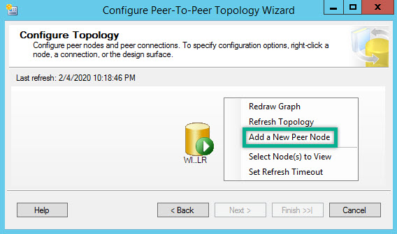

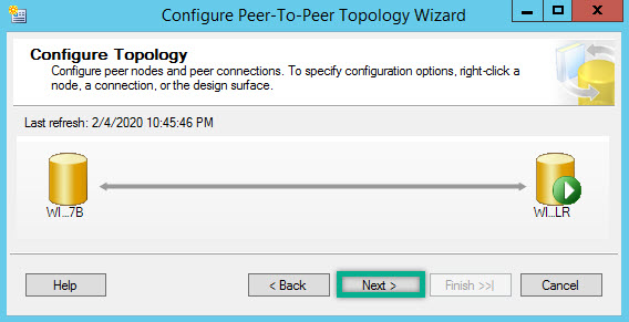

  4. From the Configure Topology dialog:|
    a. Right-click in the dialog.
    b. Select Add a New Peer Node.

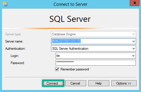

  5. From the Connect to Server dialog:
    a. Server name – Select the Remote server.
    b. Login – Use an account with SYSADMIN privileges.
    c. Click Connect.

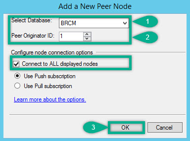

  6. From the Add a New Peer Node dialog:
    a. Select Database – Select the restored database.
    b. Peer Originator ID – Enter a unique ID for the node.
    c. Enable Connect to ALL displayed nodes.
    d. Select Use Push subscription.
    e. click Next.

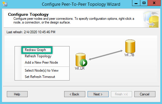

  7. From the Configure Topology dialog:
    b. Select Redraw Graph.
    c. Click Next.

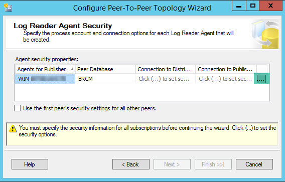

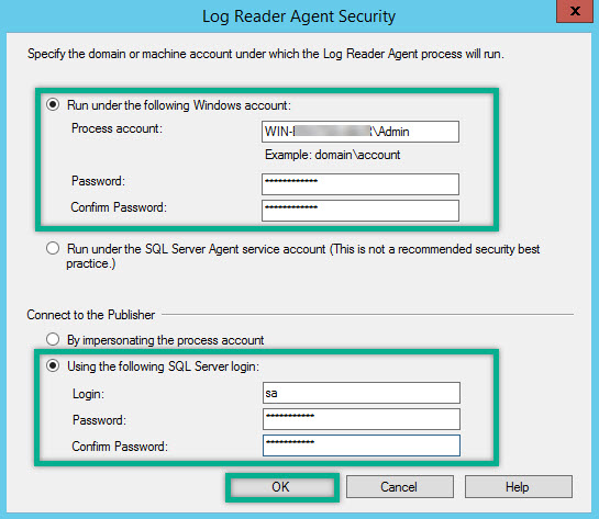

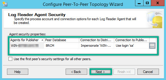

  8. From the Log Reader Agent Security dialog:
    a. Click the Browse button.
  9. From the Log Reader Agent Security dialog:
    b. Click OK.
  10. From the Log Reader Agent Security dialog:
    a. Click Next.

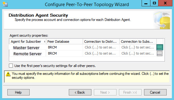

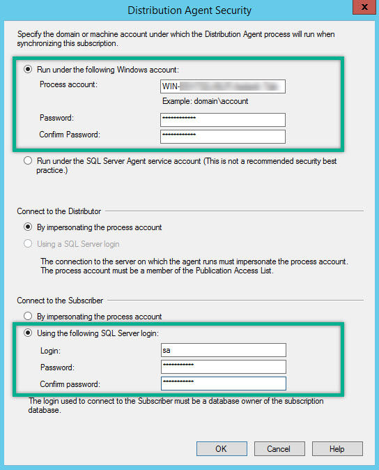

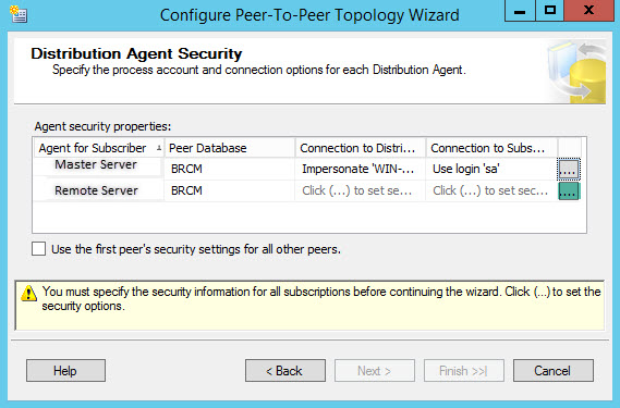

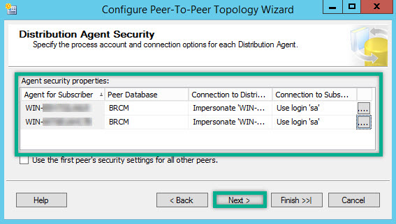

  11. From the Distribution Agent Security dialog:
    a. Click the Browse button for the Master Server.
  12. From the Distribution Agent Security dialog:
    a. Specify the accounts to run the Distribution Agent.
    b. Click OK.
  13. From the Distribution Agent Security dialog:
    a. Click the Browse button for the Remote Server.
  14. From the Distribution Agent Security dialog:
    b. Click OK.
  15. From the Distribution Agent Security dialog:
    a. Click Next.

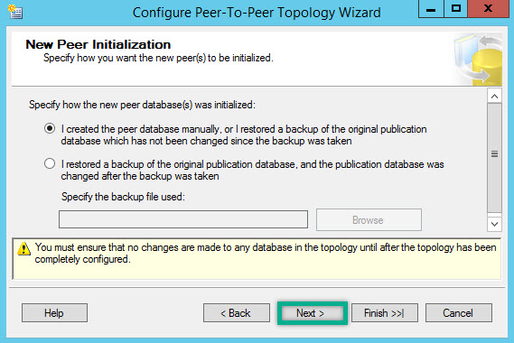

  16. From the New Peer Initialization dialog:
    a. Select I created the peer database manually.
    b. Click Next.

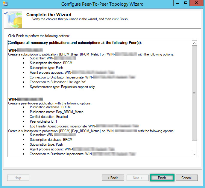

  17. From the Complete the Wizard dialog:
    a. Click Finish.
  18. From the Building the Peer-To-Peer Topology dialog:
    a. Click Close.

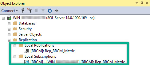

  19. After all the configuration in SQL server, the replication in SQL server will get displayed like shown in the image below.

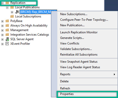

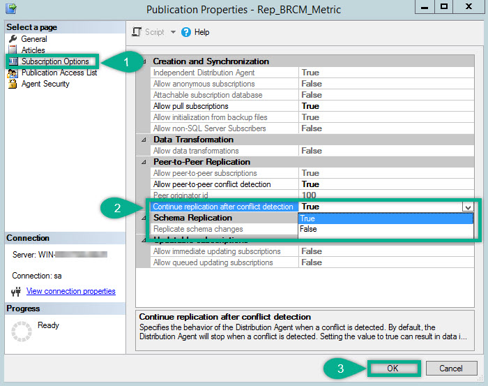

Configure Publication Properties for both Servers:
    b. Right-click on the Publication.
  2. From the Publication Properties dialog:
    a. Click Subscription Options.
    b. Set the value of Peer-to-Peer Replication > Continue replication after conflict detection to True.
